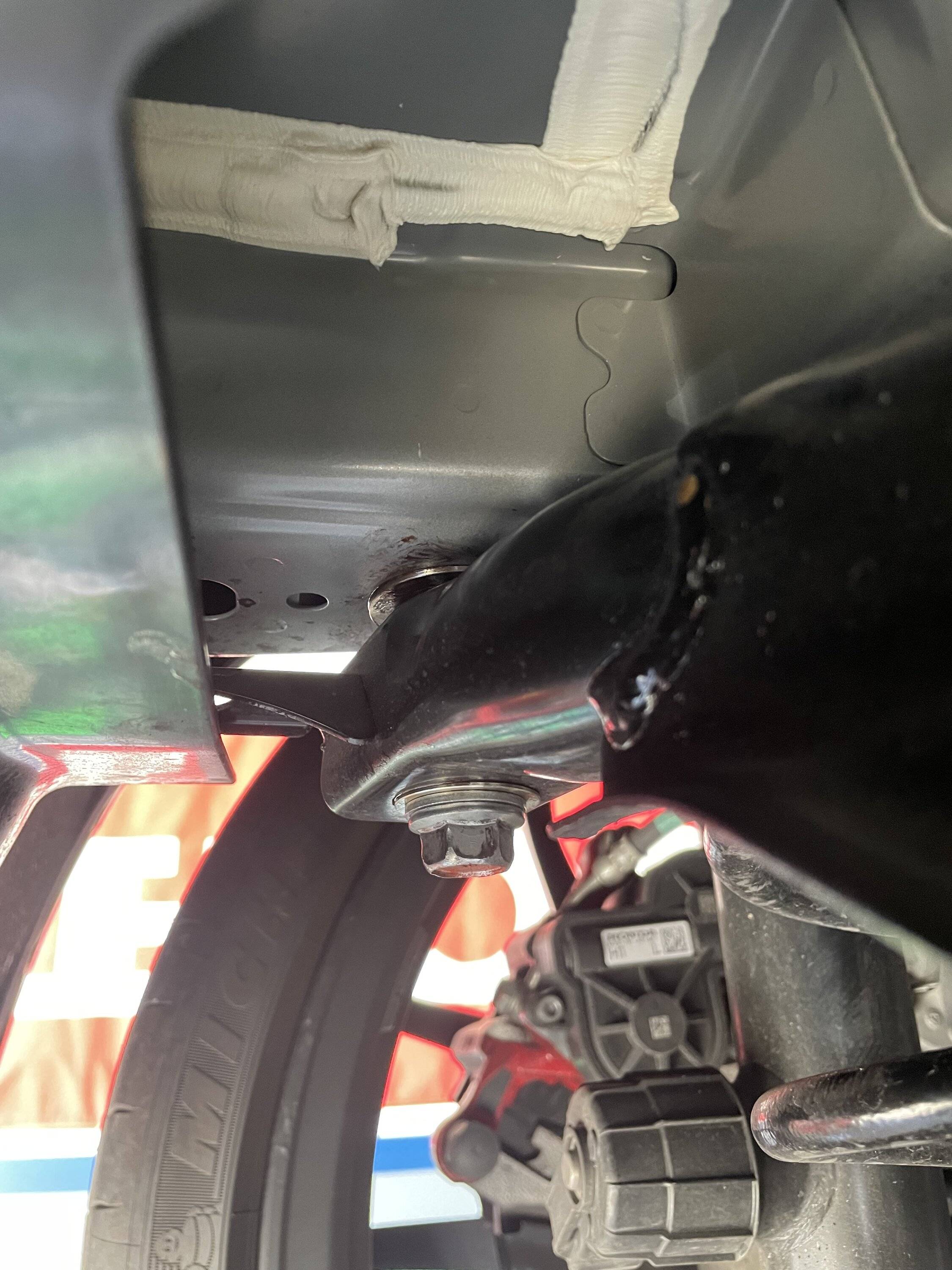

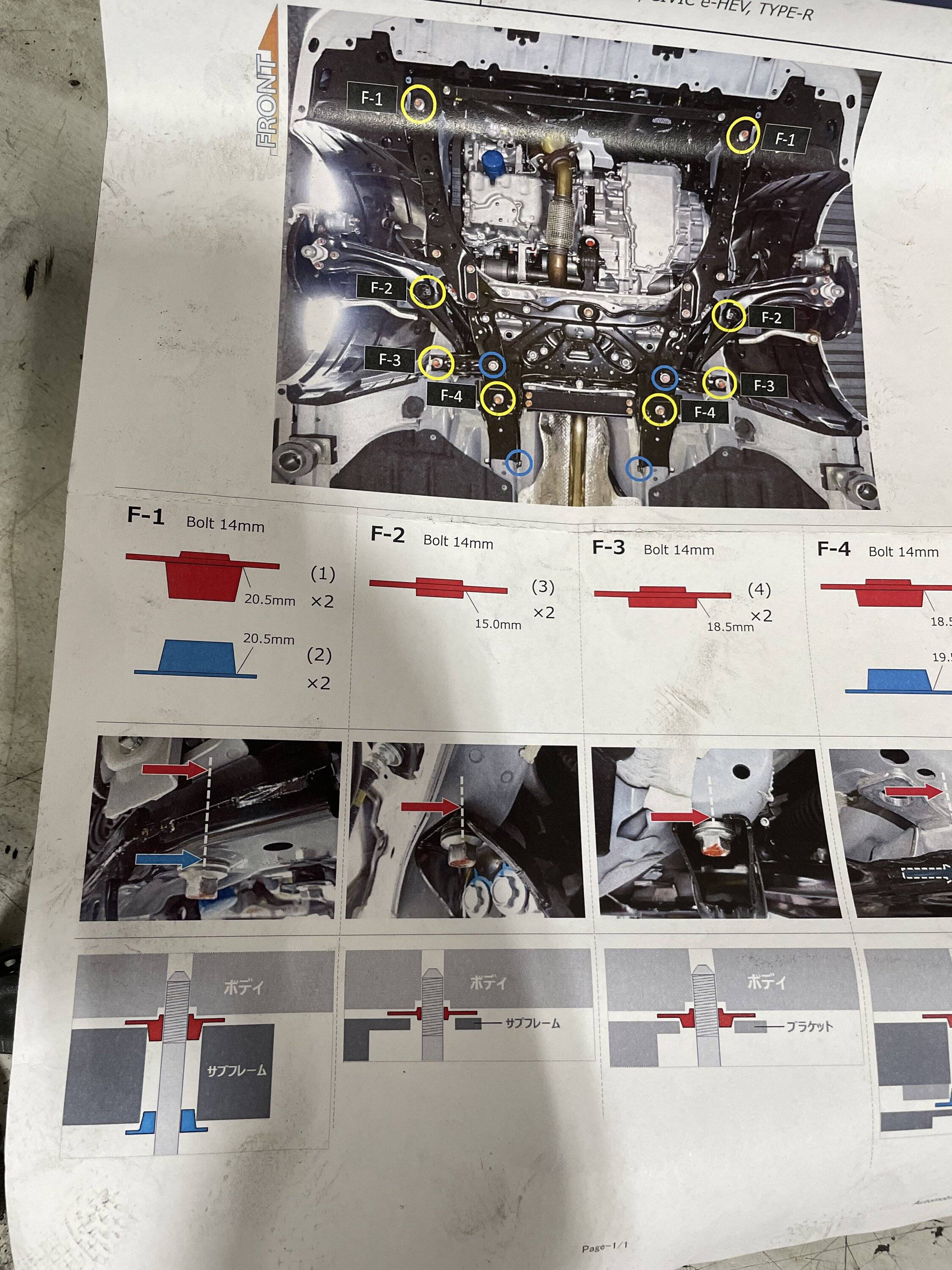

Only question I have now is durability and how long they last. Spoon talks about how they mold but dont crush. Last thing i need is for one to wear down and come off over time creating a much bigger issue. Similarly can the subframe and other connections to it hold up with the increased shock / force from the increases rigidity?
