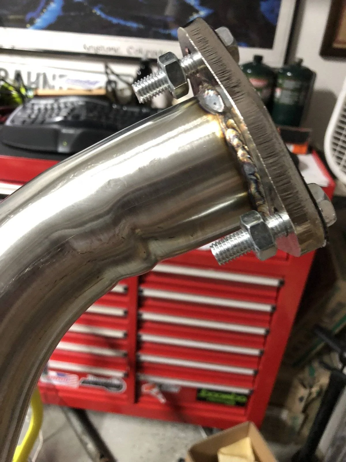

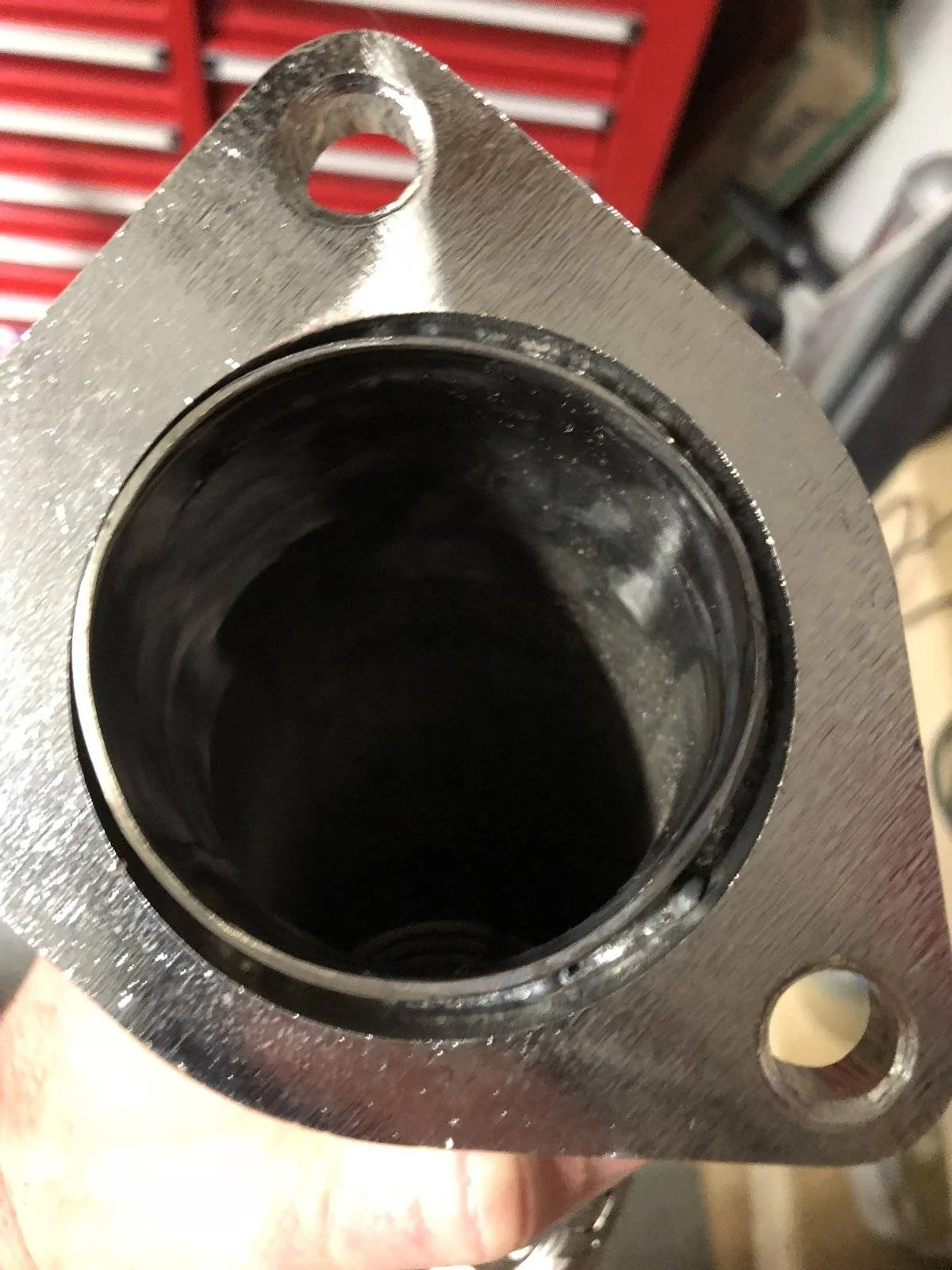

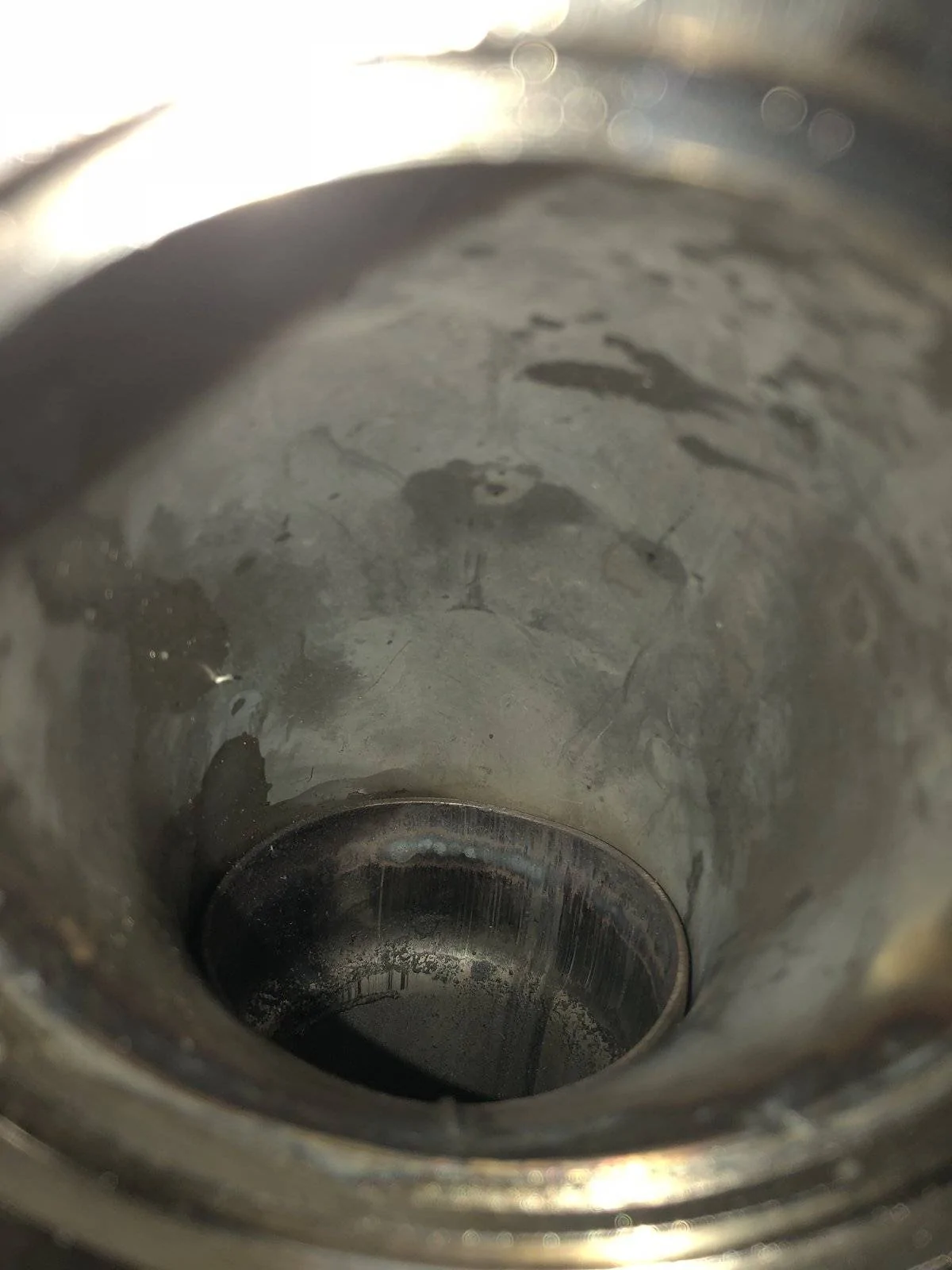

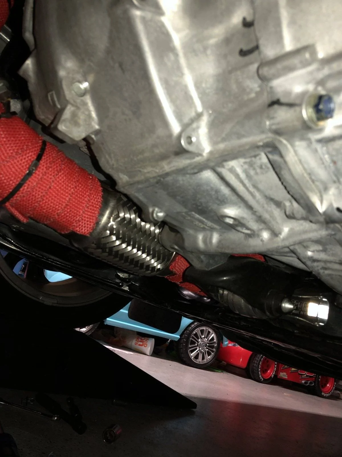

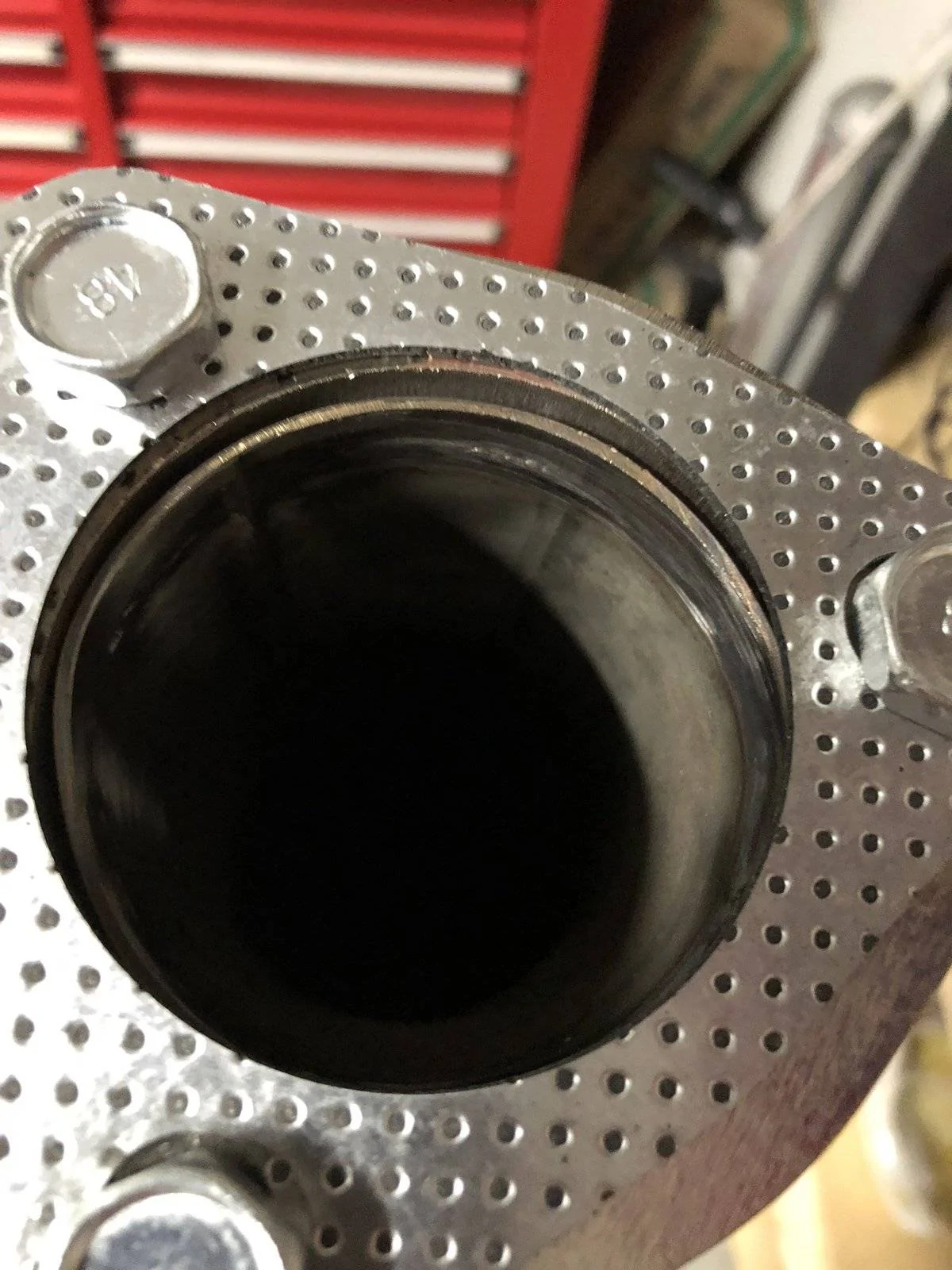

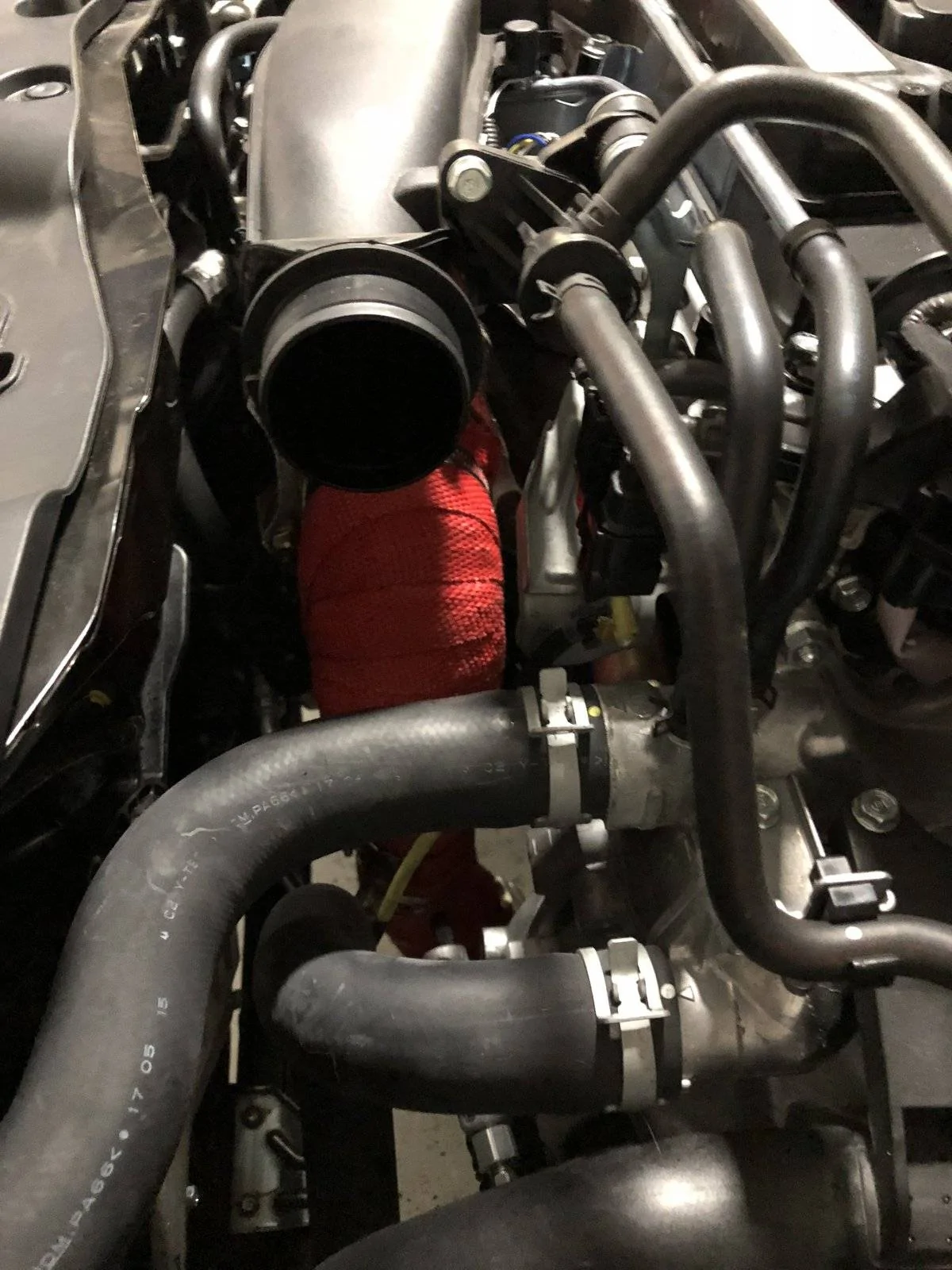

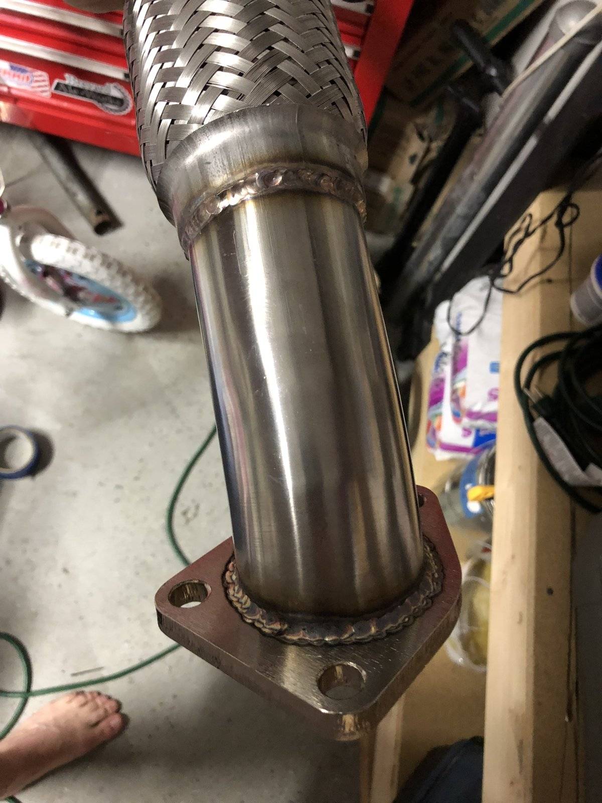

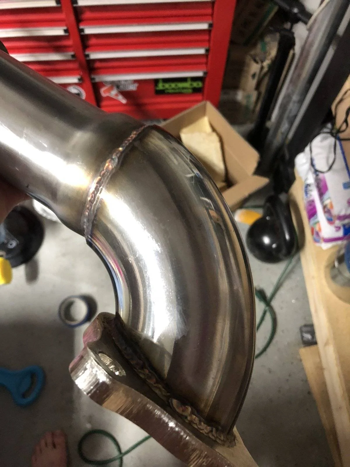

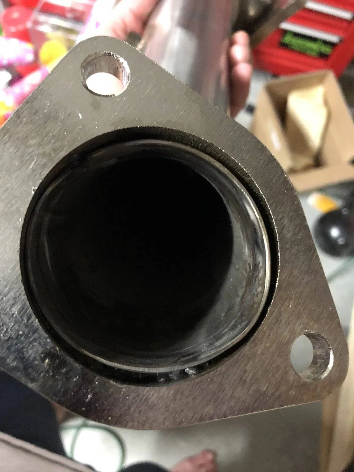

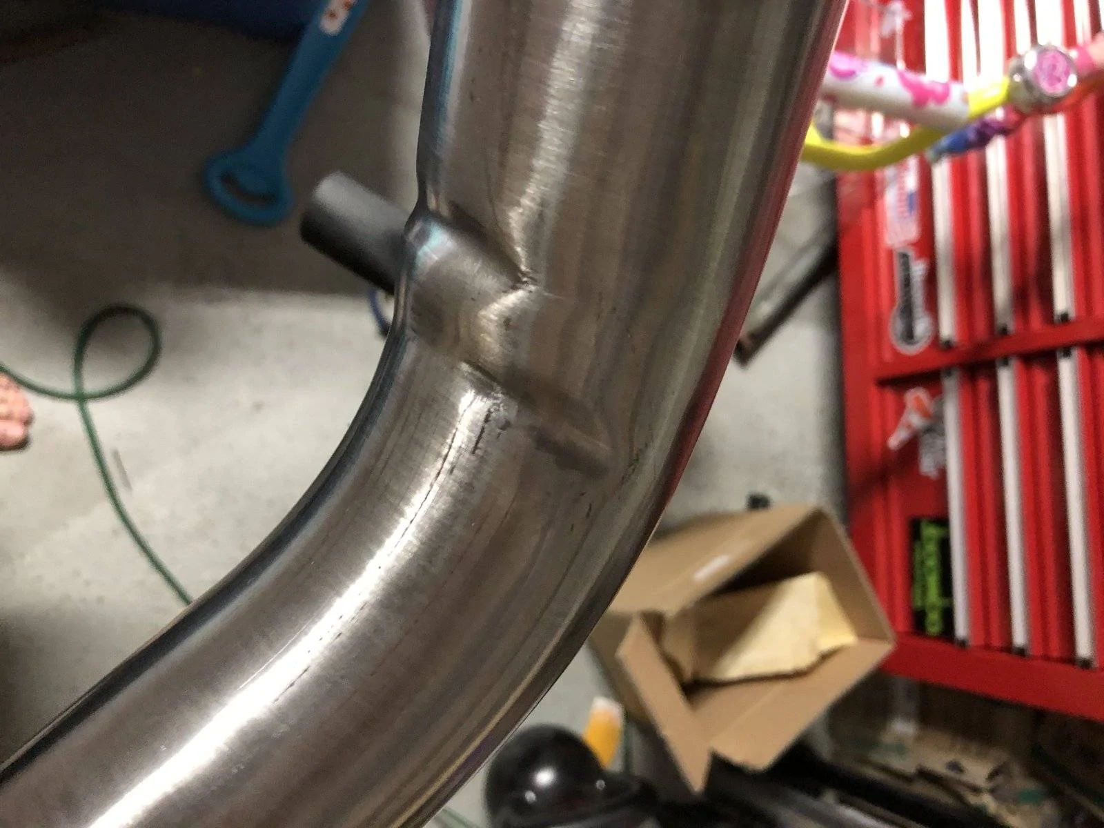

I have over 15k on mine with no issues, if anything the rasp was a bit too much for me initially, and I ended up throwing a 12" glasspack in front of my stock resonator, I actually ended up loving the sound but the cold start was waking my youngest child and my wife, with the 12" glasspack it's perfect for them and still loud enough for me:) I do have a rear heat shield vibrating and making noise now though so will be under the car again soon!
The overall quality of the welds is not the greatest but all have good penetration and has held up perfectly. I will run this till I do a turbo upgrade but with my amount of driving that will probably be 100-150k miles... I used an Ebay Coupon and the quality for 169 Shipped is Insanely good! I mentioned to others that have asked about this: it's 3" off the turbo and necks down to 2.5", the power will not be limited till around 400 fwhp from knowing flow and older turbo cars, it's STainless, the o2 screws right in- had problems with that in other downpipes in the past, I was able to get Downpipe, Frontpipe, KTuner, Stage 1 tune, AND, motor mount for less than most people spend for just the PRL DP/FP, it was a no brainer for me.
Found some old pics from initial opening and then after install - I wrapped mine as well...

Thanks for the video! A few of those welds have very poor penetration though, I'll probably just go with the PLM setup. Totally glad you posted those pics before I ordered lol
