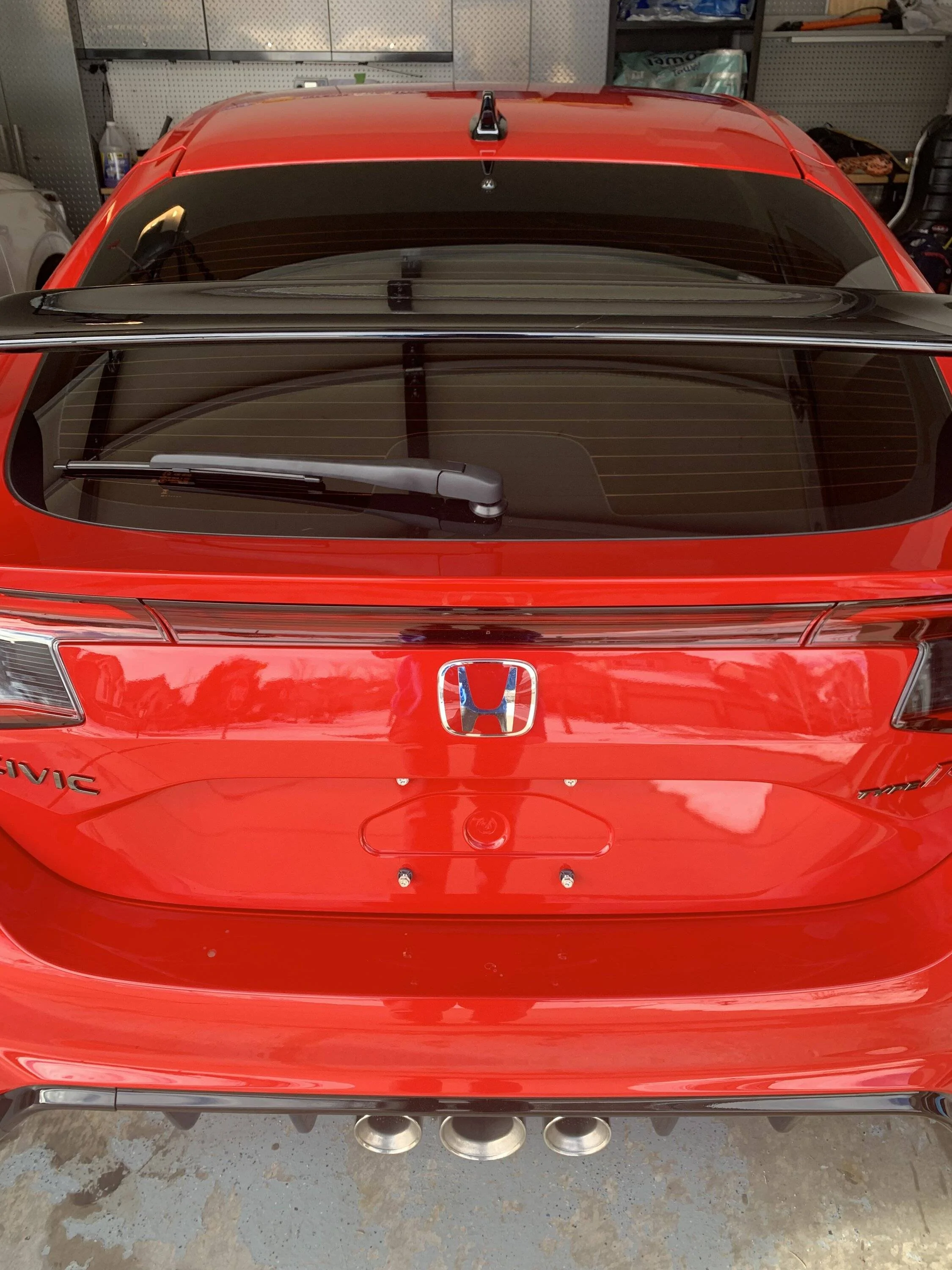

Hey guys. I got my FL5 back from the detailer and I tried to use my rear wiper. It went towards the bumper and not in the normal direction and got stuck behind the lip of the trunk. Has anyone experience this issue before and know how to correct it?

Looking at Tedward's video I think your rear wiper was installed 180 degrees off. Maybe due to the tint shop still as they had to take it apart from the inside. It should be facing to the left in the default orientation.

Yeah I see it in my original pictures.

They re installed the wiper backwards hope it didn't damage the paint

I was able to fix it. I just had to pop off the covering and unscrew a bolt to move it to the other side of the back windshield. No scratches or anything on the paint.
