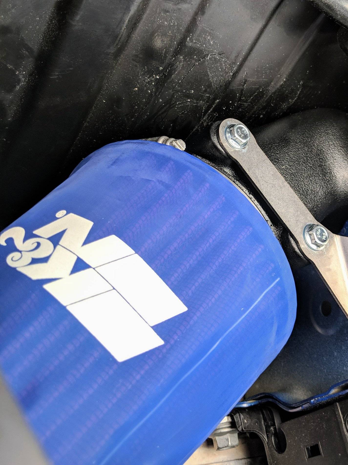

I'm in the Valley too and I bought this:
https://www.amazon.com/gp/product/B000E7BU5S/
I got blue since I have an Aegean blue Si
Do they make those for panel filters? The stage 1 is different from the Cobra, it's just a panel filter in the stock airbox with upgraded hose.

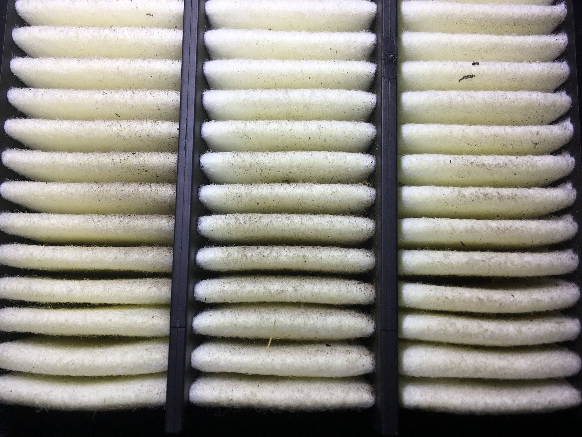

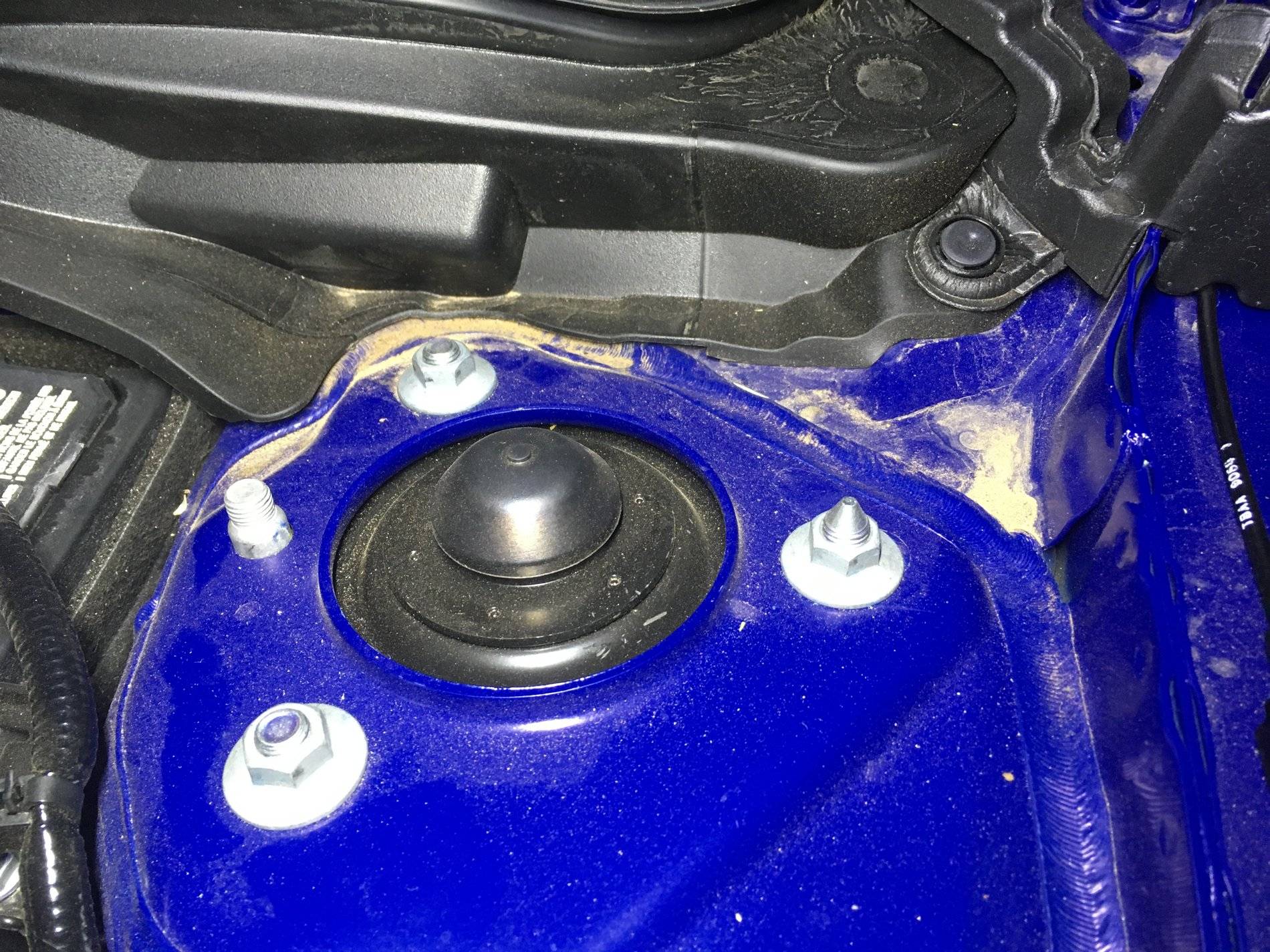

To give you an idea I am really really not BS'ing you about the dust bowl I live in, I see dust devils almost daily on my commute home from work, and this is what my strut tower looks after about 900 miles:
My filter sees plenty of it too:
Again, keep in mind this is with less than 1000 miles on the clock!!
The green filter is a really nicely made filter, don't get me wrong, but I just feel a little uneasy when I hold it up to the light and I can pretty clearly see light coming through. It passes a whole heck of a lot more light than the AEM or stock filter.
Ouch, that's definitely not good! :eek:

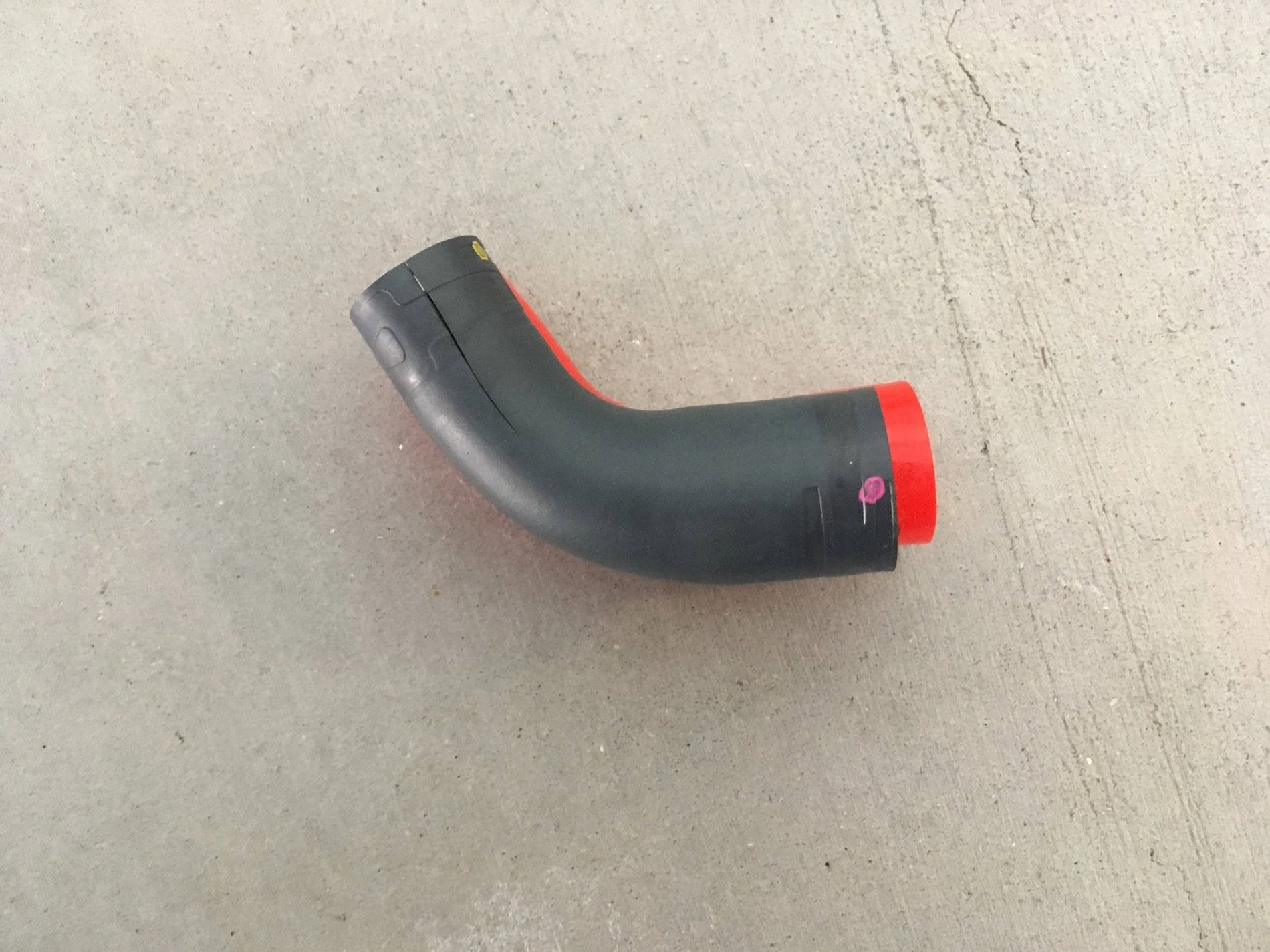

On a completely different note, are you aware that the stock breather hose on regular 1.5T and Si is actually slightly different? I went into some parts catalogs to verify and sure enough, it's true! Every other intake related hose has the same part number between 1.5T and Si, except for the breather:
11th Gen Honda Civic PRL Stage 1 (1.5T Si) question... IMG_2378
It's just a tiny trim on the inlet pipe side, but it threw me for a loop!
Where is that again? Mine doesn't look anything like that.
