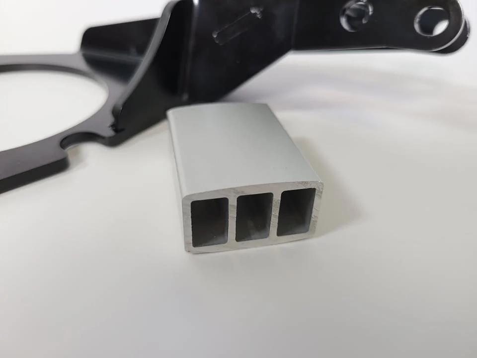

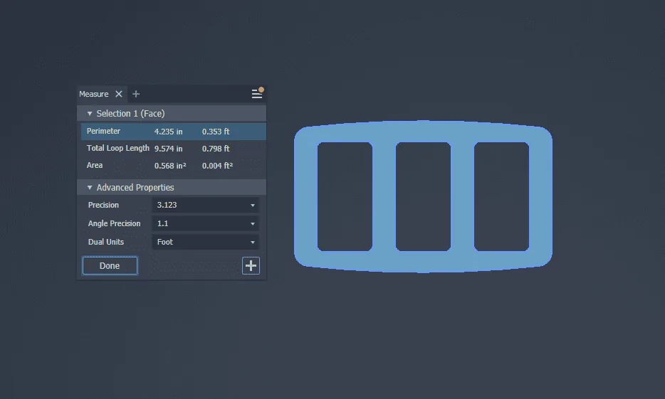

Shown above is the cross sectional pattern that performed the best and was decided on for our strut bar. Not only does this design mimic the design of the original strut bar offered on the DC2 ITR, but it also performed very well under stress due to its double I-beam design. Though this design is similar to the DC2 ITR, it is important to note that our design is significantly larger due to vehicle differences. I-beams are a very common cross section for structures due to their high strength-to-weight ratio. You can see I-beam cross sections anywhere from bridges and buildings to high performance connecting rods.

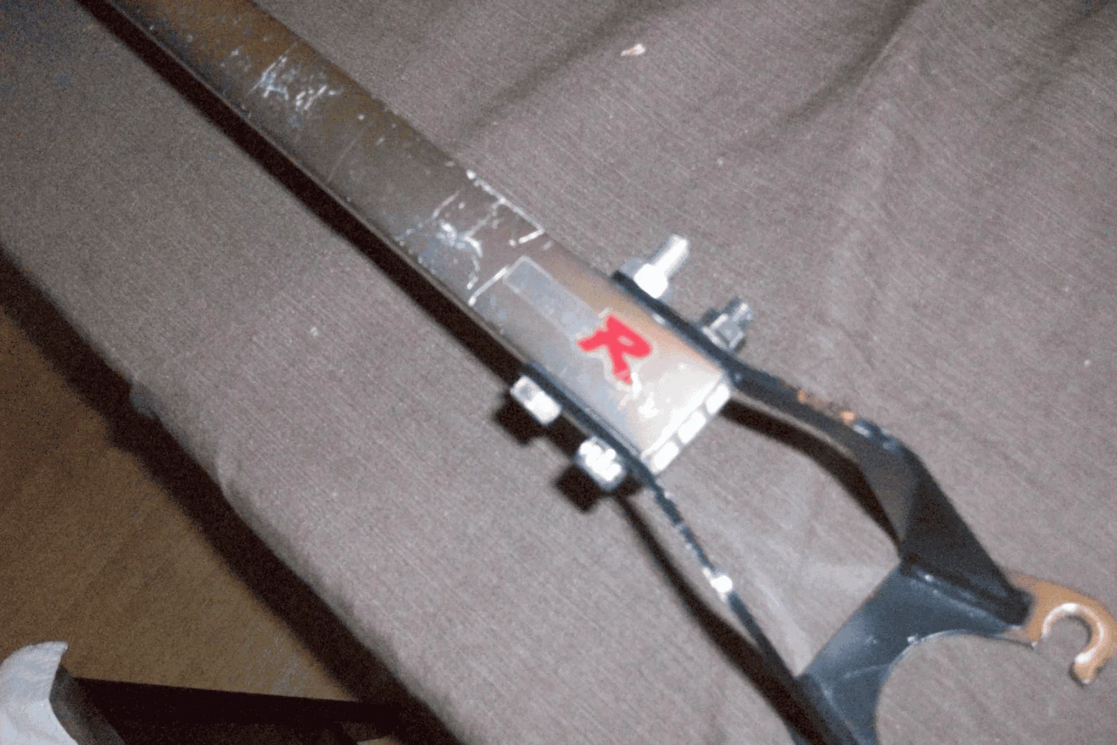

Original DC2 Type R Strut Bar Cross Section

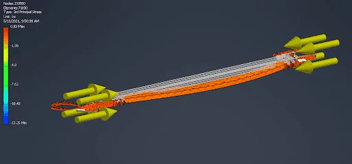

Shown below are the results from the stress analysis on each design. We can see that the loading causes the strut bar to deform downwards, in each case. We started the analysis with a solid cross section to use as a control. The solid cross section actually deformed significantly more than any of the other preliminary designs.
This table is a compilation of the initial conditions and the data received from the analysis of our design. The deflection result is the maximum deflection experienced by the bar, and the principal stress is the stress normal to the direction of the shear stress. In this case, the principal stress is essentially telling us how much stress is experienced in the direction of the loading.
| PRL CTR Strut Bar | |
| Cross Sectional Area (in2) | 0.5685 |
| Force Applied (lbf) | 590.2 |
| Resultant Load (psi) | 1038.2 |
| Deflection (in) | 0.001959 |
| Principal Stress (psi) | 830 |
