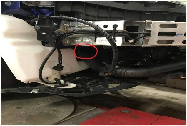

We do not think the 2.0 N/A reservoirs fits onto the 1.5T, but this is not 100% confirmed. You are probably correct with the intercooler piping interfering.
I can confirm the Canadian 2.0 tank doesn't fit. I just opened up my inner fender and its pretty easy to see the 2.0 tank needs to occupy the space where the intercooler piping runs. Since I've got both a us and ca tank here, I'll take a pic when I get the bumper off showing the difference.
