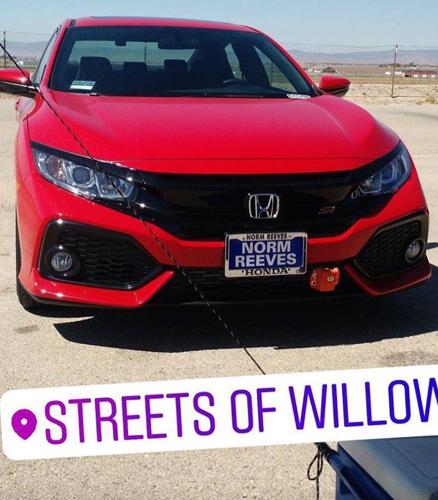

We just took our 17 Si to an Extreme Speed event this weekend at Willow Springs. A lot of fun and we learned quite a bit about how the car performs with and without a FlashPro tune. Overall, it was a blast and this new Si is pretty fast around the track! Outside temps were high (95 to 100 F) and I imagine during the winter time it will perform even better.

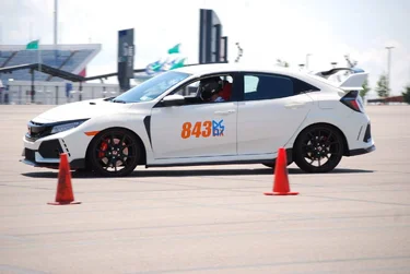

Hello everyone!! Back here again with some promising data!!! My previous post was on my general knowledge of racing and tires! now I have proof!
I did my first autocross in the Type R.. and boy are we lucky to own one because that car is quite insane!!
11th Gen Honda Civic Primer: Hitting the track in your Civic! IMG_7075.PNG
These are the results from yesterday's event! (names crossed out for privacy reasons)
Sitting in 8th place due to crappy morning runs, and lack of overall course knowledge is me in my silly Type R..
Yes it is bone stock with conti 6 tires. Being an avid autocross racer I have to say the conti 6 tires held up just fine! No issues with getting heat in them, I actually over heated them and had them probably sitting around 175 degrees on the hottest lap. all the cars above are class set up for street. So you're looking at aftermarket wheels and tires like Enkei rpf1 Re-71r/Rival 1.5s, Sway bars, exhausts, shocks, bushing upgrades, you name it! the region is very competitive and based on the raw times shown you can see! my good friend in the RS who ran a similar 35.9 took the class championship for our region so you know he means business (also running on wheels and tires, 71r)
About the car!.. I had bumped up the pressures to a 38psi cold! which means it was sitting around 43ish... roughly hot! which I felt was a good starting point. 38/38 FR. Car was driven with Traction Control/Stability control off and in +R mode, Launched at around 2,500 to 3,000 rpm while letting the clutch slip because that 23 psi of boost builds very quickly and can overwhelm the front tires with power before you know it!
As we have discussed in the thread the car was classed in B street, the region offered me D street but I laughed in their face a little and told them "i want to give others a chance". The SCCA has no official class for it yet so technically permitting national rules it would be an SS class car, it is tough to say 100% if B street is going to be the official class, we had a pro solo and solo nats trophy winner at the event in an RS who put a 34.8 down so about a second faster (fully prepped autocross B street car).
The course was very left turn oriented, so the left front saw much more abuse on than the right but ultimately no major damage was done on the tires, i feel the wearability was just fine, I drove a total of 125 miles, plus the 6 laps at the event, the tires were managed very well all thanks to the super computer that is wired to the whole car!!
So if you are wondering aside from all the suspension geometry magic, and sticky tire combo, How does the Type R turn such fast lap times? The steering feel in +R is very direct, and I discovered on course that you never actually get full electronic traction control off! but it will turn the Vehicle stability control off. The type R uses the mechanical front diff and the giant brembos to effectually put all 300+hp to the ground. combining the torque vectoring through braking, it allows the type R to keep more effective use of the Helical LSD. Thus preventing the inside tire from spinning under power, typically I would left foot brake in my 9th gen si, but the type R does it more effectively and faster than I ever could! This essentially allows you to get back to throttle sooner, and the steering doesn't get away from you due to the low scrub radius. In all I took a 2017 Civic Type R on stock tires and battled against Focus RS's, Mazda Miata's and Rx8's and the famous Mini Coopers (which have insane pax) all running on the best autocross tires, and placed 8th out of 25 in Street class with a PAX time of 29.409 and that miata coming in at 28.525. I never understood what the "Fastest FWD production car" meant until I autoX'd my CTR. For those in the future looking to be competitive in the car, a nice titanium exhaust, and wheels will easily shave 30lbs off the car. I think a larger rear sway bar with some range of adjustment maybe give the type R a bit more of a competitive edge but in all I am very impressed with what a bone stock ctr can do!
