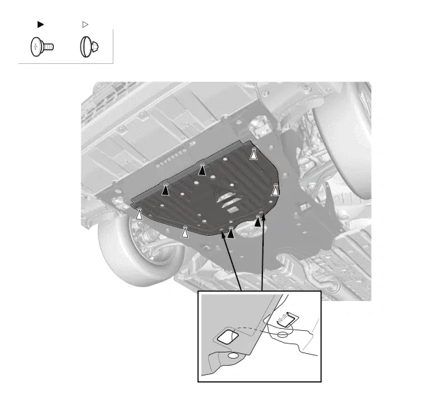

First, take off the splash shield.
You'll need a #3 Phillips (Yes a #3) and a flathead.

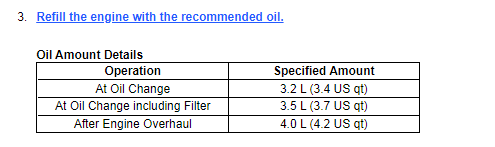

For the 2.0L, you'll fill 4.4 US quarts:
11th Gen Honda Civic Oil Change Service Official DIY Instructions for 2022 Civic 1.5L and 2.0L 1641582147133
For the 1.5L, you'll fill 3.7 US quarts.

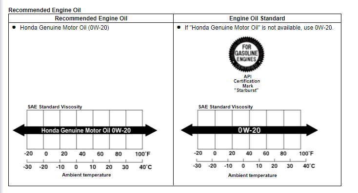

Honda says 0W-20 for both 2.0L and 1.5L

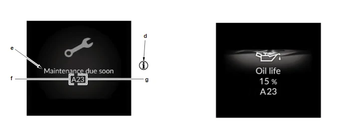

Maintenance Minder will tell you when it’s time to change the oil depending on how it’s driven. For mostly freeway driving on my 10th gen, it was roughly 10k for engine oil and 50k for CVT

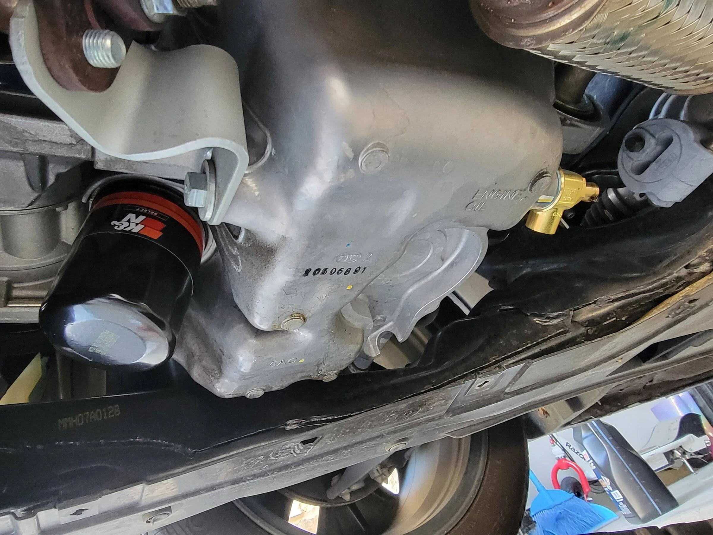

你推薦使用 Fumoto 排水閥嗎?

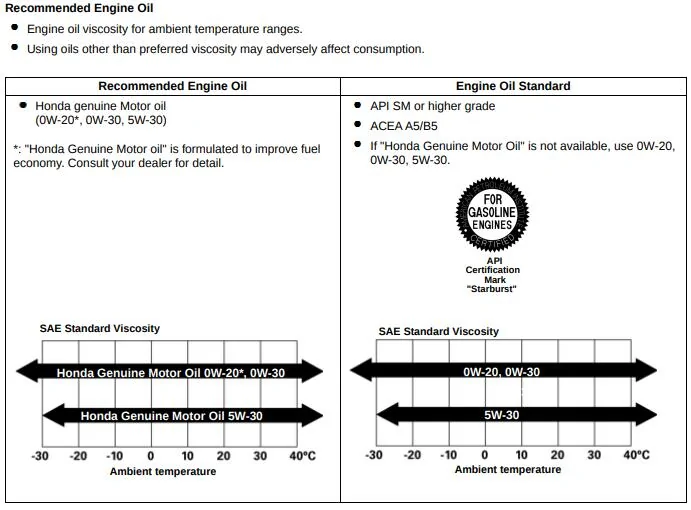

What is the best oil for the Type R 2.0L motor?
I see 0w20 is the preferred viscosity with an API standard of SM or higher
11th Gen Honda Civic Oil Change Service Official DIY Instructions for 2022 Civic 1.5L and 2.0L 1725911629856-4h
I use Mobil 1 in some of my cars, wondering what others are using?

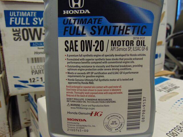

I found this Honda Full Synthetic but I would like to put the best oil I can in my FL5 and I don't know if this is it or not >>>
Genuine HONDA Ultimate Full Synthetic (0W 20) motor oil - Honda (08798-9137)

I use many different synthetic oil brand bought at discount sales in my store, never Honda oil, it is too expensive, it is a wast of money imo.
Most important is to change oil more often. Around 20% maintenance minder

On a new Honda, I wait around 15% or 10% (maintenace minder) before changing the oil.
I then change it at around 20%.
There is no disadvantage to changing the oil AND the filter more often, except in terms of money.
