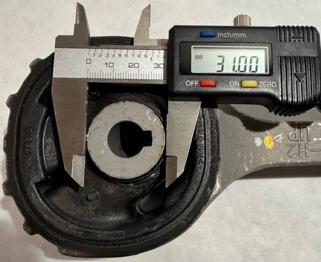

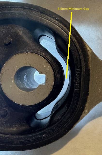

Using tried and true urethane injection to simply fill the cavities in the OEM RMM:

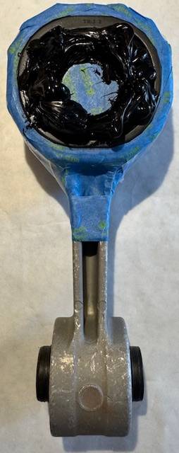

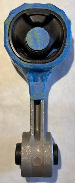

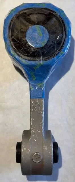

Remove the stock insert and clean the RMM with dish detergent and a brush. Once completely dry, tape off areas on both sides where you do not want the urethane to be applied.

Apply clear packaging tape to seal off the other side to prevent the injected urethane from pushing out:

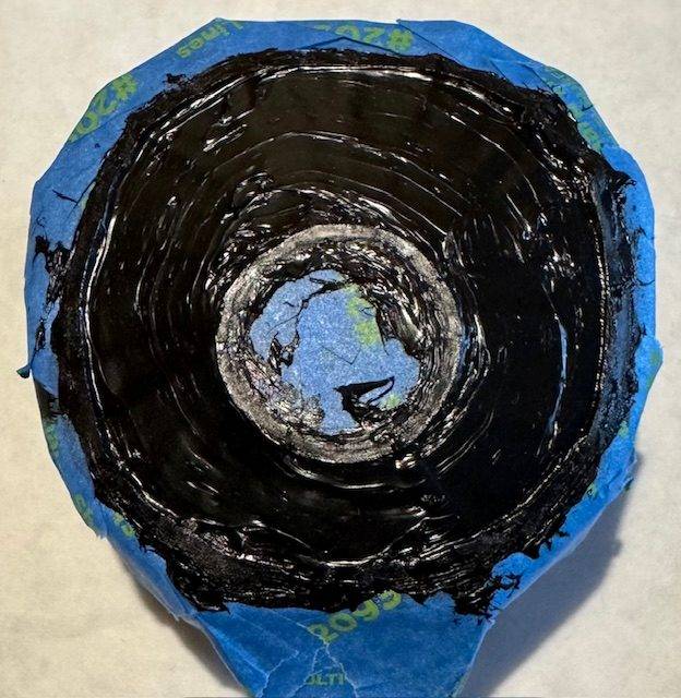

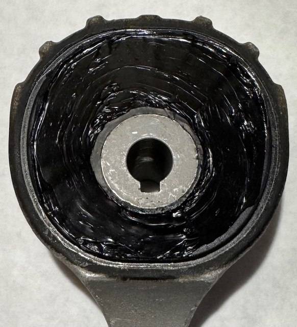

Put some gloves on and be careful when injecting the 3M Windo-weld. Whatever it comes into contact with will not be easy to remove. Flip the part over and inject urethane into the cavities on the other side.
11th Gen Honda Civic OEM FL5 RMM Measurements and Urethane Injection 1745794629491-bk

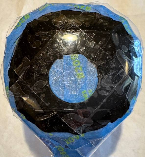

Flip the part over and verify that the urethane completely fills against the clear tape:
11th Gen Honda Civic OEM FL5 RMM Measurements and Urethane Injection 1745794987396-a8
Once verified, you can use a popsicle stick on the other side to smooth the surface of the urethane:
11th Gen Honda Civic OEM FL5 RMM Measurements and Urethane Injection 1745795281527-rb
Let the part sit for at least 24 hours for the surface area of the urethane exposed to the air to cure. Urethane on the other side will remain wet as it is protected by the packaging tape. Tomorrow, I'll post an update on the next steps.

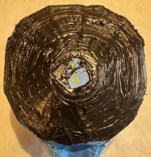

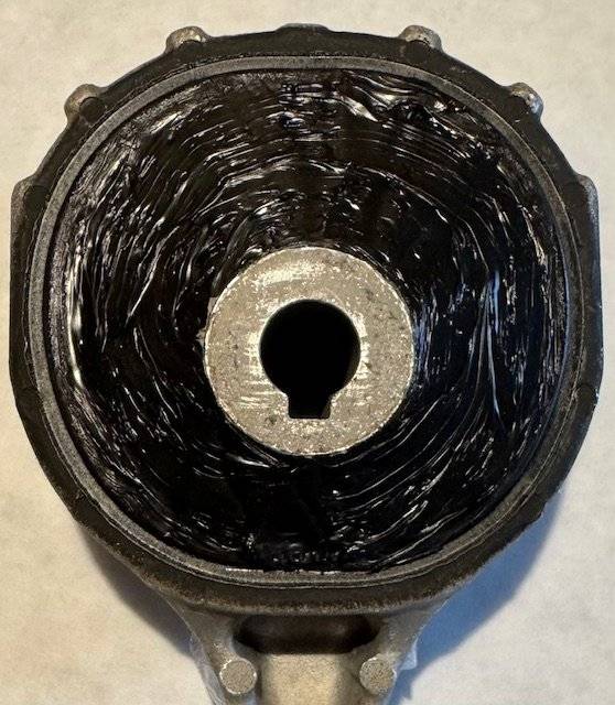

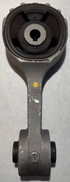

Next day and more PICs. Remove the tape on the side where the urethane has cured:
11th Gen Honda Civic OEM FL5 RMM Measurements and Urethane Injection 1745876628638-rk
The urethane is very sticky so you are not going to get a buttery smooth surface. It is however flat and uniform without any air bubbles in it:
11th Gen Honda Civic OEM FL5 RMM Measurements and Urethane Injection 1745877243254-q6

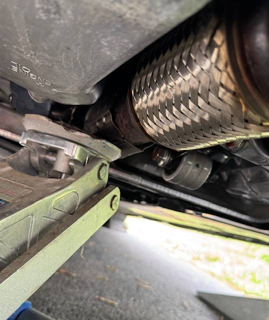

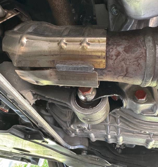

I installed the injected RMM (a.k.a., torque rod). If you don't have a crows foot to torque the horizontal 19mm bolt when reinstalling, you can simply mark it to serve as a reference point prior to removal.
11th Gen Honda Civic OEM FL5 RMM Measurements and Urethane Injection 1746303038207-zf
To remove the horizontal 19mm bolt, I found it easier to simply use a jack to push up on the rear of the front pipe to gain clearance. Old RMM removed and injected one installed. The vertical 17mm and horizontal 19mm bolts should be torqued to 69 ft lbs.
11th Gen Honda Civic OEM FL5 RMM Measurements and Urethane Injection 1746303295281-sv

Overall, I believe this is the best bang for the buck. Aftermarket inserts do not fill all of the voids in the OEM RMM. Injecting with 3M Windo-weld maintains the OEM rubber while filling the cavities with a 55-60 Shore A urethane.
