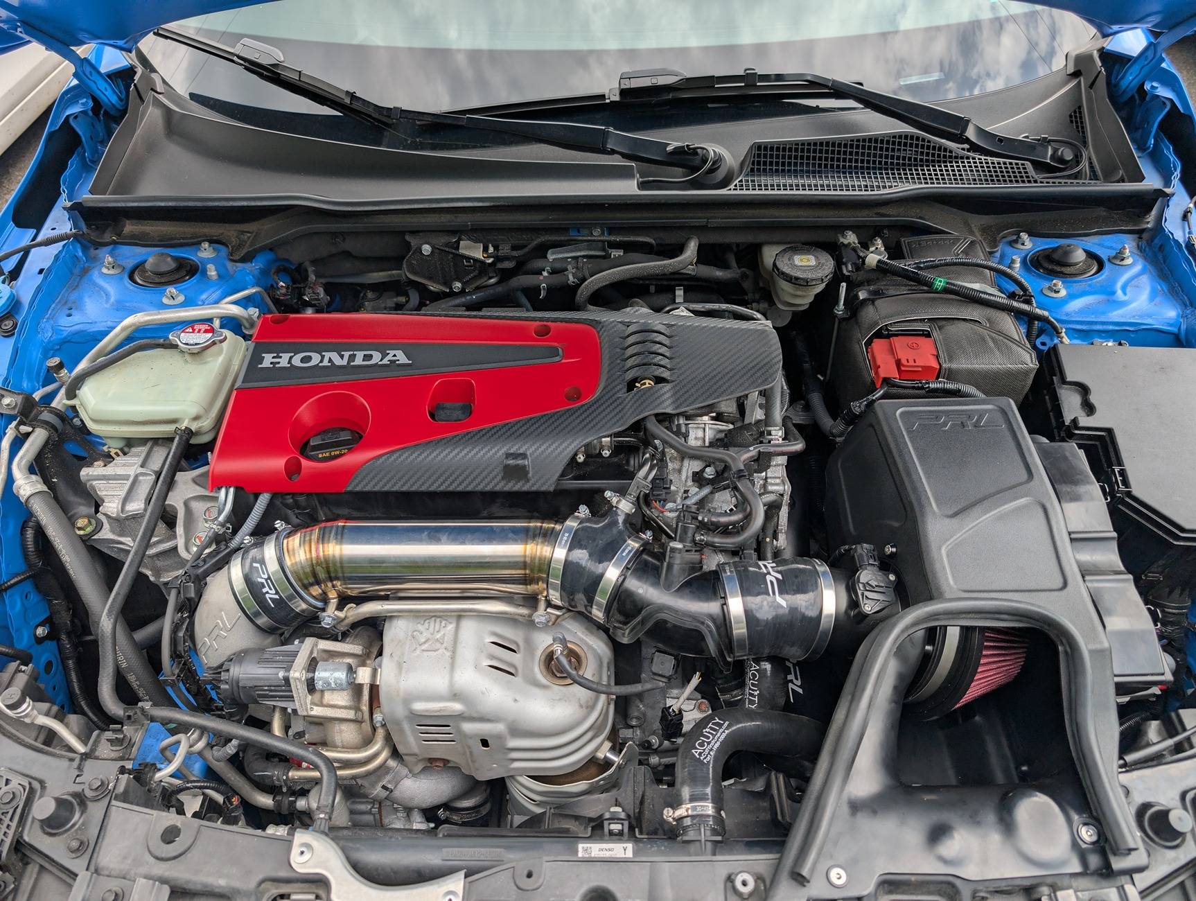

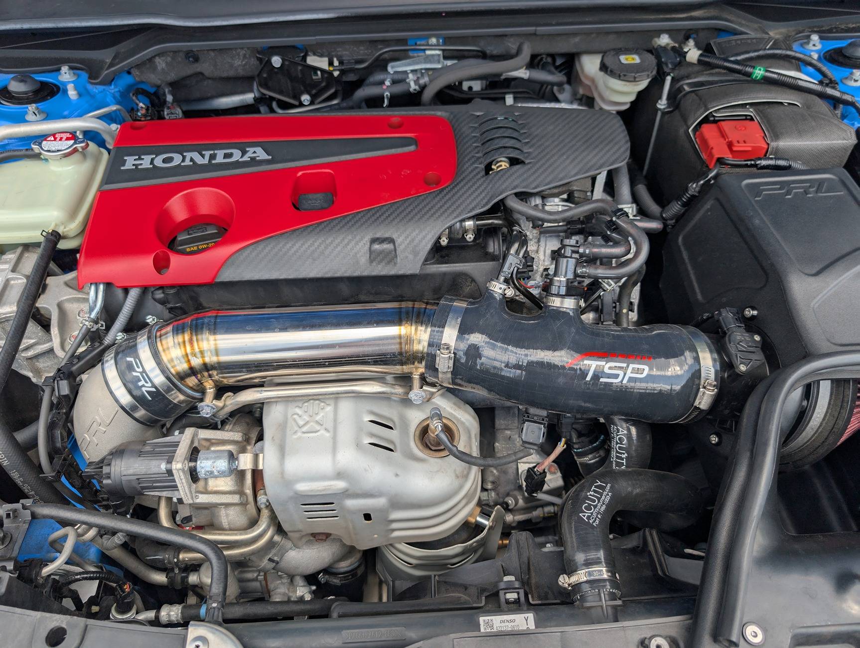

11th Gen Honda Civic Necro's FL5 {Rem} Build Page (Ongoing) Engin Bay as of 6_3_2025
Engine bay post mods, current 6/3/2025

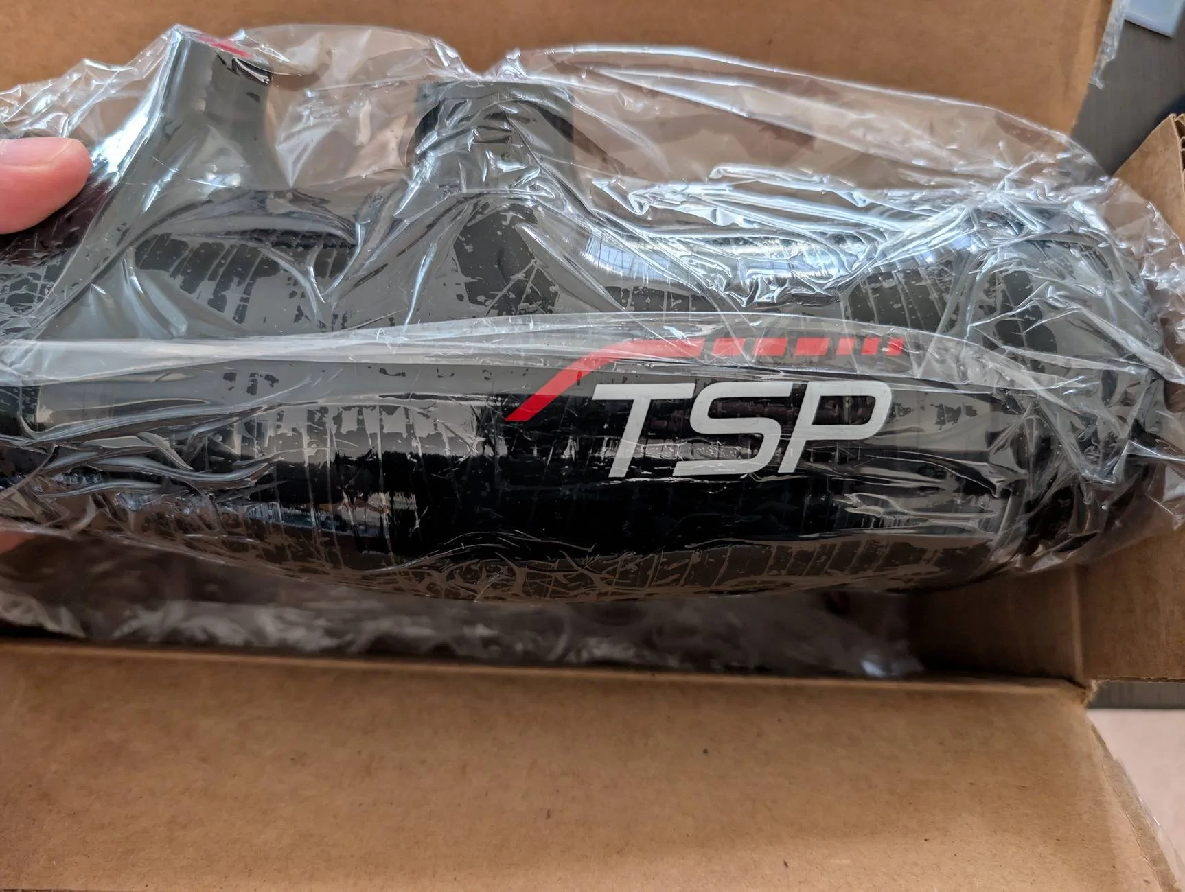

Small Update - (Installation of the TSP: HVI -> Inlet Pipe)
So, I recently went and grabbed the @Two Step Performance HVI to Inlet Silicone pipe upgrade.
This replaces the PRL Silicones as well as the ugly (in my opinion) plastic elbow that is left behind.

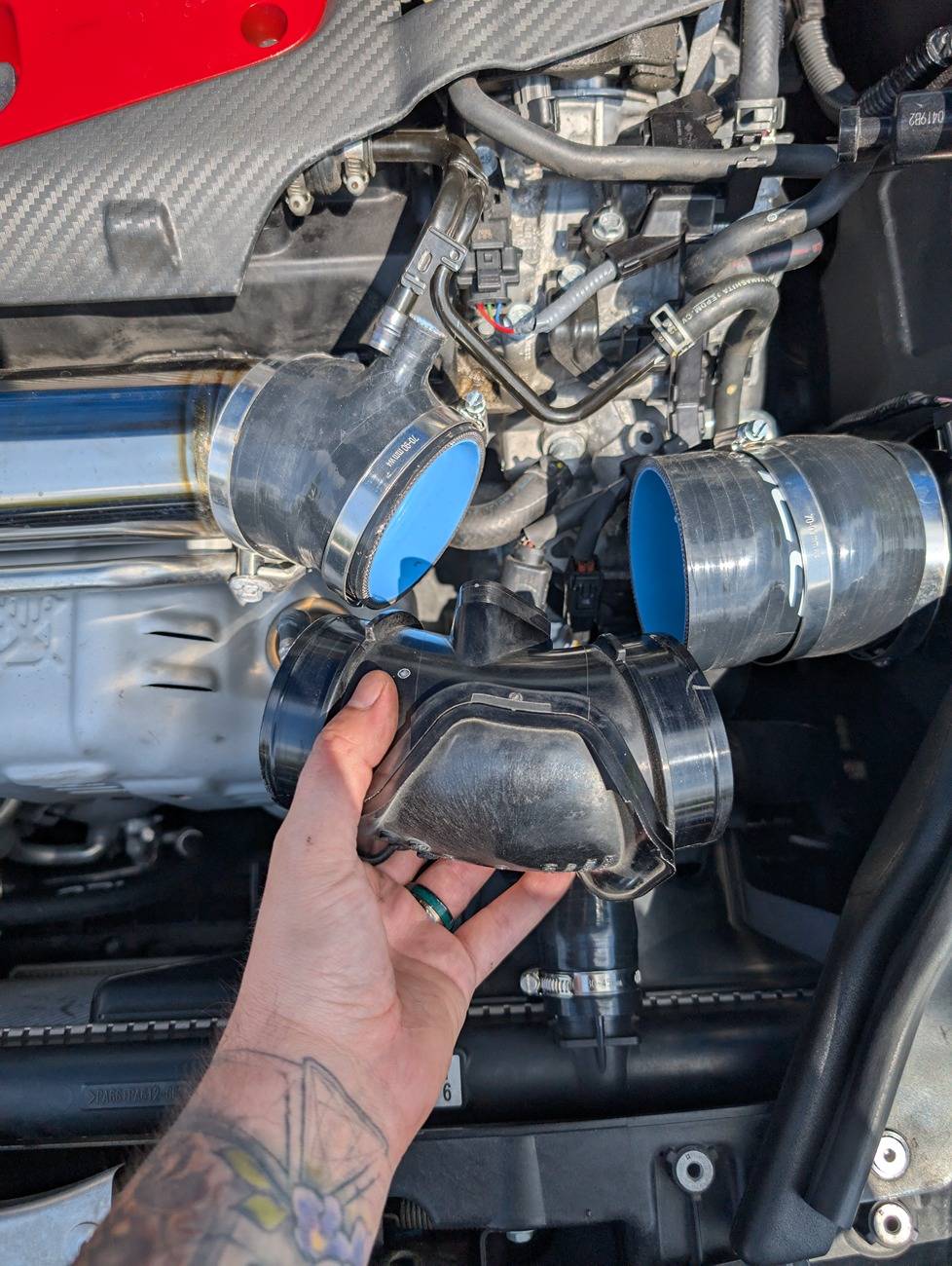

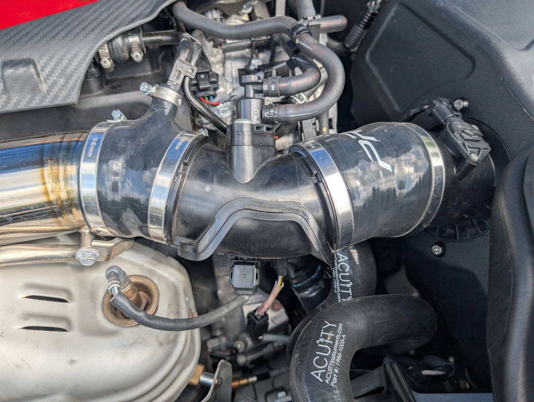

Frist, I loosened all the housing, I moved the lines to the evap valve (there are come plastic clips that just pop off.) and I pulled the rigid line back on the left (I am not a mechanic so I couldn't tell you what it is sadly haha).
11th Gen Honda Civic Necro's FL5 {Rem} Build Page (Ongoing) PXL_20250629_152255419

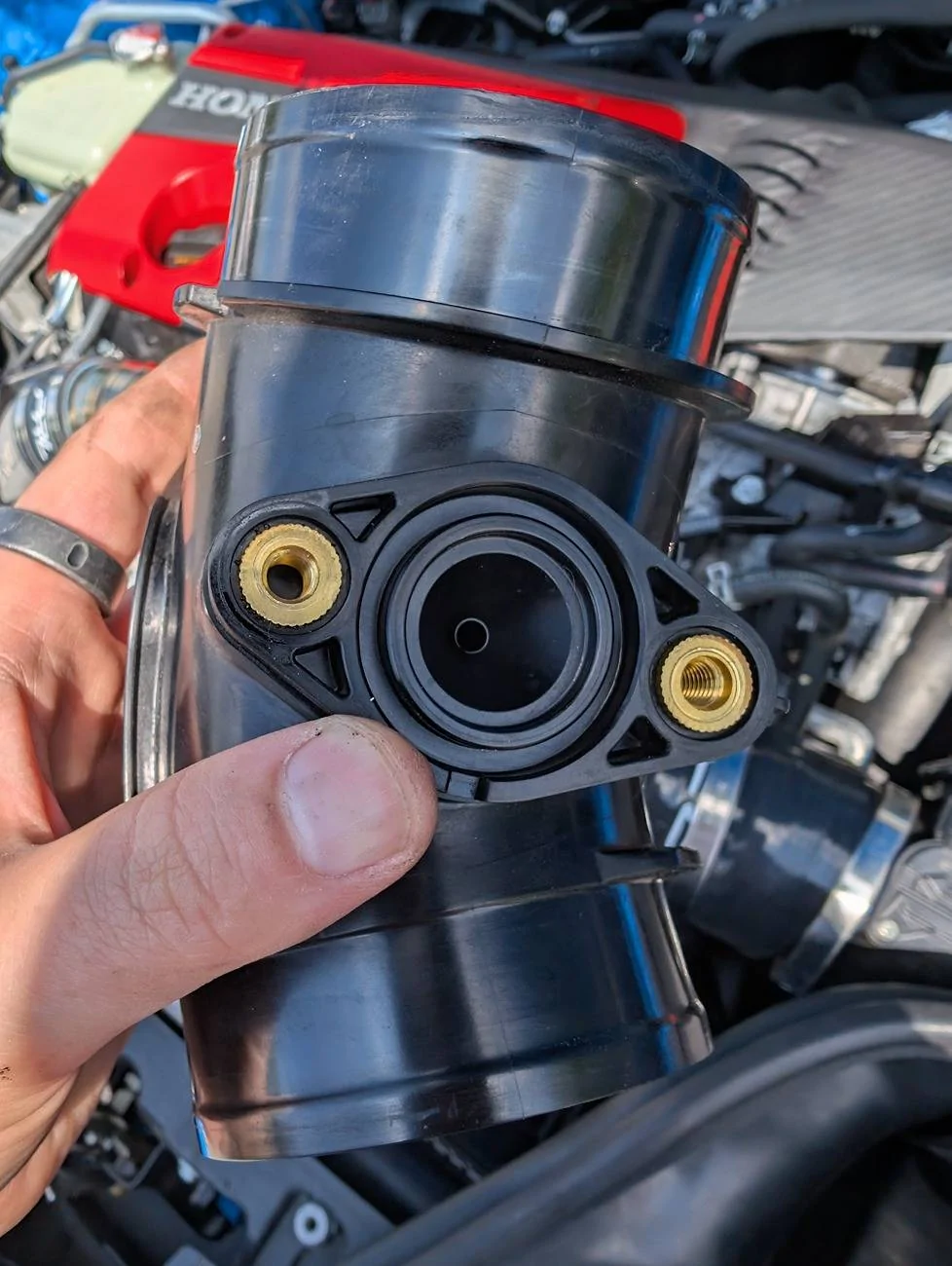

For this phase, I found it much easier to removed the plastic elbow, the evap valve uses the T30 Torx Bit. Then I pulled off the PRL silicones.
11th Gen Honda Civic Necro's FL5 {Rem} Build Page (Ongoing) PXL_20250629_152317711

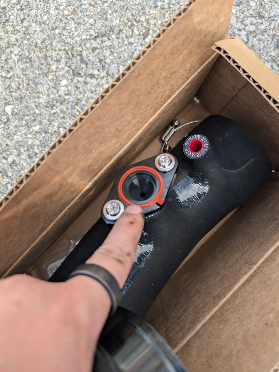

There is a red gasket here, be sure to move it to the billet aluminum insert on the TSP Coupler.
11th Gen Honda Civic Necro's FL5 {Rem} Build Page (Ongoing) PXL_20250629_152309486
11th Gen Honda Civic Necro's FL5 {Rem} Build Page (Ongoing) PXL_20250629_152855678

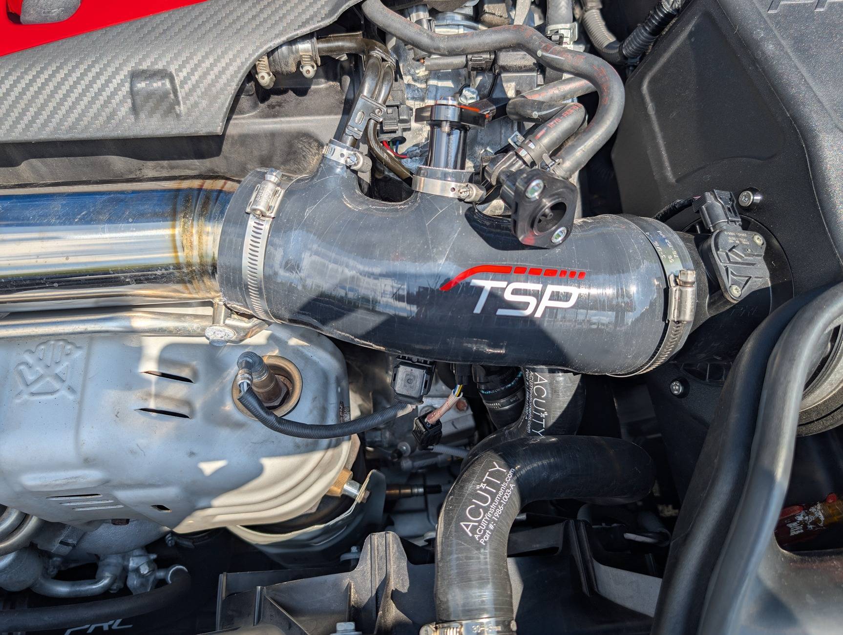

Then just fit it on there, remember to try and give yourself easy access to the Breeze worm gear clamps provided in the kit. I used my socket for them as well as the PRL removal, but you can easily use a flat head, I was just being extra. The evap valve insert uses the allen keys.
Once you're all battened down and sinched up, take photos and feel like a real mechanic even though we really didn't do much haha.
