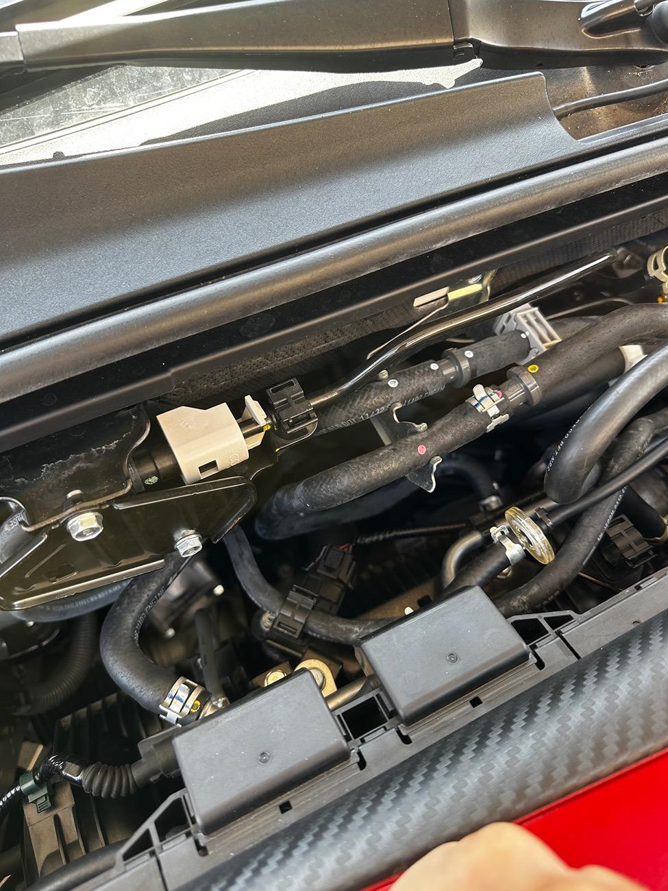

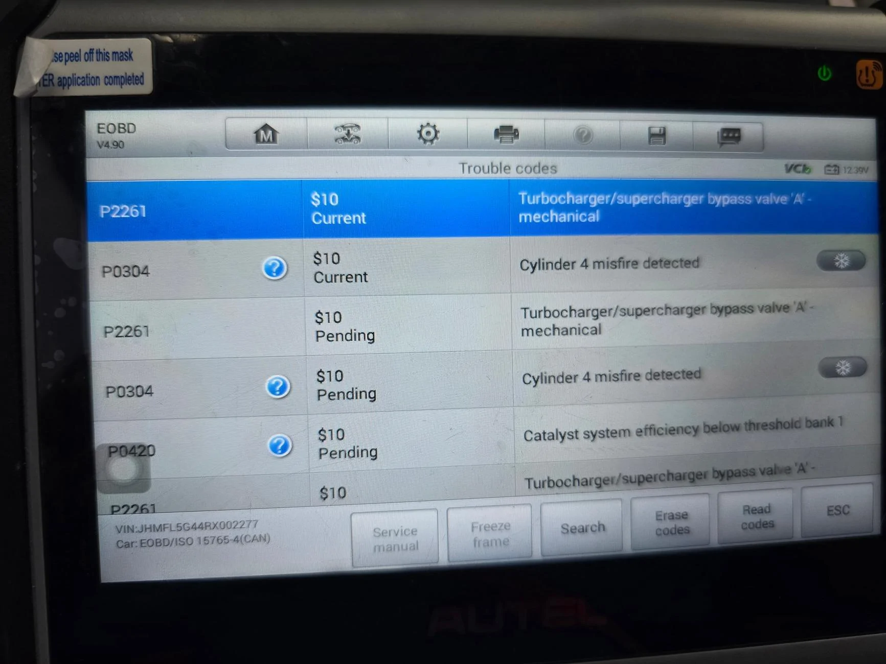

The Misfire P0304 code has being fixed and the problem was the Injector. I never thought a New Injector Will fail. Car only had 7k miles and according to XDI, debris could had gone inside the injector causing it to stuck open. Luckily I had a used XDI Injector.
The code P2261 "Turbo bypass control valve mechanical fail" was disabled with Hondata
