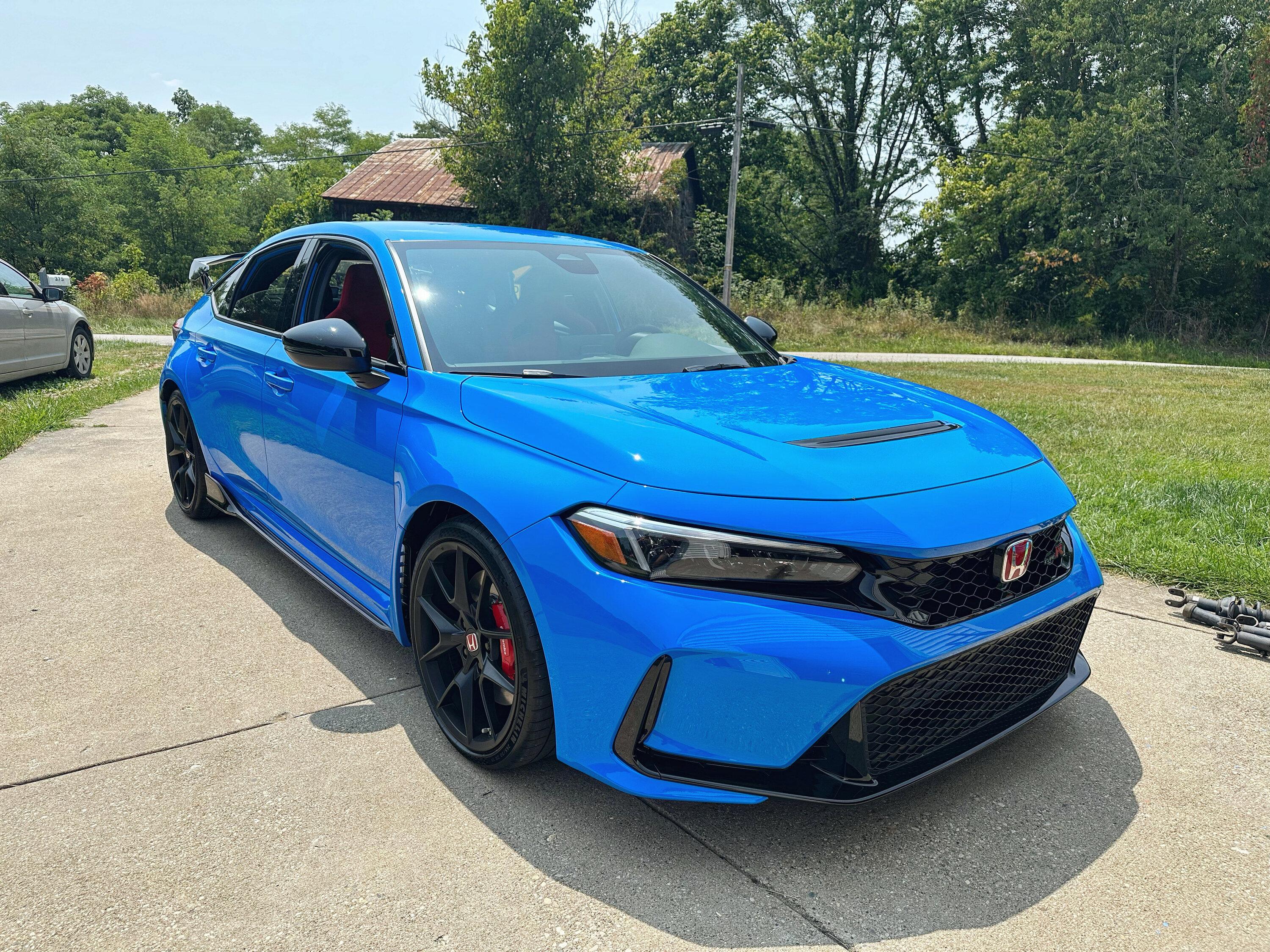

Anybody know the color code for the type r mirror caps? My driver one got a pretty big rock chip from shipping. Getting ppf installed and it’s probably easier to just replace if possible. PFA. Also would be fine with a touch up color.
11th Gen Honda Civic Mirror caps (black) 9084D645-AB53-4C5A-AE14-84B1586A637D

The color is Berlina Black; however, I'm not sure if you can buy touch up paint for the trim pieces. You will need to confirm. Depending on how bad the rock chip is, you may be better off replacing the mirror cap as they’re relatively inexpensive. They can be had for <$60.
Right 76201-T20-A31ZM
Left 76251-T20-A31ZM

Thanks! I thought they were piano black. But they do resemble berlina from an s2000.

NH547. Again, if you decide to go the touch up route, confirm it can be used on the trim pieces (mirror cover in this instance).
