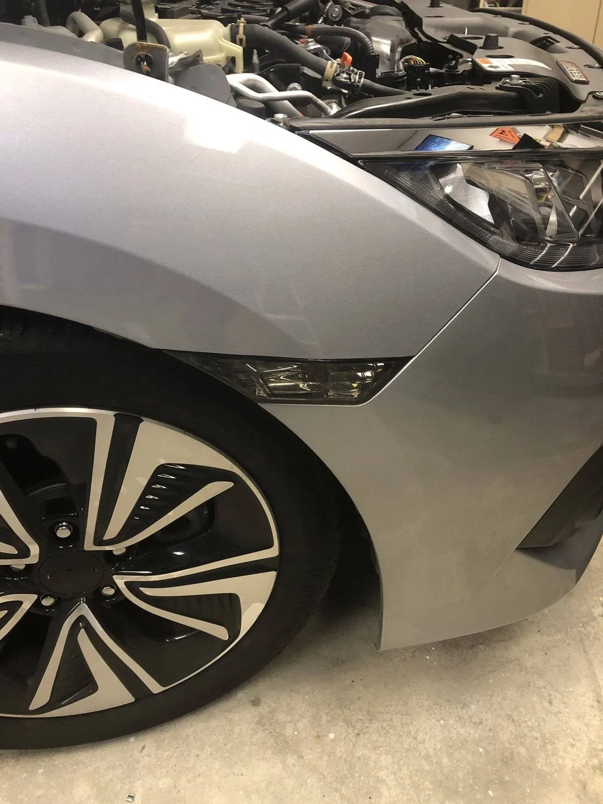

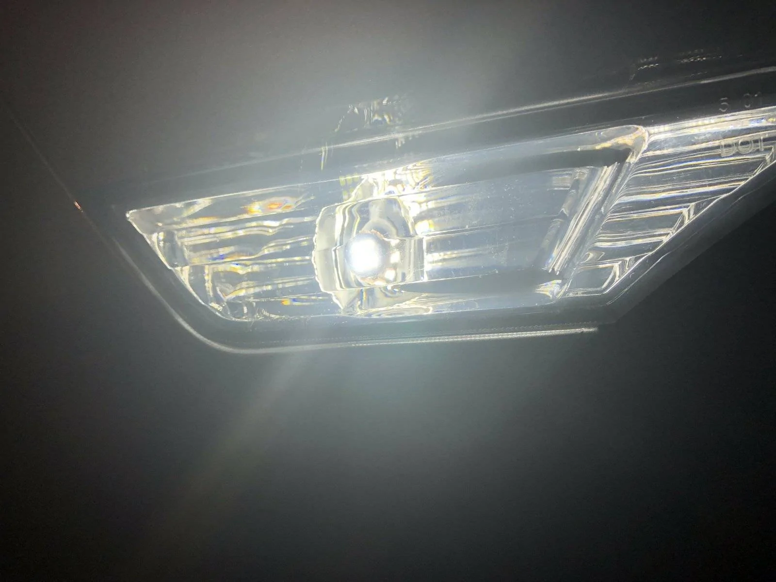

Hello everyone. Before you go off and spend all that money on these I thought I should show you my $23 side marker lights with LEDs that are plug and play. LEDS come with it that are slightly less bright but I upgraded to jdm ultra bright lights.
JDM ASTAR Extremely Bright 3014 Chipsets 168 175 194 2825 W5W T10 New Style LED Bulbs,Xenon White (Interior Use Only) https://www.amazon.com/dp/B014K7F2SI/ref=cm_sw_r_cp_api_i_advlCb3C3WXDS
