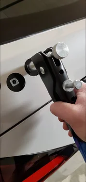

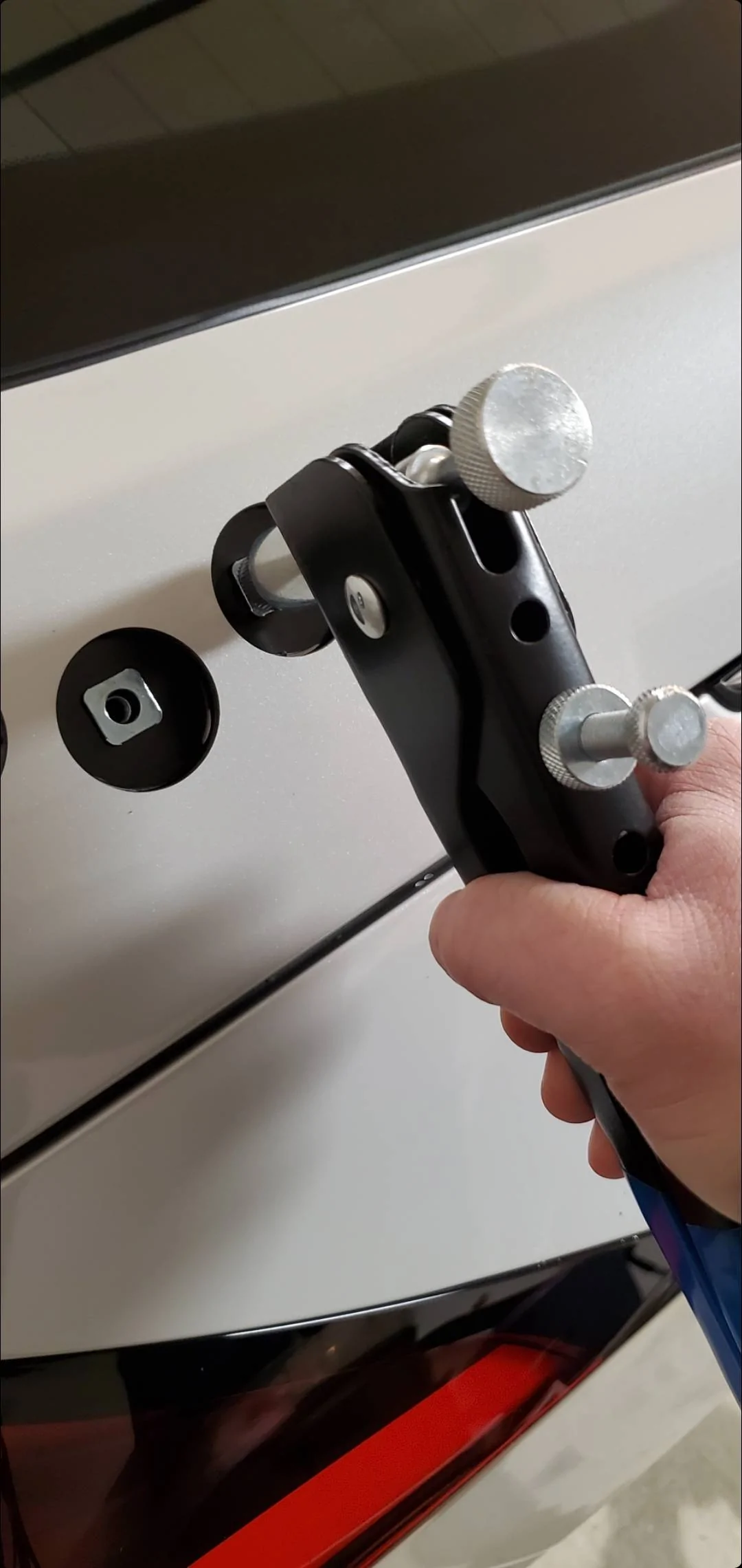

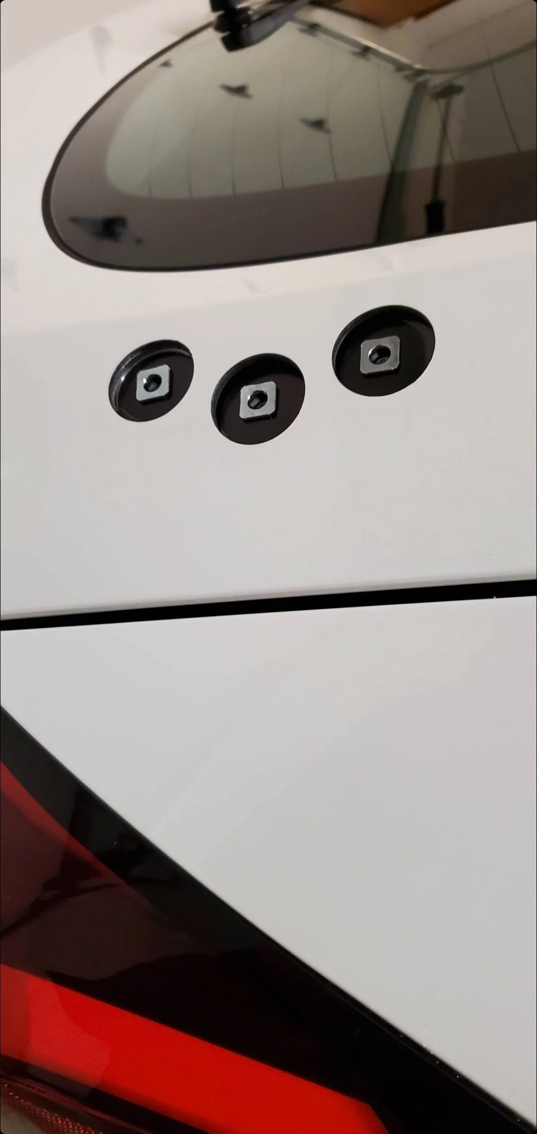

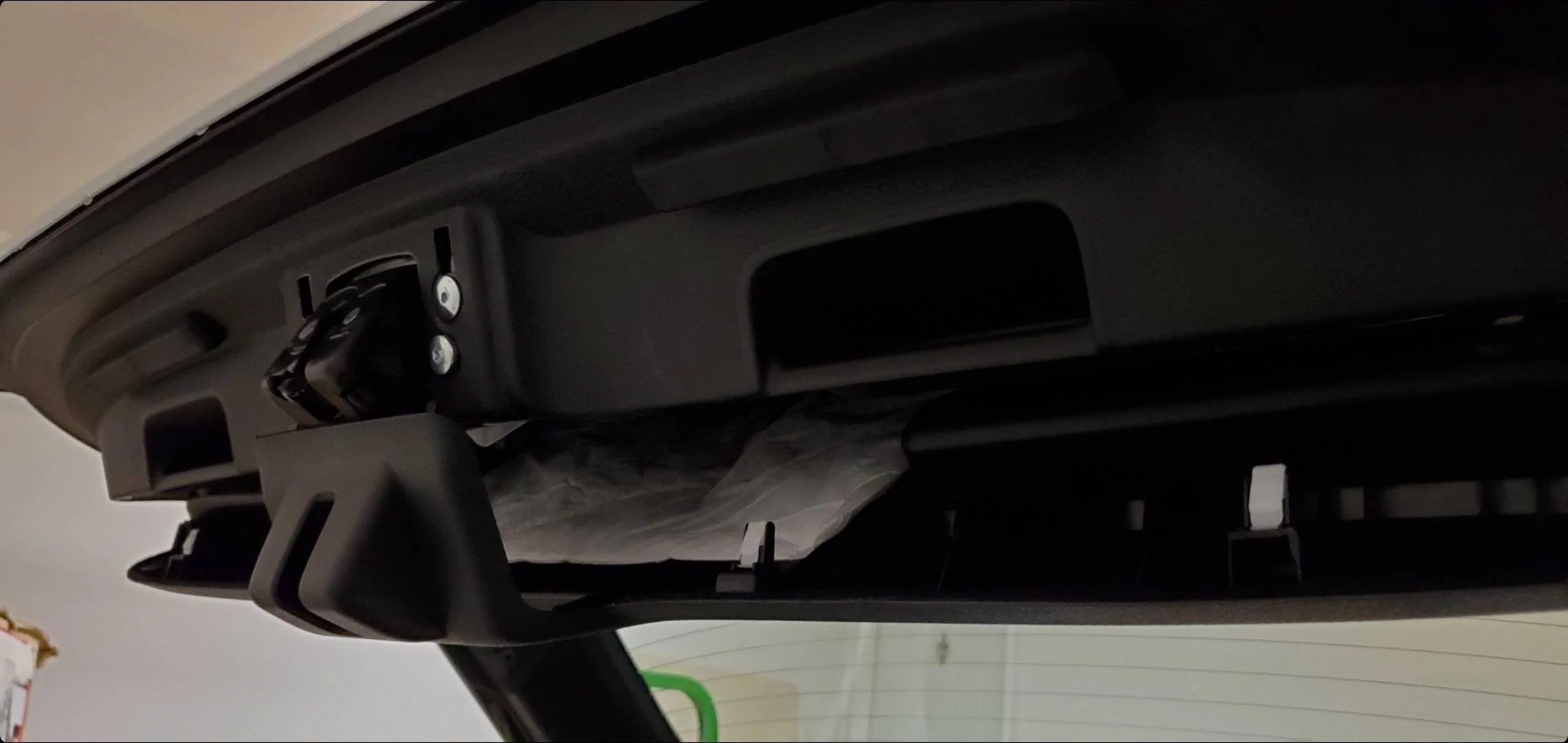

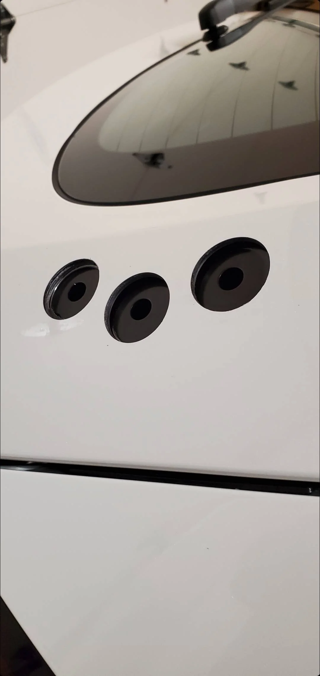

You got it. I am planning to "Not" use the Jacknuts as I don't have the tool. Looking into stainless washers and locknuts with removing the interior trim. Those jacknuts look really cheap and could have future issues. Plus if you strip one out? You're Ffffffff udged??
The screws on the legs of the spoiler are only like 3 foot pounds. So don’t go crazy. Most of the reinforcement will be coming from that strong double sided tape.

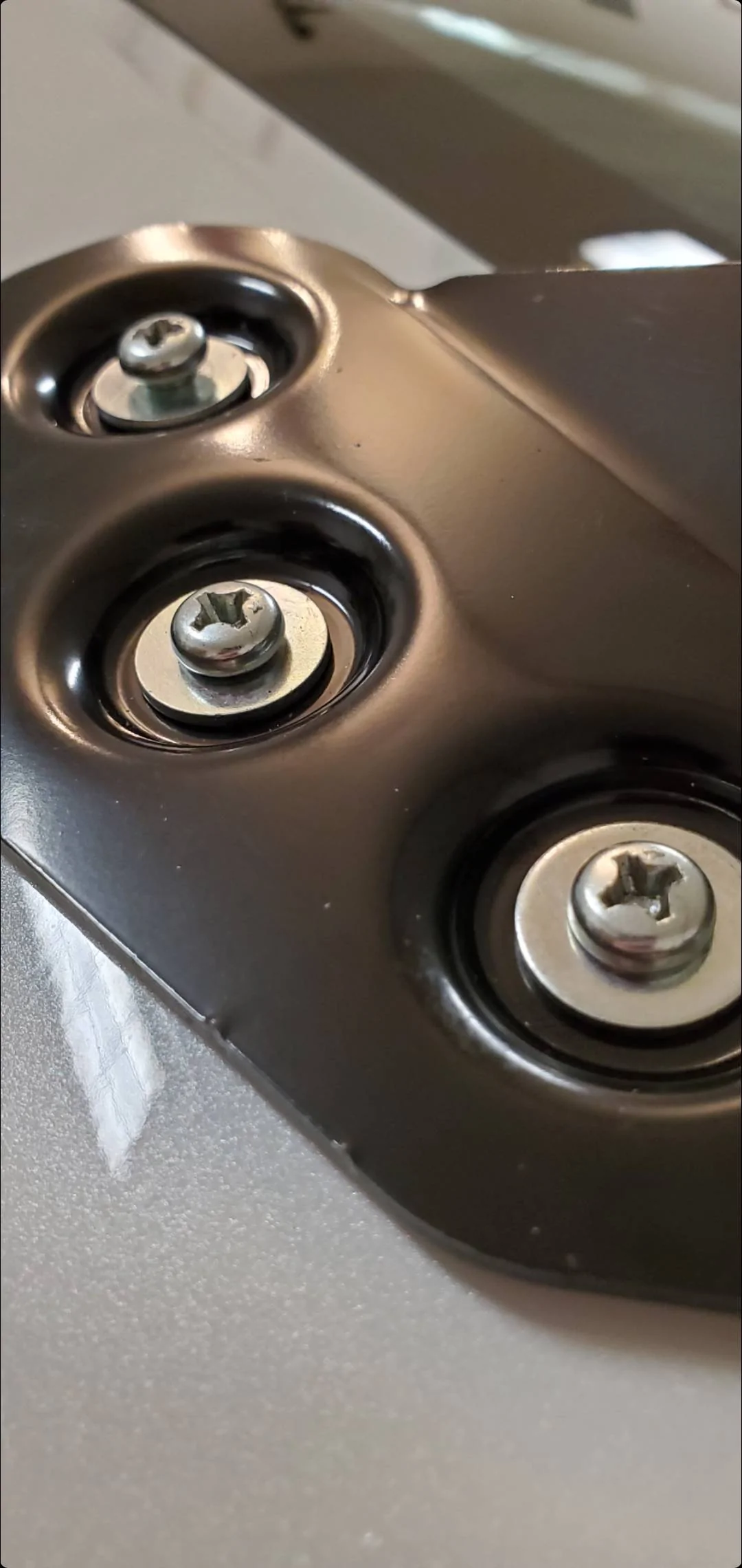

The thread lock is tight and I believe the back side of the nut on that last one is spinning.
