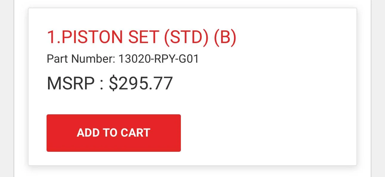

FK8:
11th Gen Honda Civic How does one distinguish between K20C1's IMG_4061

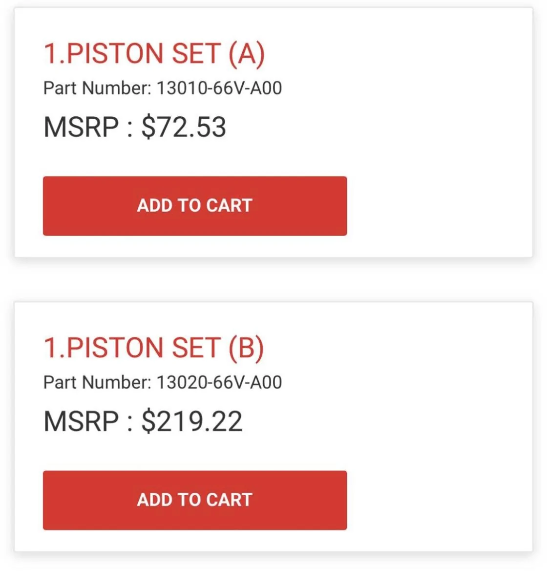

FL5/DE5:
11th Gen Honda Civic How does one distinguish between K20C1's IMG_4062
Assuming the FL5/DE5 might need to run leaner than the FK8 to meet emissions req.s?

I think the block and internals are identical. The part numbers are probably changed due to supplier changes / market.
