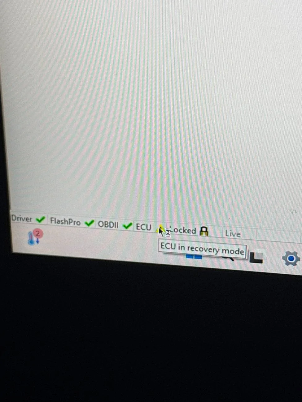

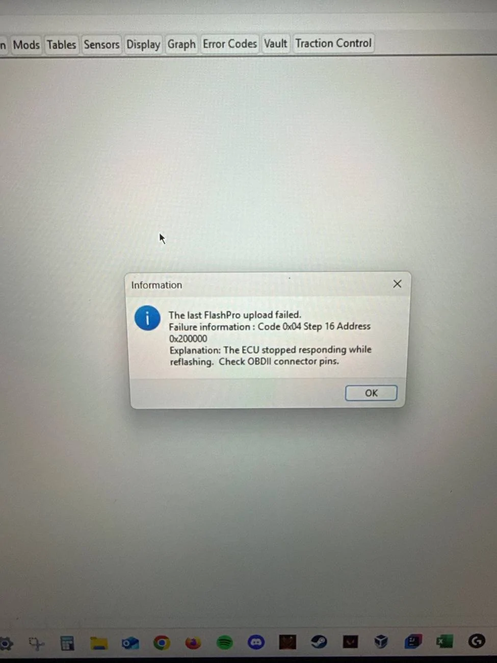

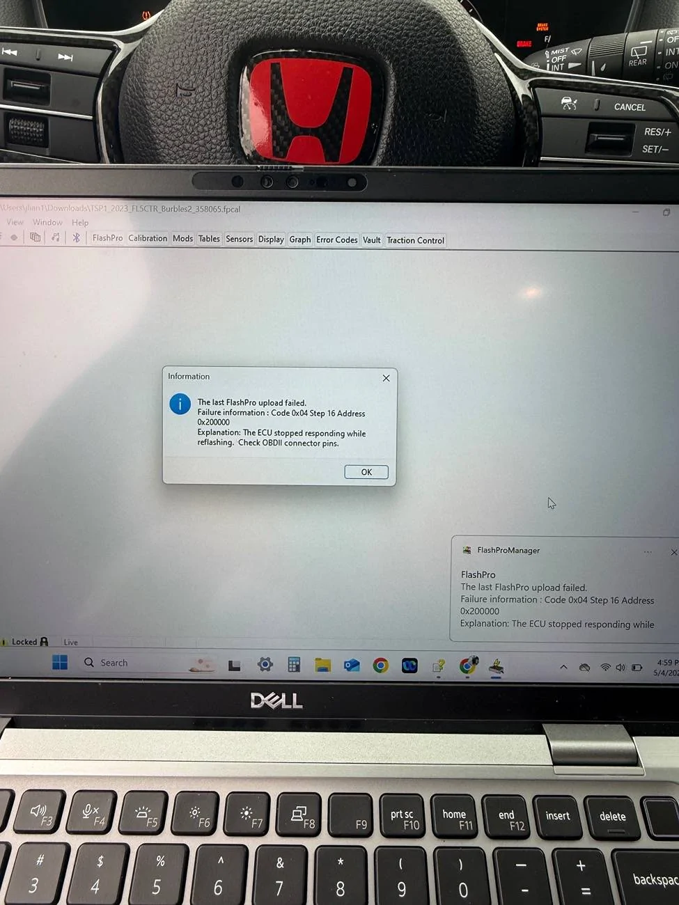

Anyone ever had this happen? Recently got my ecu back from being unlocked at IMW and decided to try and tune my car today with the TSP Stage 1 tune. I keep getting these error messages saying the ECU lost connection and now my ECU is stuck in recovery mode. Bought the flash pro off of the TSP site and made sure to register for an account and lock it to my car. Already sent Hondata support an email but I guess I’ll have to bum rides off of people and uber to work this week. Thankfully only need to travel 15 minutes each way but still sucks overall.

Yeah I double checked all my software is up to date. Even tried downloading and using flash pro manager on a different laptop but I'm still getting the same issue. About to call my local tuning shop tomorrow and see if they can assist as well.

Good morning! I do not see that you have contacted us regarding this issue but I am glad to have come across it here. As you likely suspected this does appear to be a hardware issue. I noticed that the Hondata error message says to check the OBD2 connector pins but do not see mention of you doing that here. If you have not already, please do check the pins on the FlashPro device. I see that the FlashPro device was not purchased from us so I cannot guarantee it's condition but that would be a great place to start, aside from waiting for Hondata support to get in action there on the West Coast.
One other thing you could check are the pins on your ECU connectors. You will want to make sure that none are bent or damaged. While I've never seen a damaged Hondata connector pin, I have seen damaged ECU pins a time or two before.

Any bent pins would likely be pretty obvious as long as you inspecting all 3 points closely (the FlashPro itself and 2 ECU connectors). My best recommendation would be to wait for Hondata support before involving a third party that may or may not be able to help.

Update - Kinetic auto works was able to successfully unbrick my car. ECU status says unknown but I reached out to Derek Robinson from IMW and he verified "If you're viewing the jailbreak status in FlashPro, it's going to say "unknown." That is not a reflection of the ECU's ability to be flashed. Your ECU is unlocked and able to be flashed, according to my records of such. If you encountered a flash error, you have another problem with the DLC connection, grounding, or the PC being used." I really don't feel like going through this ordeal again so as much as I'd like to try re-flashing the TSP Stage 1 tune , I'm just gonna eat the cost and wait for a dyno tune after I get a downpipe and turbo installed.
