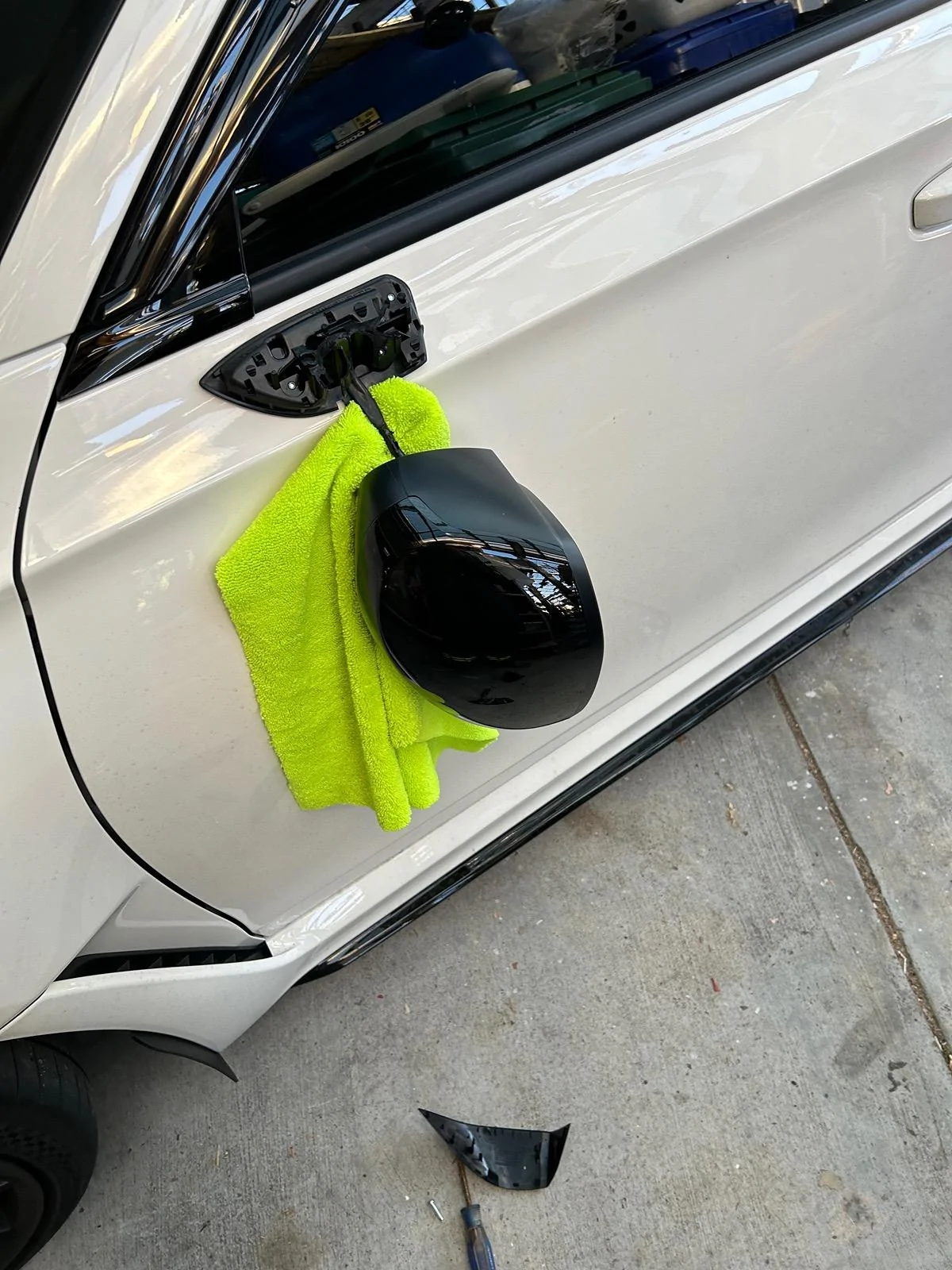

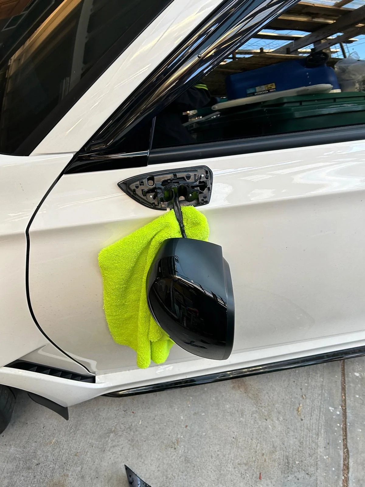

Hello does anyone know how to remove the wire from the mirror cap? Some idiot got my driver side mirror and took off don’t want it to dangle while driving to the shop

That will probably require to remove the door panel and disconnect it.

its located on the inside of the door pane. towards the front by the hinges. and
there are three #10 bolts to unscrew it

Behind door panel there's a connector.
