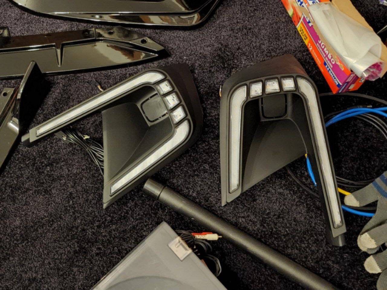

That all said, Lets begin. First off, I wanted to take a peak at what I'm dealing with. I wouldn't really entitle myself a "Car person" I'm a computer geek and CNC fanatic. I didn't want to take the bumper off to get to these, so I used shim-stock and prybars to aid at removal, to see how these things work. After popping the unit out, I was finally able to see the back side of the parking sensor. The unit itself is held on via 2 clips. This simply pops out revealing the sensor. The plastic part it connects to, is literally double-sided taped on. This is nothing more than a curved thin piece of plastic. It in no way "clips" onto anything, Tape only.
11th Gen Honda Civic Hatchback Touring DRL Trim LEDs Combined

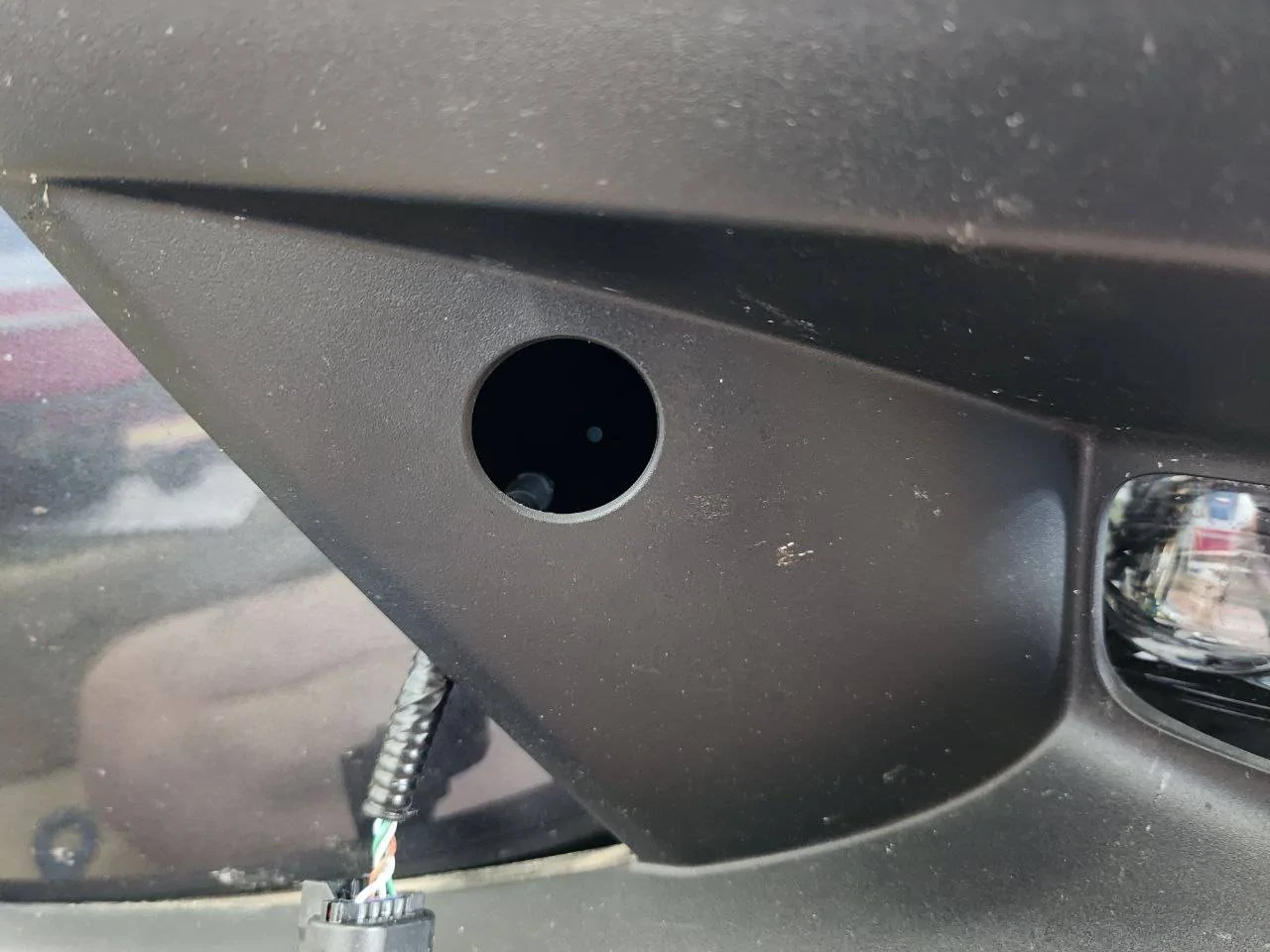

So, the spot for the sensor is literally nothing more than a roughly 28mm diameter hole with a chamfer around it. The backside is much the same. Nothing to it.

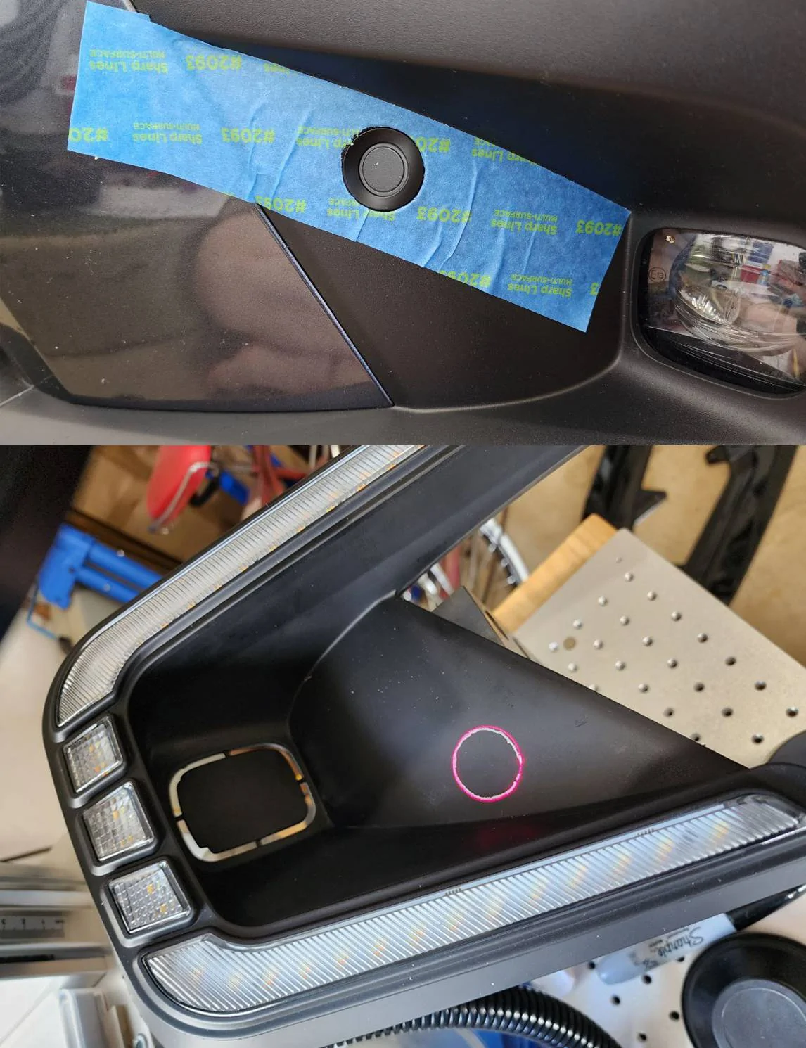

So, now knowing what I'm dealing with, I decided to mod the aftermarket parts. I used painters tape to follow the contour, top edge of the trim. Something that I know I could use as a reference and repeat it fairly well. It was easy to see the indent of the sensor, to cut it out in the tape. Simply placed it on the aftermarket part and roughed the circle shape with a sharpie marker. From there because I was too lazy to figure out how I'm going to drill a 28mm perfect hole in a curved surface, my easiest solution was to just shove it into the laser etcher and buzz a quick 28mm circle. Laser light follows the contour so..couldn't be any simpler.
11th Gen Honda Civic Hatchback Touring DRL Trim LEDs Transfer

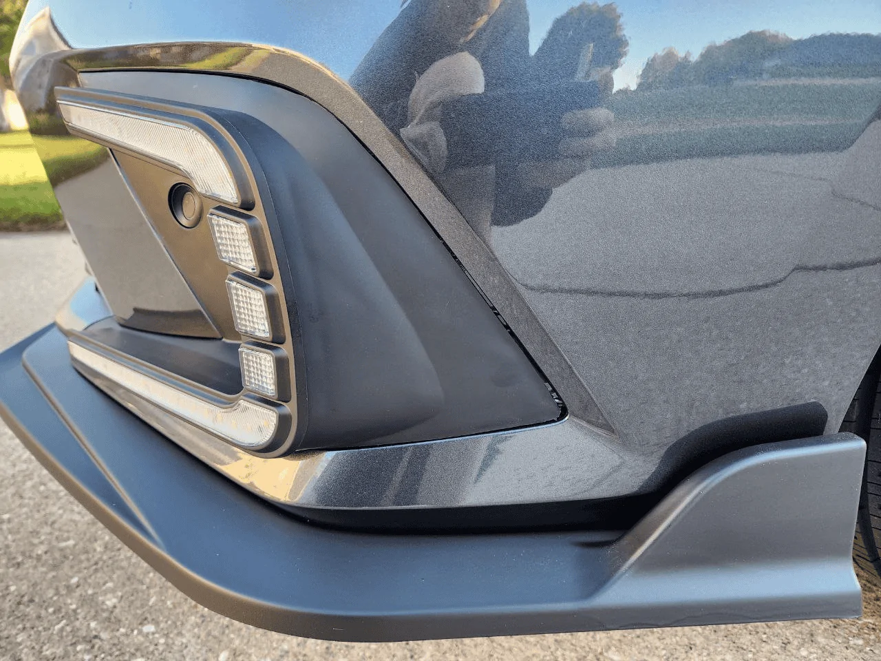

The end result is a parking sensor installed onto the aftermarket parts a test fit. Aside the fact my hole is sharp-edge and not chamfer, it looks pretty identical to the stock sensor installment. Honestly couldn't be happier with how overly easy it was, as I've seen some pretty crazy ways these sensors mount. Thank you Honda for just plowing a sensor onto a flat-plate with double sided tape hahaha.
11th Gen Honda Civic Hatchback Touring DRL Trim LEDs photo_2022-09-10_16-12-12

My only complaint is "Typical aftermarket fit" Although the two clips ARE indeed clipped and secured, there's a gap. Next time I have things off to re-do the wiring, I'm going to put more time into seeing why this is. Hoping its just hitting the foglight lens and a little sading could fix that. I'm sure its fixable. Minor details.

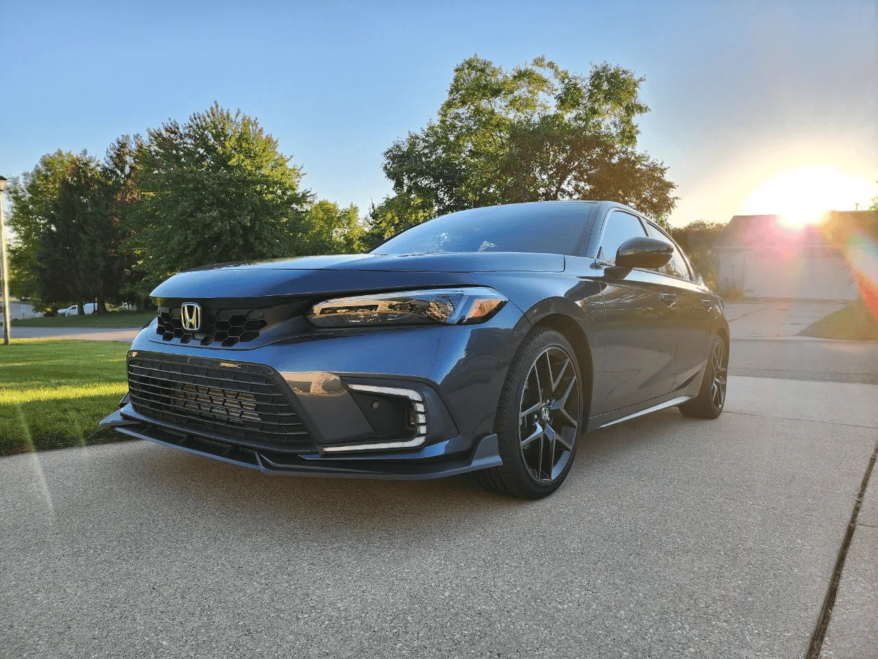

Regaurdless, they're on and the parking sensors are in. I just have to tap into the headlight connector. Waiting to get some waterproof connectors in the mail. So until then, they're not connected yet. Even unpowered, in my limited unbias opinion, I think they're a nice addition to the looks of the car. That area always felt so un-finished to me. I really wish the stock had LED trims. Pretty happy! The torn-off adhesive for the parking sensors is nearly unusable. So I kinda bodged them on with glue for now, but still sent out an email to a few places to try to get OEM replacement mounts.

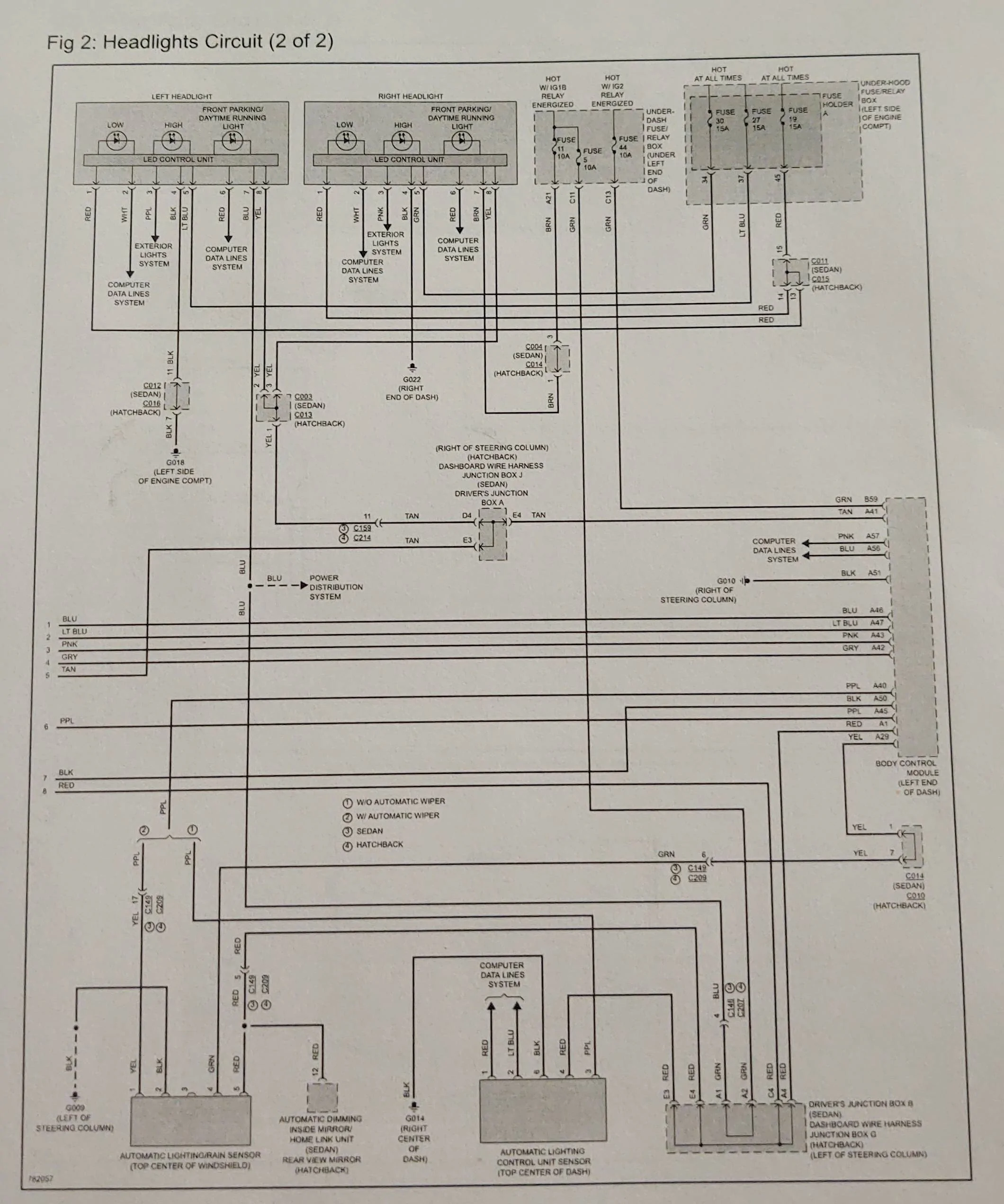

Headlights on the Sport-Touring are full LED. One connector, 8 pins. A lot of control of them is by a 3.3V data/logic signal. For example, when you turn the car off and the headlights are on, then turn off after 30 seconds. NONE of the pins goes from 12V to 0V. Thats just a data signal saying to turn off. Thankfully, I can still use 3 of the pins ( #3, #4, #7 ). Which is Turn Signal (0V / 12V ), Ground, and Ignition ( 12V when car is running, 0V when off ). Sooo..Yep!
