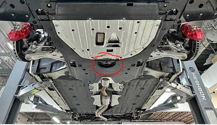

Look just behind the aluminium under tray - there is a point on the subframe to jack from.
Its a fair way down, so I drive the vehicle onto ramps in order to get the jack under there. You'll want to use a rubber jack pad too rather than have the steel cup dig into the subframe.

For some reason they put it super far back, where a regular jack cannot reach, at least if you're lowered.

You can use ramps to lift the front to get clearance for a jack to get to the front jack point, or use the 2-jack method by jacking up one front side jack point pretty high, then use the 2nd jack to get to the center jack point.
