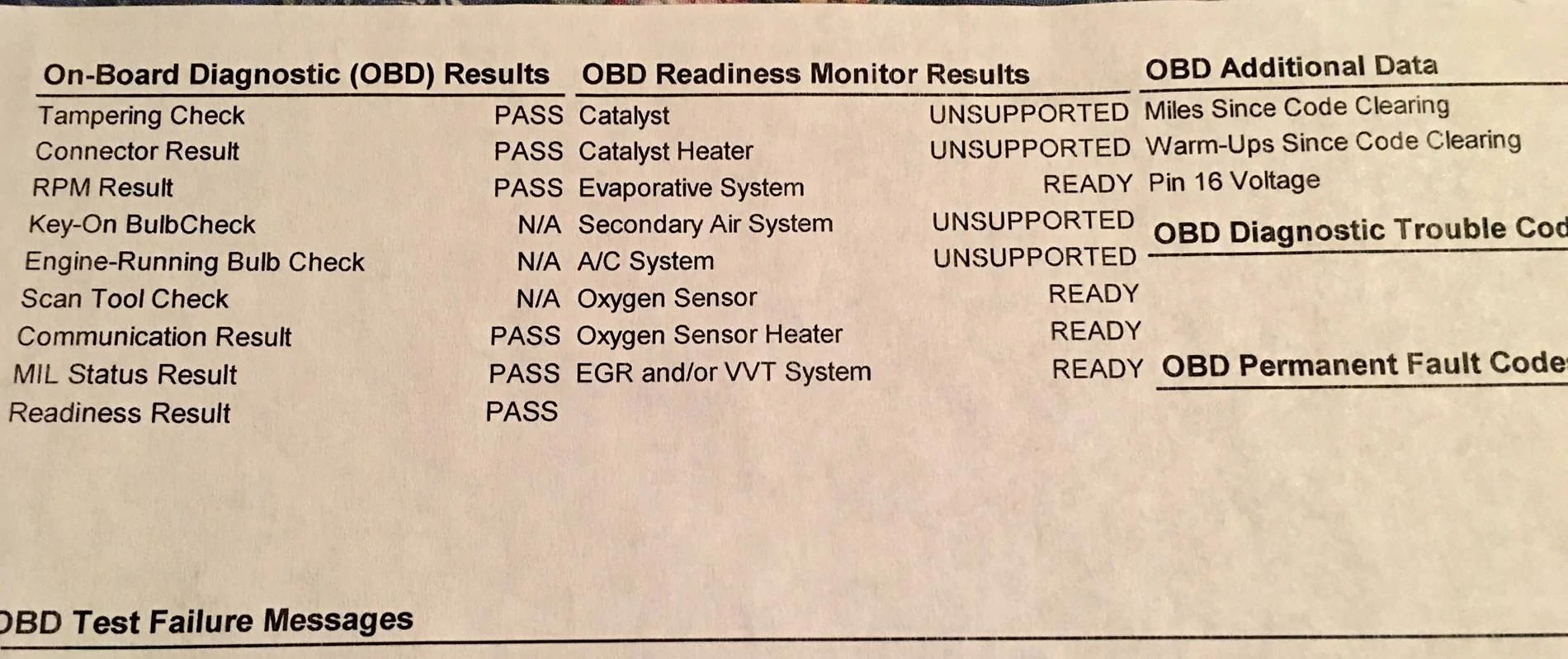

Fortunately, Texas no longer performs inspections, and only four counties still conduct emissions tests on the OBD2 to confirm the "READY" status of the EVAP and O2 sensors. When I failed my 2017 Civic's inspection after forgetting to turn the O2 sensors back on, I was given 12 days to fix it. I drove home, turned them back on, drove until they indicated "READY," and then went through the inspection shop -- annnnd passed, got my sticker, and drove off. Several miles later, my CEL came on. 2.0 NA high-flow cat problems... they do record inspection passes and fails and report those to CarFax, so it did have that one ding on its record. Oh well. Each year after that, I would drive through while the CEL was off, lol.
Thanks for the reminder to check my OBD2 to ensure my tune hasn't inordinately turned off any sensors on the FL5.

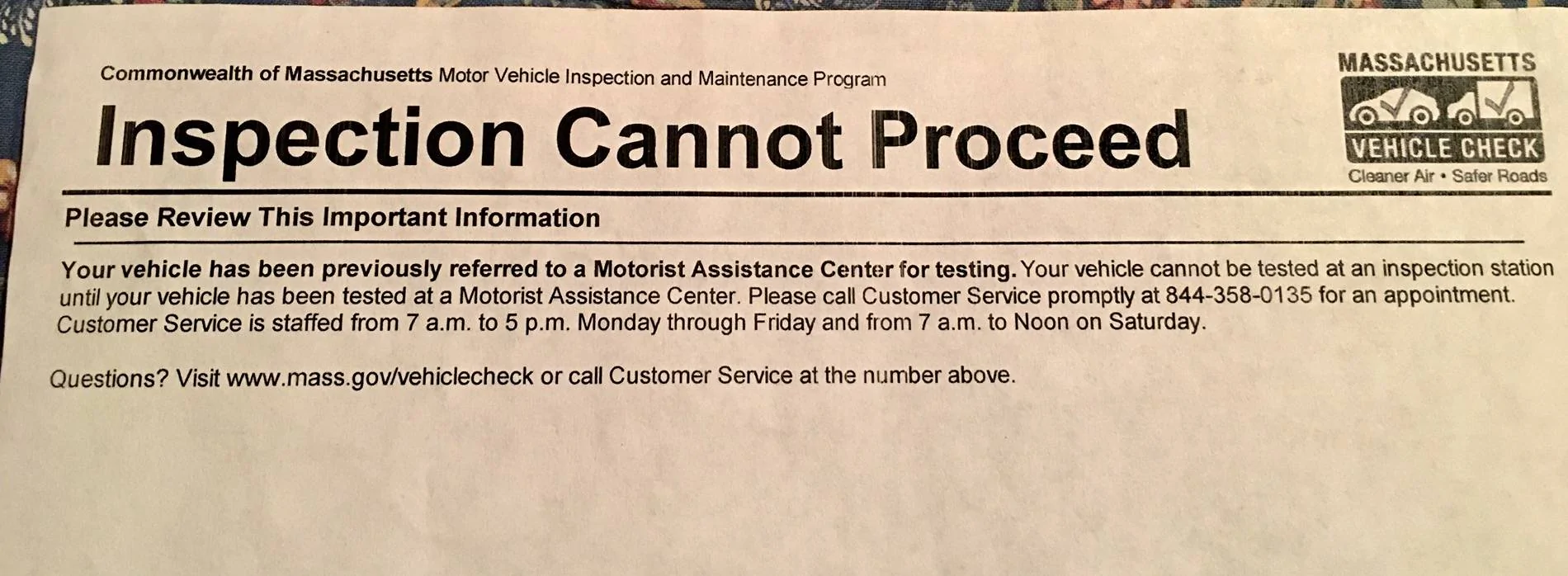

I was so hoping to have the same experience. Got the monitor back on, went through the drive cycles, everything was ready but the inspection machine still spit out the “this car cannot be inspected” message?. Until I had everything verified by Honda themselves, I was boned. Thanks Massachusetts! I’ll bet if they actually put an emissions analyzer in the tailpipe, it would have passed with flying colors with the TSP downpipe, but I had to remove that too for a visual inspection. All that is what I’m hoping to help anyone else avoid.
