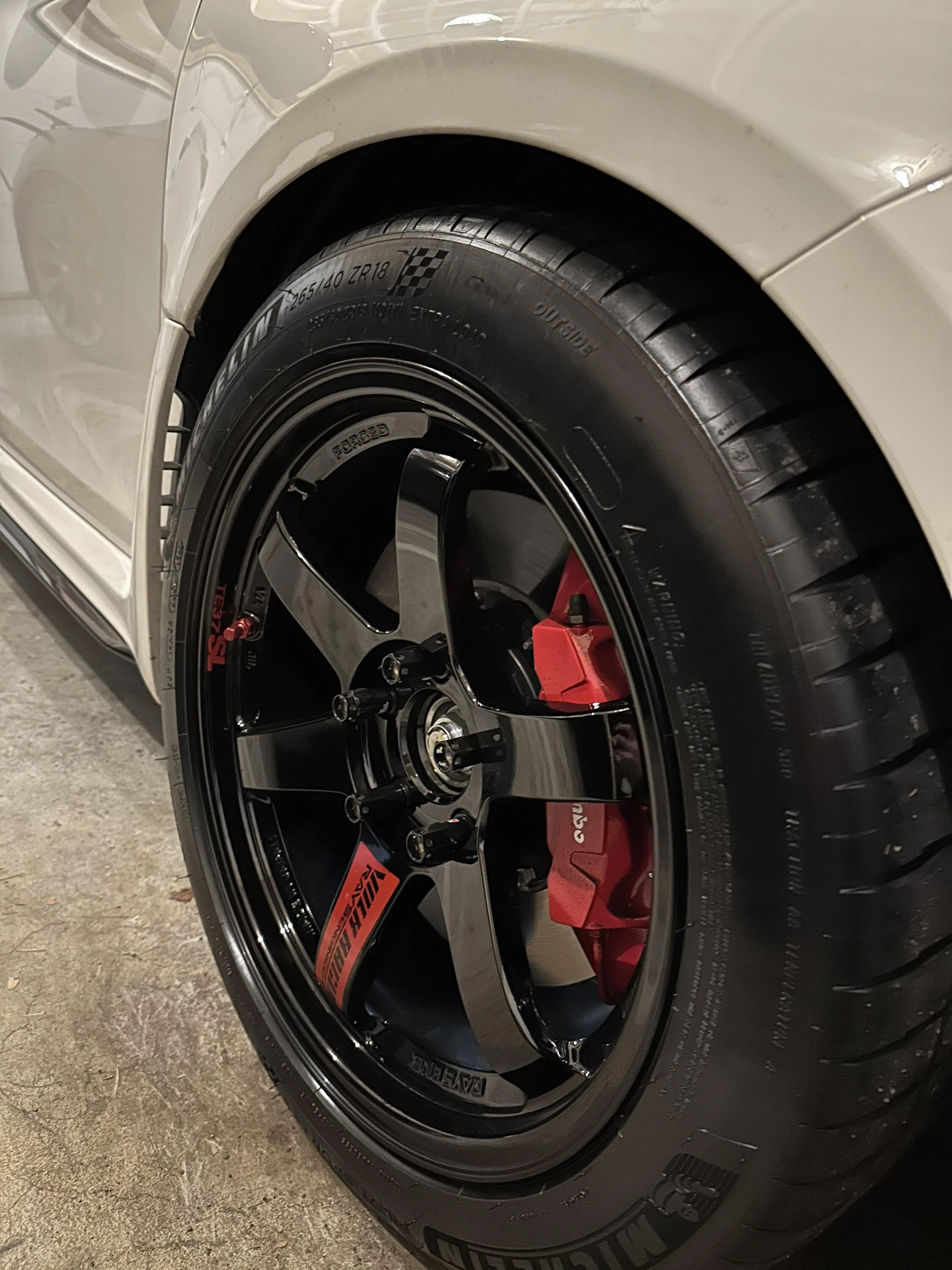

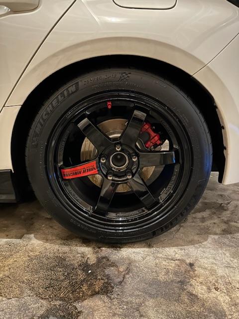

In case anyone else needs further proof that 265/40/18 first without rubbing here's what it looks like with hankook ventus rs4 265/40/18 on Enkei t6r 18x9.5 5x120 +45
