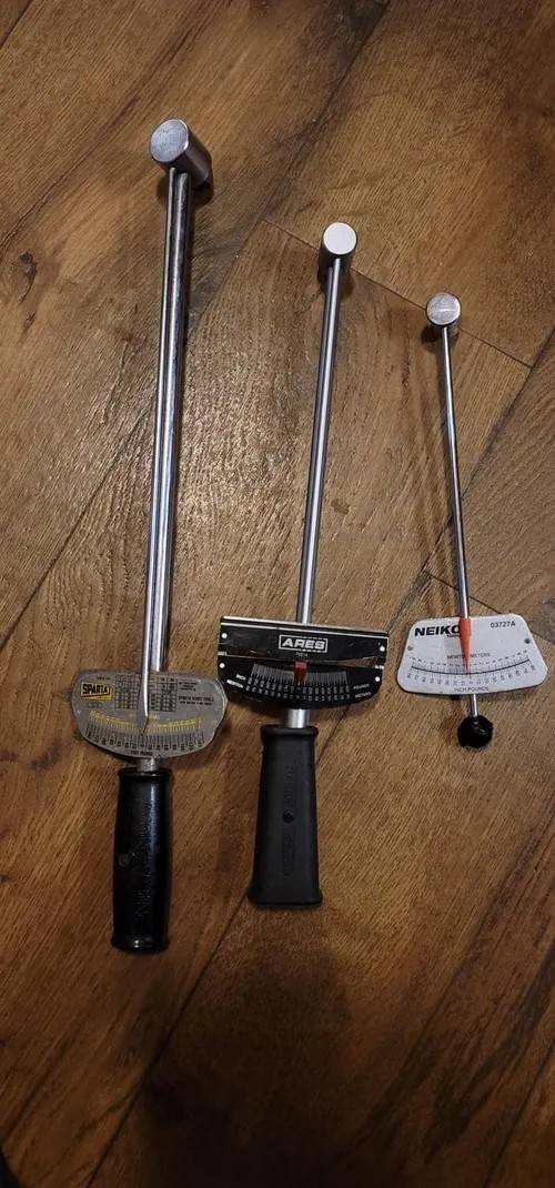

227
Long Island
I use a beam style torque wrench for stuff like that. I feel it is much more precise for small and low torque items. 6ft/lb is almost nothing.
