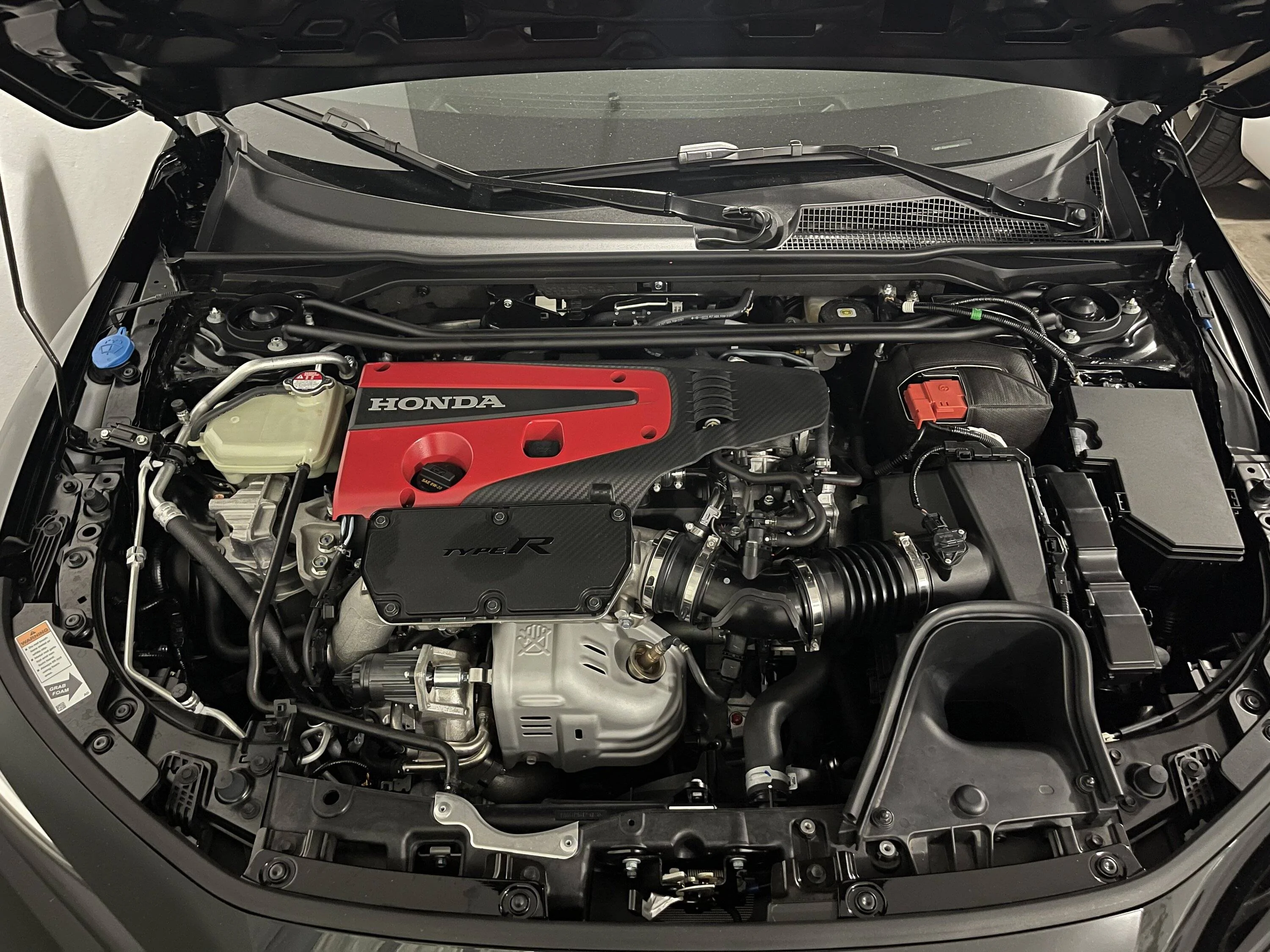

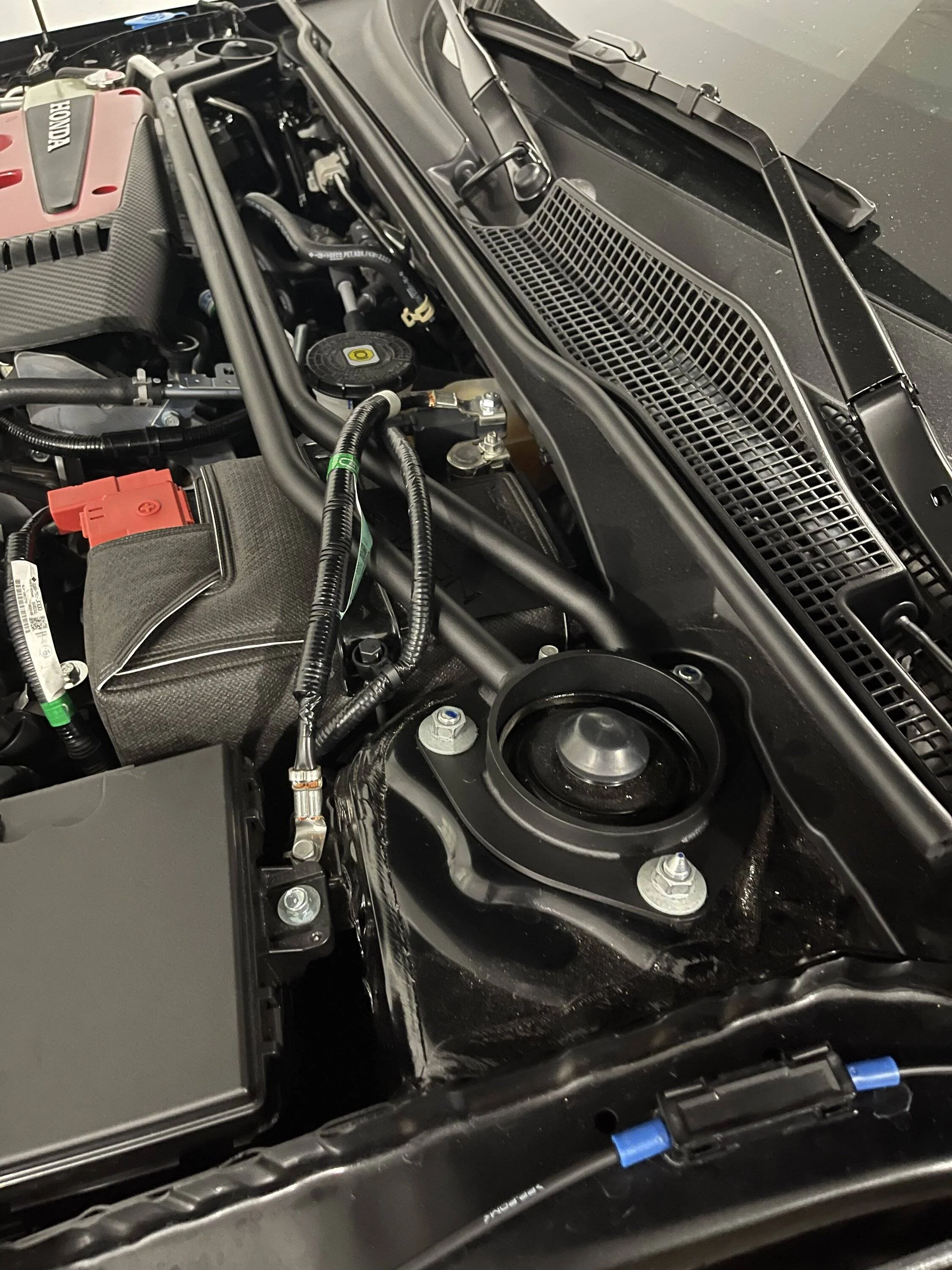

downpipe, and FSTB both cross over.
FTSB and brake brace fitment confirmed with a bit of “modding” to the battery cover. I’ll share pics soon but think I might have it powder coated red first :)
