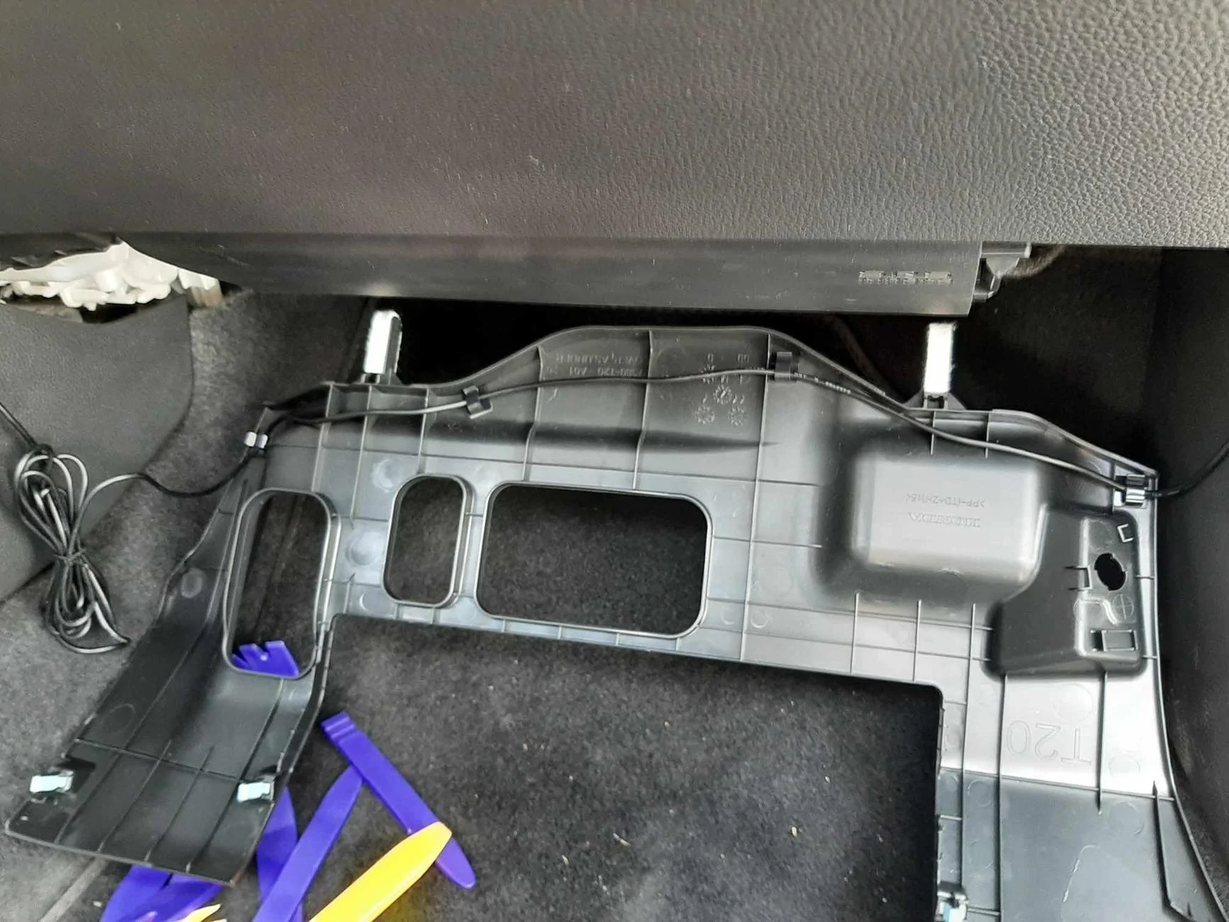

Some pictures of the install
If you want a correctly deploying side airbag, you gotta route the cable BEHIND the airbag, thats why you gotta remove the A pillar and do some cable management

footwell area
