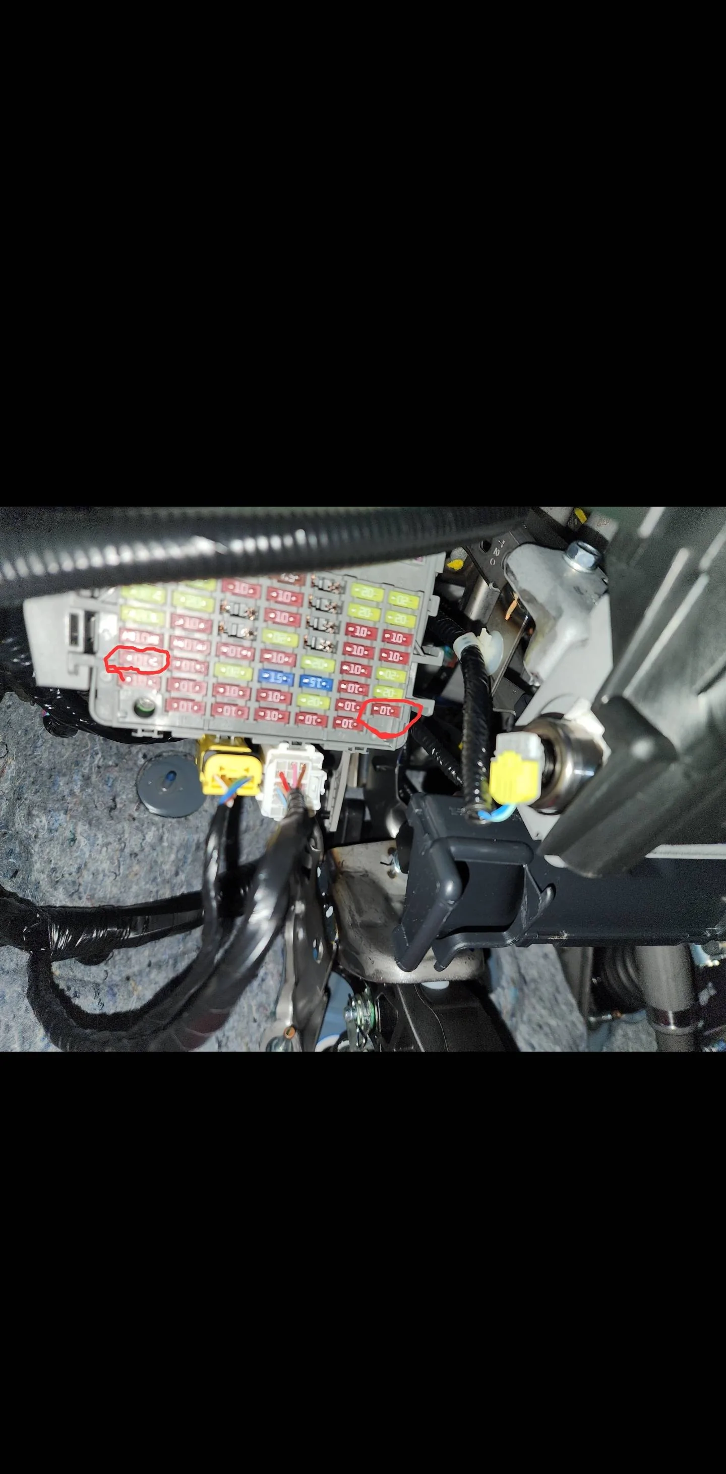

Did you hardwire into the fuse box? If so do you remember what fuse location you used?

I did, I didn't specifically pick a spot I just used a circuit tester to find a battery fuse and an ACC fuse. I used 10A fuse locations. I can try and get a picture of exactly which ones they are for ya if you'd like

Here's some pics to help you out if you decide to go that route.
Definitely be sure to double check with a circuit tester. Hope this helps.
11th Gen Honda Civic CTR Initial Mods 20221230_135915

Thank you sir. This is very much appreciated.

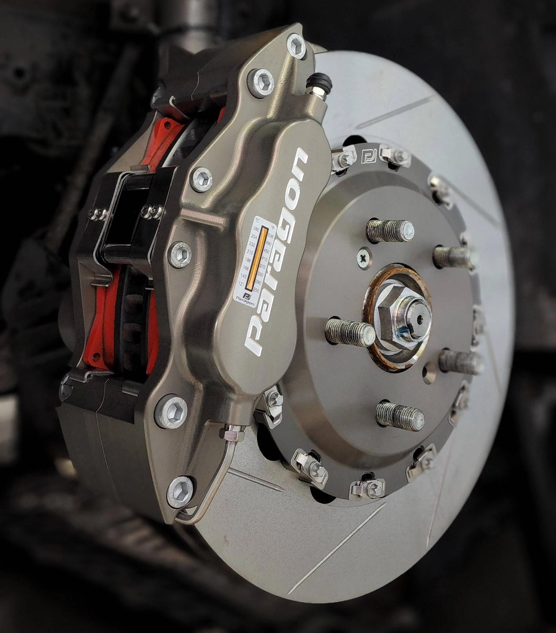

Speaking of initial mods, this afternoon I sent out the following to a good friend who's building his FL5 for the track.
Paragon 6-piston Front BBK + R5 Track Pads + Titanium Shims
Paragon 350mm Upsized Rotor Kit + R5 Track Pads
Link to Paragon Brakes @ Unity
He did his first track day in the FL5, obliterated his stock FK8 time by 5 seconds and found the limits of the FL5 stock brakes. We thought about doing just the Rotor and Pads upgrade instead of the full BBK right away but changed our mind as he already tested the capabilities of the Brembo system by the end of his FK8 ownership with aftermarket two-piece rotors and many different pads.
FK8 Rotors, Pads, Calipers, and Brake Lines carry over to the FL5 entirely, so that's a huge relief as the rest of the 11th Gen lineup is totally different from 10th Gen. Here's pictures of how the setup looks on my FK8, and I will share the content when he's got his setup installed :)
Stay tuned for this setup on the FL5!
Disclaimer: I will 100% say that for the novice-intermediate folks, you do NOT need to start off with a brake upgrade for your FL5! Try your first track day completely stock, then once you've finished them / exceeded them go for pads + fluid + shims and maybe SS brake lines. Once your rotors are done, then get some that fit your budget - you can get away with a $300 aftermarket set, OE 2-piece for $650, or $800+ for EBC, Girodisc, Paragon and others that are also 2-piece but benefit from much better venting than OE. Unless you're doing it for aesthetics, an aftermarket BBK for the FK8/FL5 is only for those going for ultimate time attack and endurance racing, and same goes for the 350mm Rear Rotor Upgrade.
Mad respect for the disclaimer.
Those brakes look sweet though!

Thank You, and absolutely I'm against any advising or pushing of parts for the sake of making a sale. Just not something you'll see me do. 2017 - 2019 I was just a member of CivicX building my Si and sharing my progress, and through that process one thing led to another I was doing group-buys, and once the group buys became too big to manage I created the brand. Been working away at it, humbled to have a heavily modified FK8 now, FL5 and ITS on order for 2023-2024.
So yeah, I'm just in the dude in the community that's also building these cars, sharing my learnings, and grateful to have the support of people who want to do the same :)
