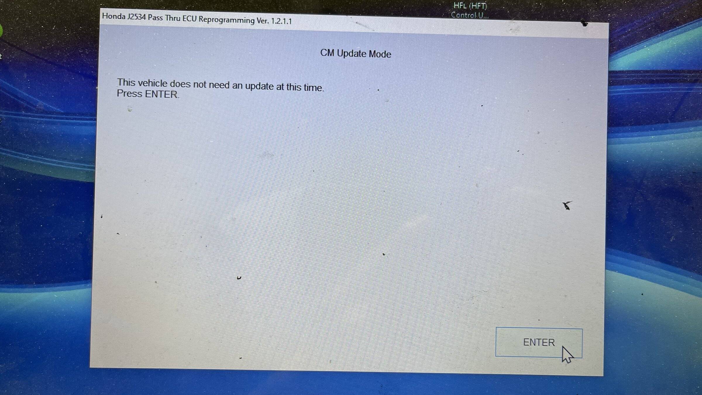

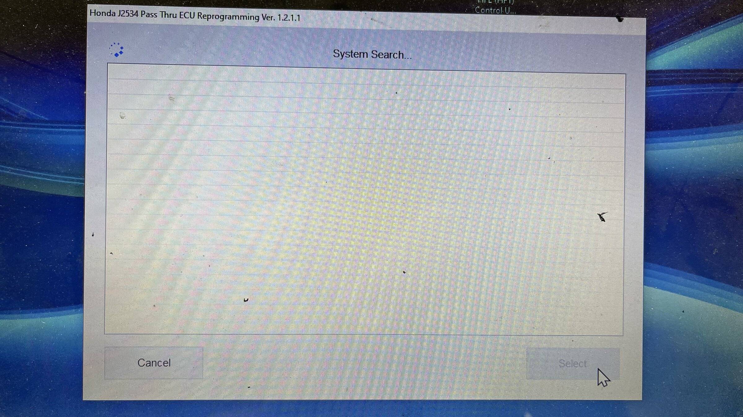

Here’s an update. Went to go do this on my car today at the shop. First screen is what we see in “HDS” when it’s searching for any available updates once your vehicle is plugged into obd2.
What is supposed to show up would say “ACC/CMBS”, but in the second picture, you’ll see that apparently either my car, or the update itself, isn’t ready for it yet ¯\_(ツ)_/¯
Anyone else should update here too so we can see who’s getting what?!!

No such luck for me.
Mine still says “no update available at this time” ??‍♂
