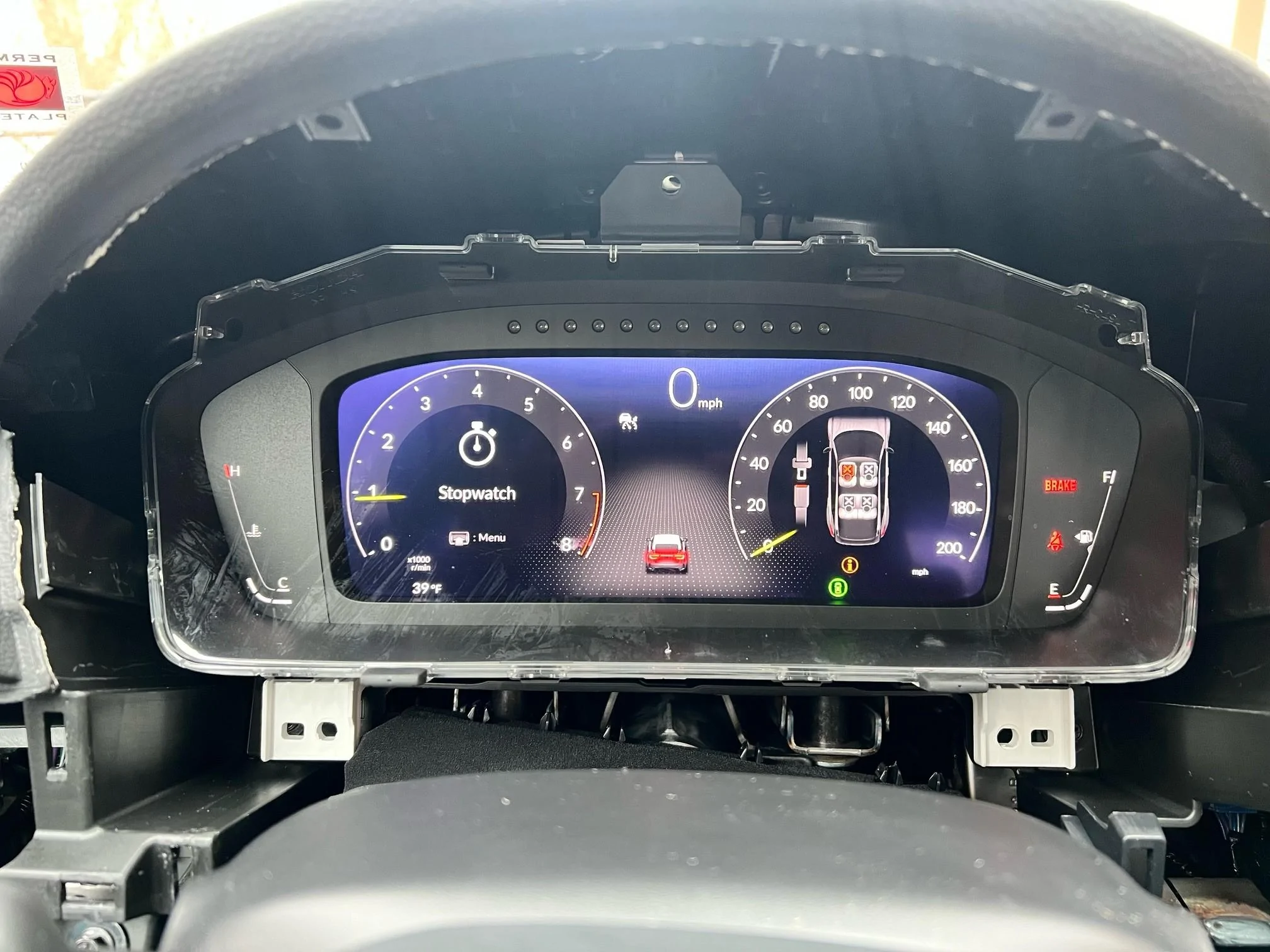

Now who wants to be the guinea pig to swap either a Canadian Si cluster or the new Integra cluster into a US Civic to get the full readouts and full digital? Just looked at one of the new Integra clusters to see what the difference really is and look at this. I just wonder if it's a plug and play like the old ones. I don't have a pic of a manual one yet, but I'll see if there is one around.

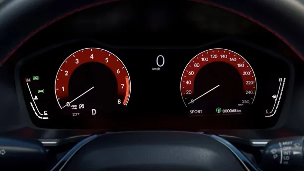

And here's the Canadian Si cluster. I think the bezel and mounting is different between the US Si and all the others.
11th Gen Honda Civic Cluster swap Honda_Civic_Si_technology_landscapeCard_TFTDisplay_deskto

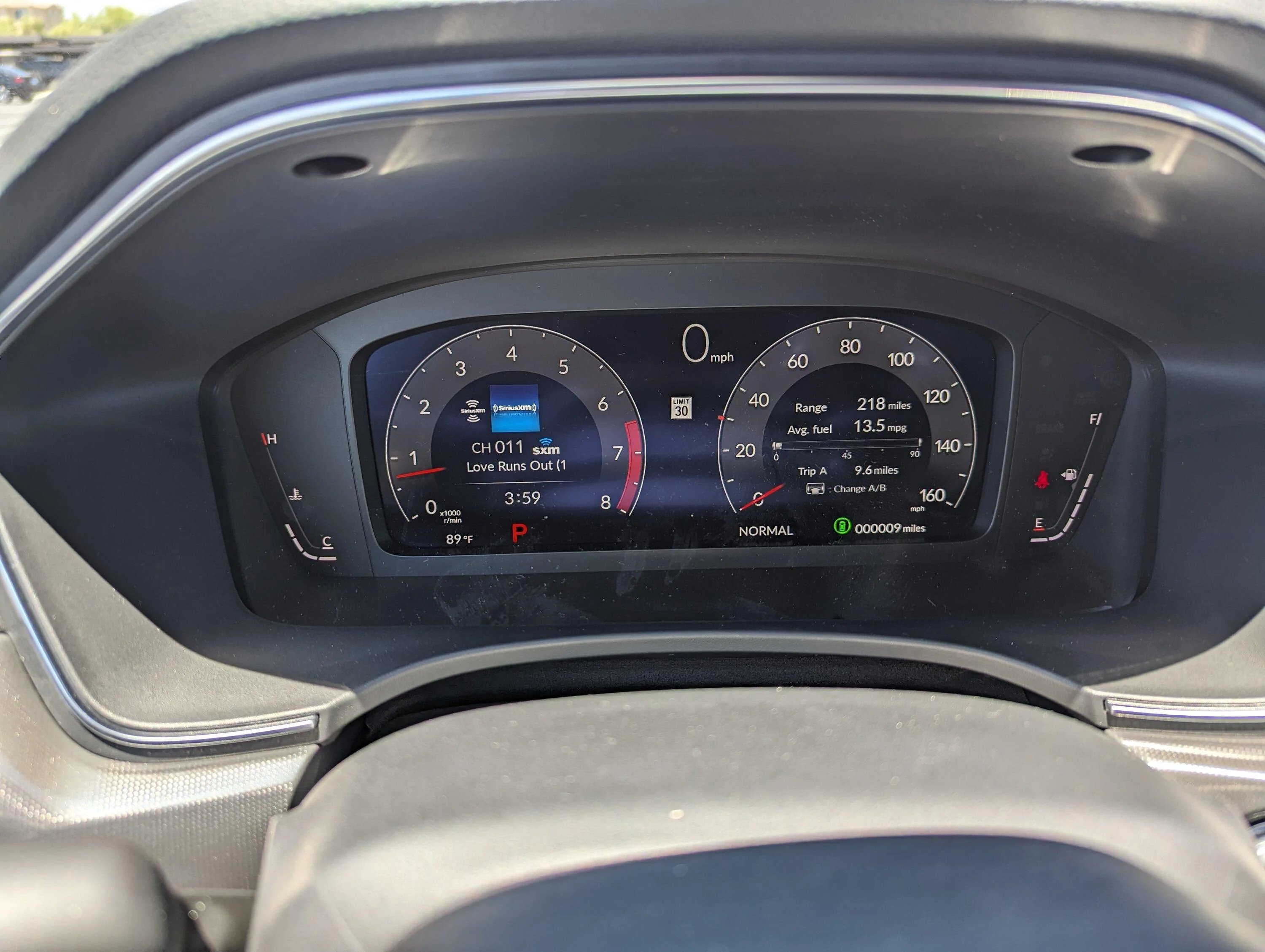

Hmm, maybe not so different after all. US dash.
11th Gen Honda Civic Cluster swap thumbnail_IMG_1308

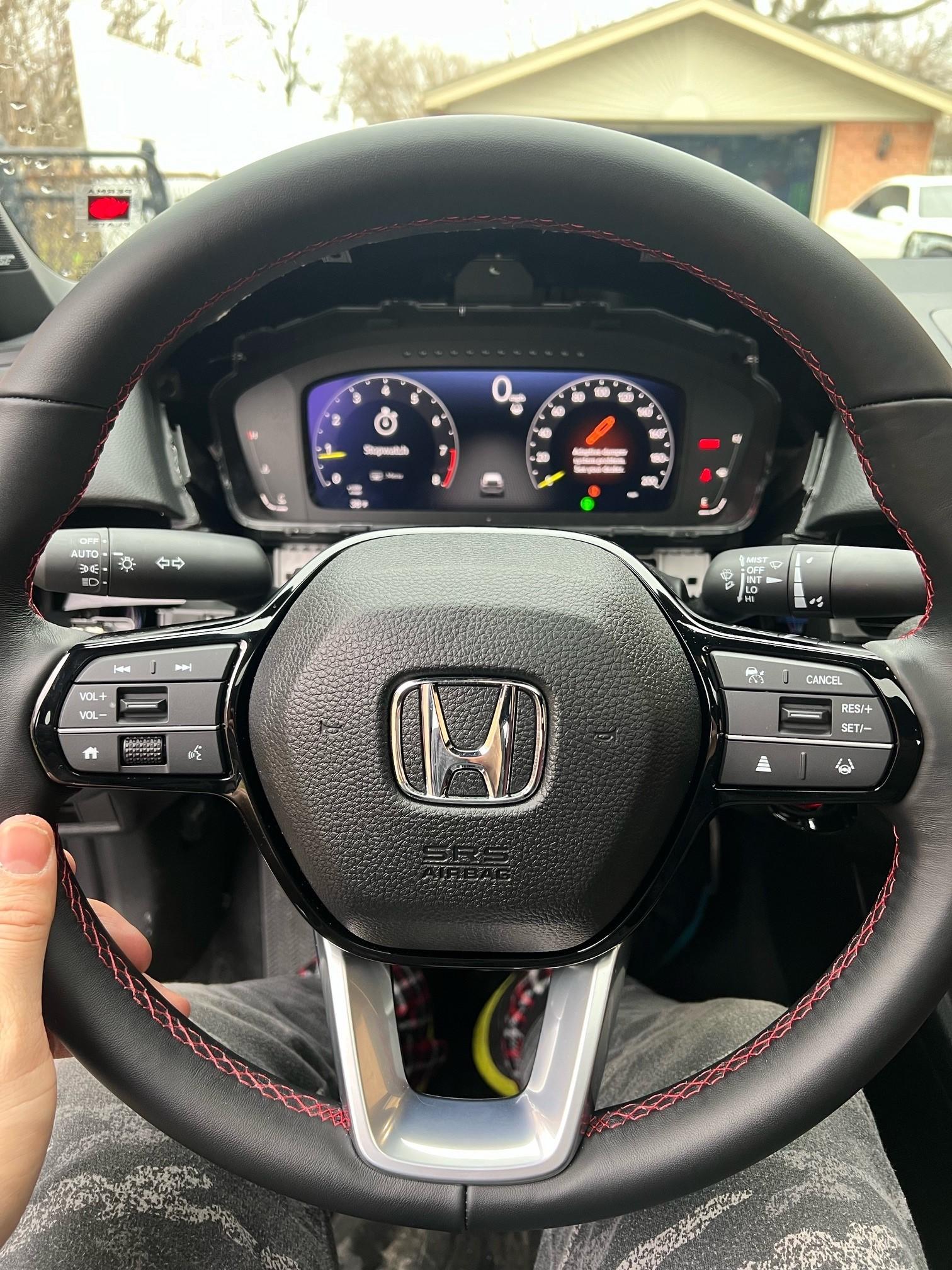

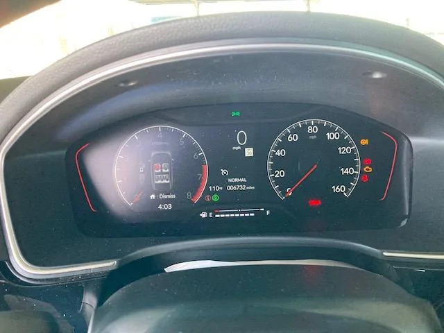

It has been bugging to know if a FL5 cluster works in a SI. I have a 2024, and I just plugged it in. Sadly, the damper message appears. I also cannot control the cluster because the steering wheel switches are different. I just purchased on Ebay a type-r wheel with the switches so that will be in by the end of week. Would be nice to be able to control the cluster.
11th Gen Honda Civic Cluster swap type r
11th Gen Honda Civic Cluster swap type r 2
