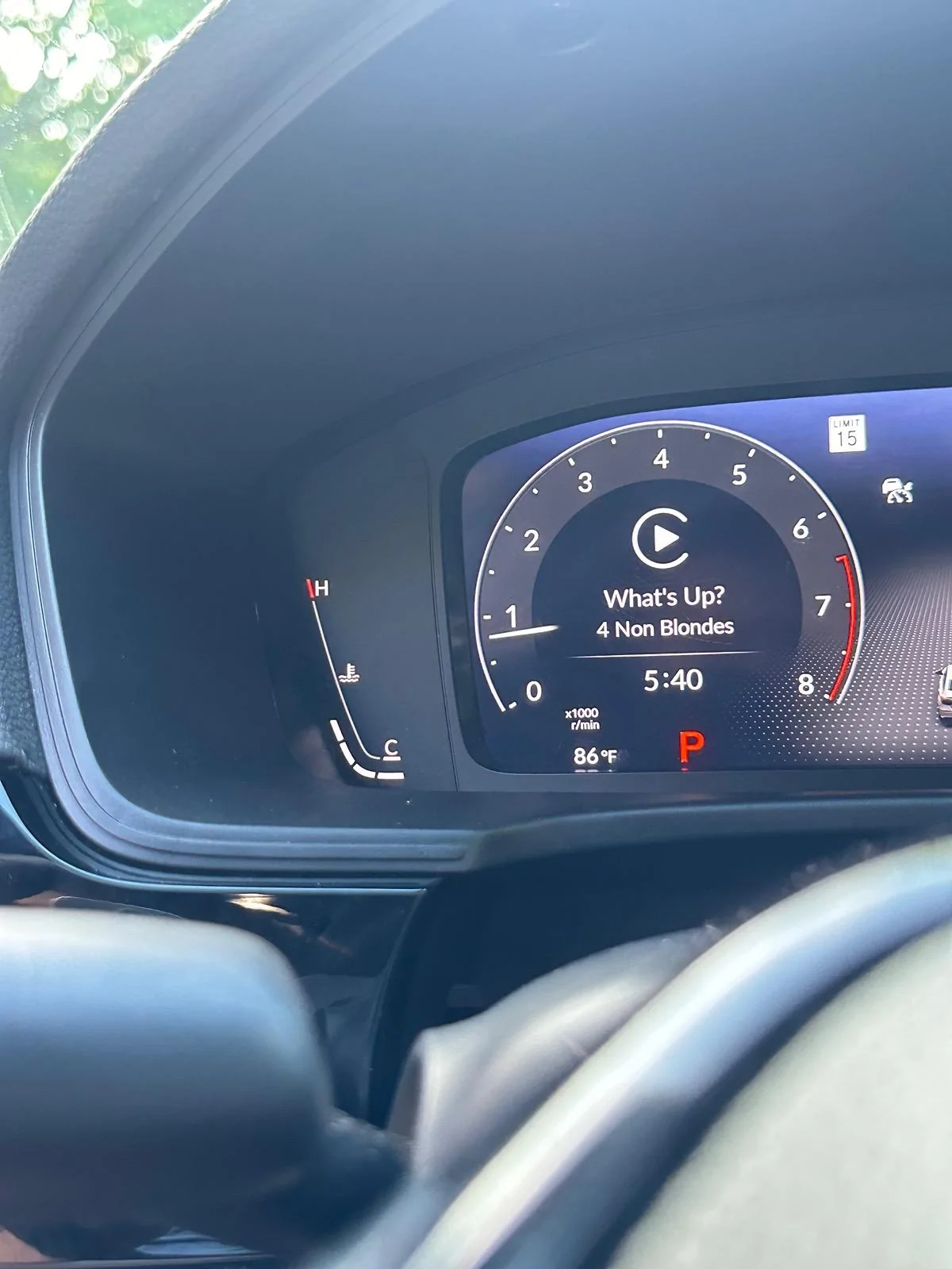

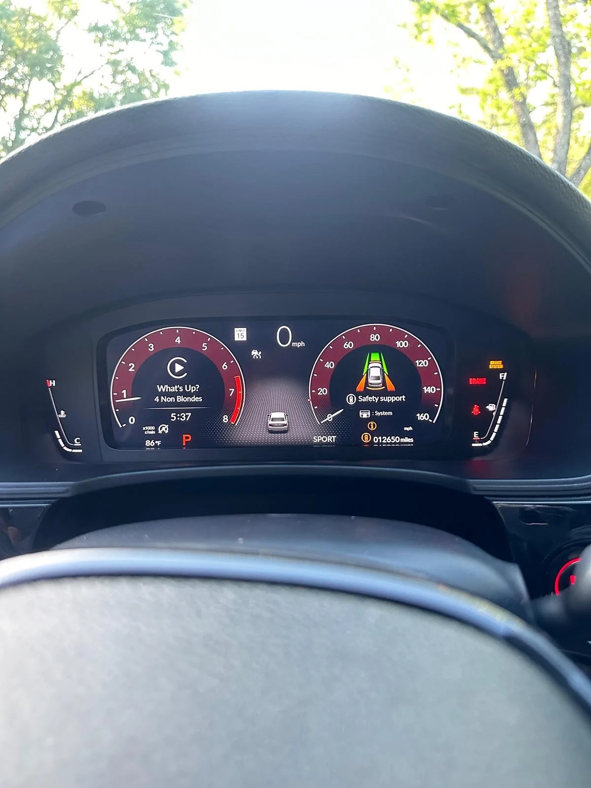

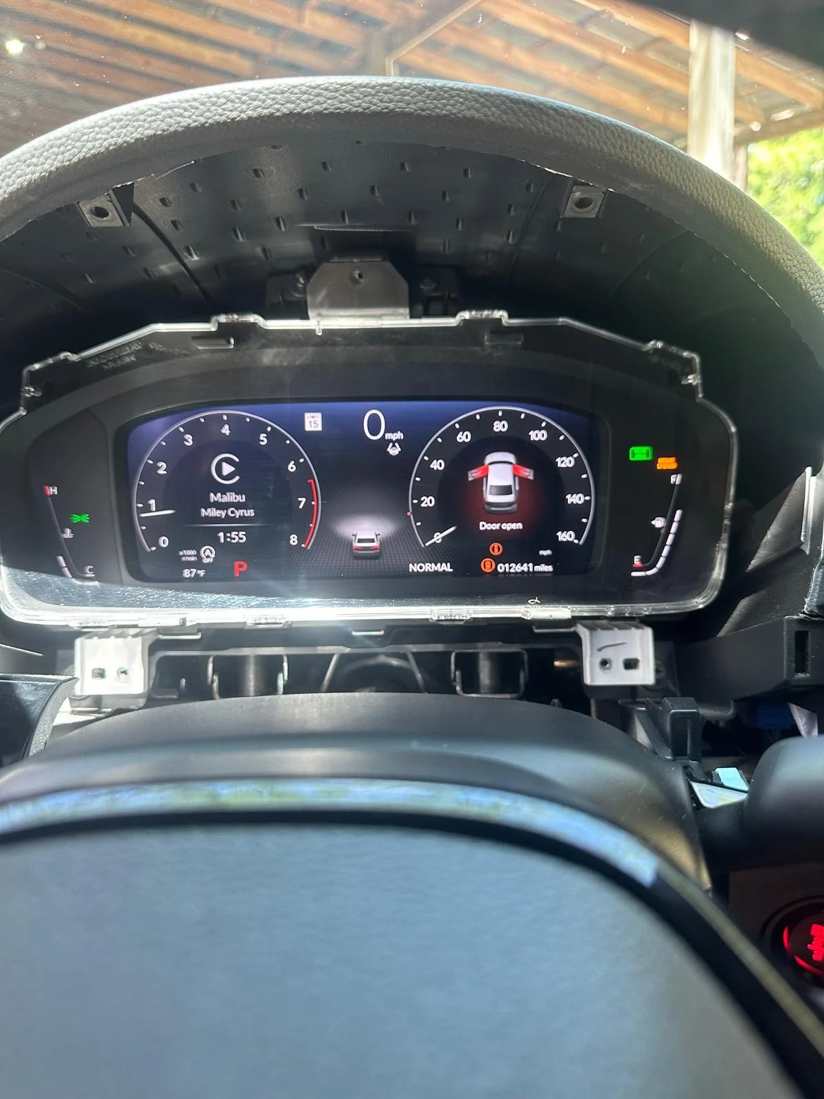

So, the Cluster and Steering wheel came in and i can only say wow! Everything works as it should!! I will add more pictures later! Coolant Temp works! Music information works! However you will get warning messages for Blind Spot fault, Low speed braking fault, Parking Sensor fault since the US Sport model is not equipped with these features! Those faults can easily be scrolled away and won’t pop up again for the rest of the drive! A touring Steering wheel (or controls) is required to control the Cluster! And yes i listen to Miley Cyrus, leave me alone Lol
11th Gen Honda Civic Civic Sport to Touring Gauge Cluster swap. IMG_1193
11th Gen Honda Civic Civic Sport to Touring Gauge Cluster swap. IMG_1194

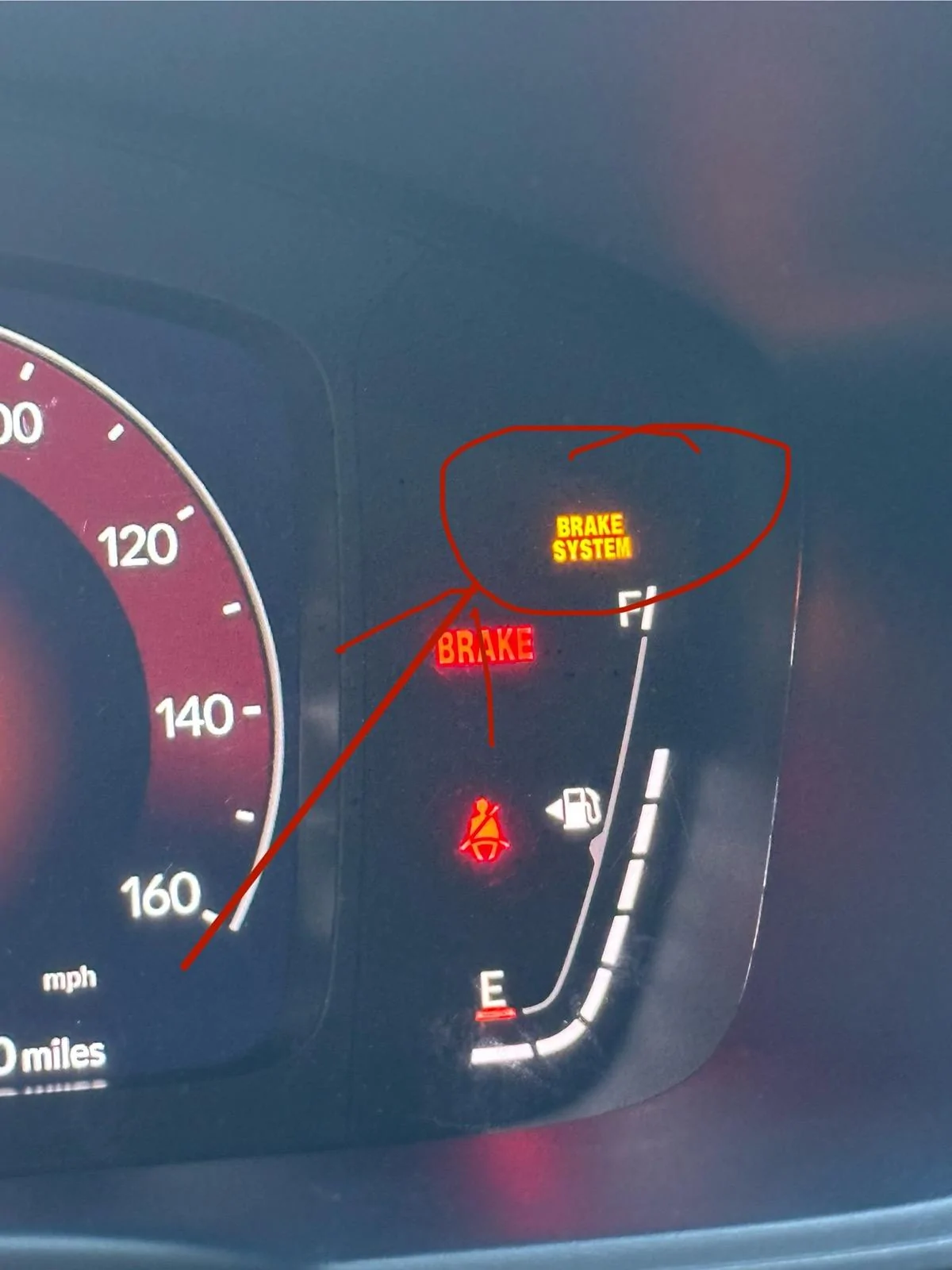

This light will stay illuminated because it thinks something is wrong with the Brake System
11th Gen Honda Civic Civic Sport to Touring Gauge Cluster swap. IMG_1198

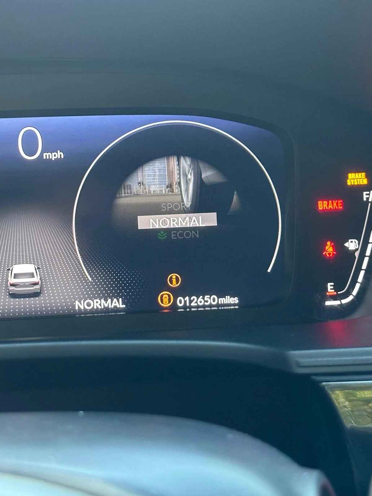

Mode selections Work as they should (Sport and Touring Models only)
11th Gen Honda Civic Civic Sport to Touring Gauge Cluster swap. IMG_1202

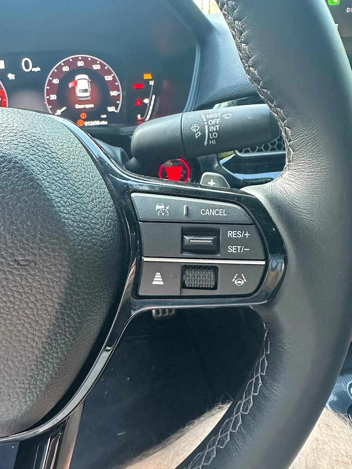

Touring steering wheel in action, i transferred over the Black trim at the bottom because i hate Chrome!
11th Gen Honda Civic Civic Sport to Touring Gauge Cluster swap. IMG_1200
11th Gen Honda Civic Civic Sport to Touring Gauge Cluster swap. IMG_1199

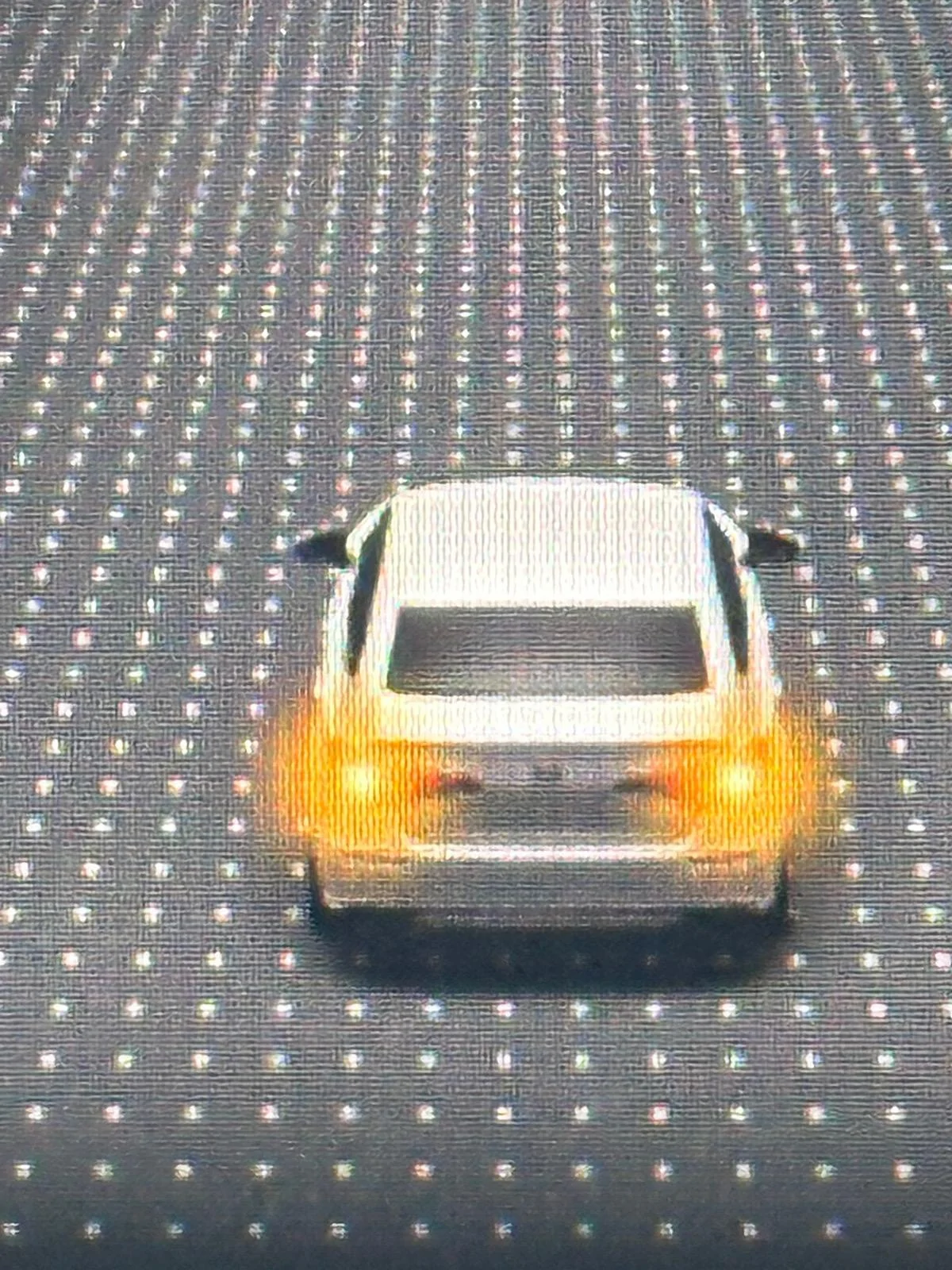

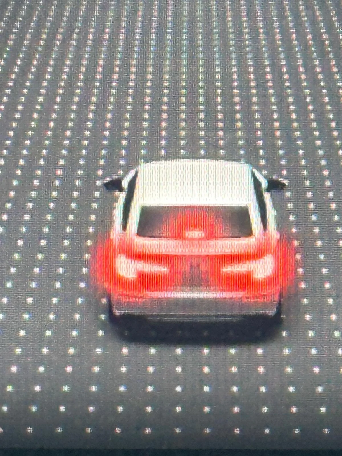

The animations work too! When cruise is enabled you will see the lines and other cars as well!
11th Gen Honda Civic Civic Sport to Touring Gauge Cluster swap. IMG_1204
11th Gen Honda Civic Civic Sport to Touring Gauge Cluster swap. IMG_1206

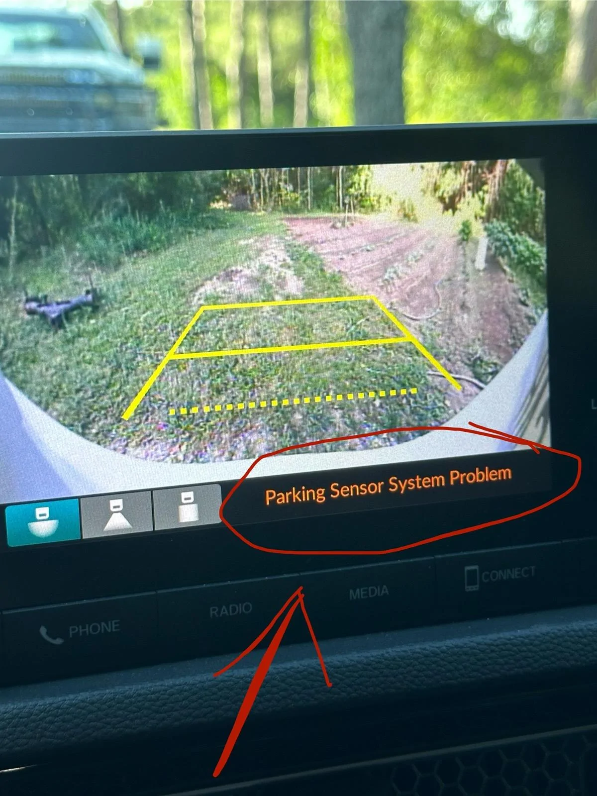

The Radio somehow thinks that there are Parking sensors and that theres a problem with them?! Interesting
11th Gen Honda Civic Civic Sport to Touring Gauge Cluster swap. IMG_1203

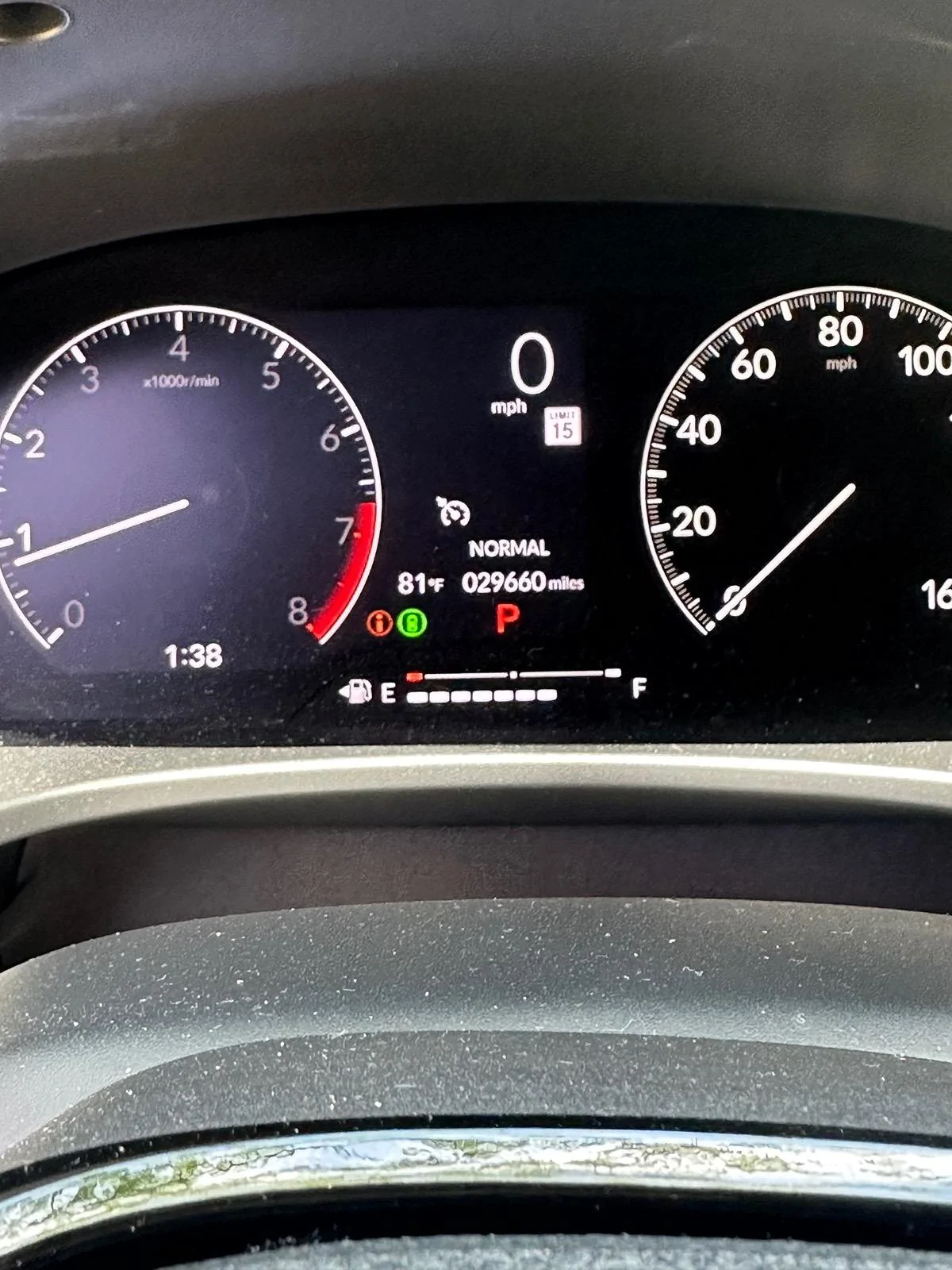

Did you ever get all the light programmed out and correct the odometer?
I actually went a little further, i bought a Acura Integra Base cluster which is actually more compatible with a Sport trim Civic. The touring cluster does not give you an option to change your Vehicle settings whereas the Integra Base cluster does! It also doesn’t look for parking sensors or Low speed braking! Some light remain and i have not yet sent it out to be reprogrammed.
