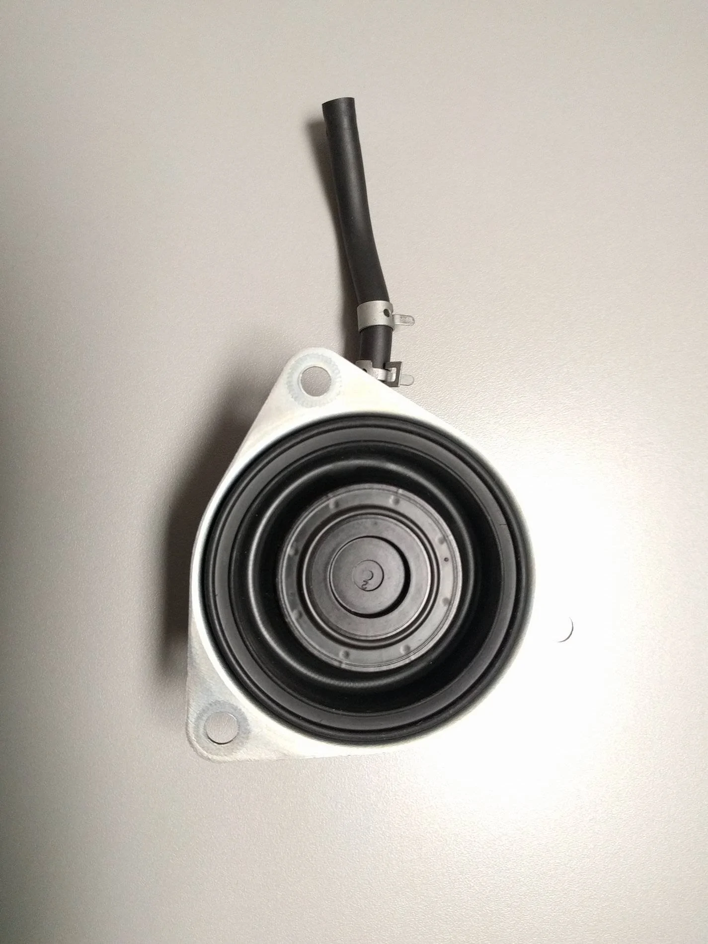

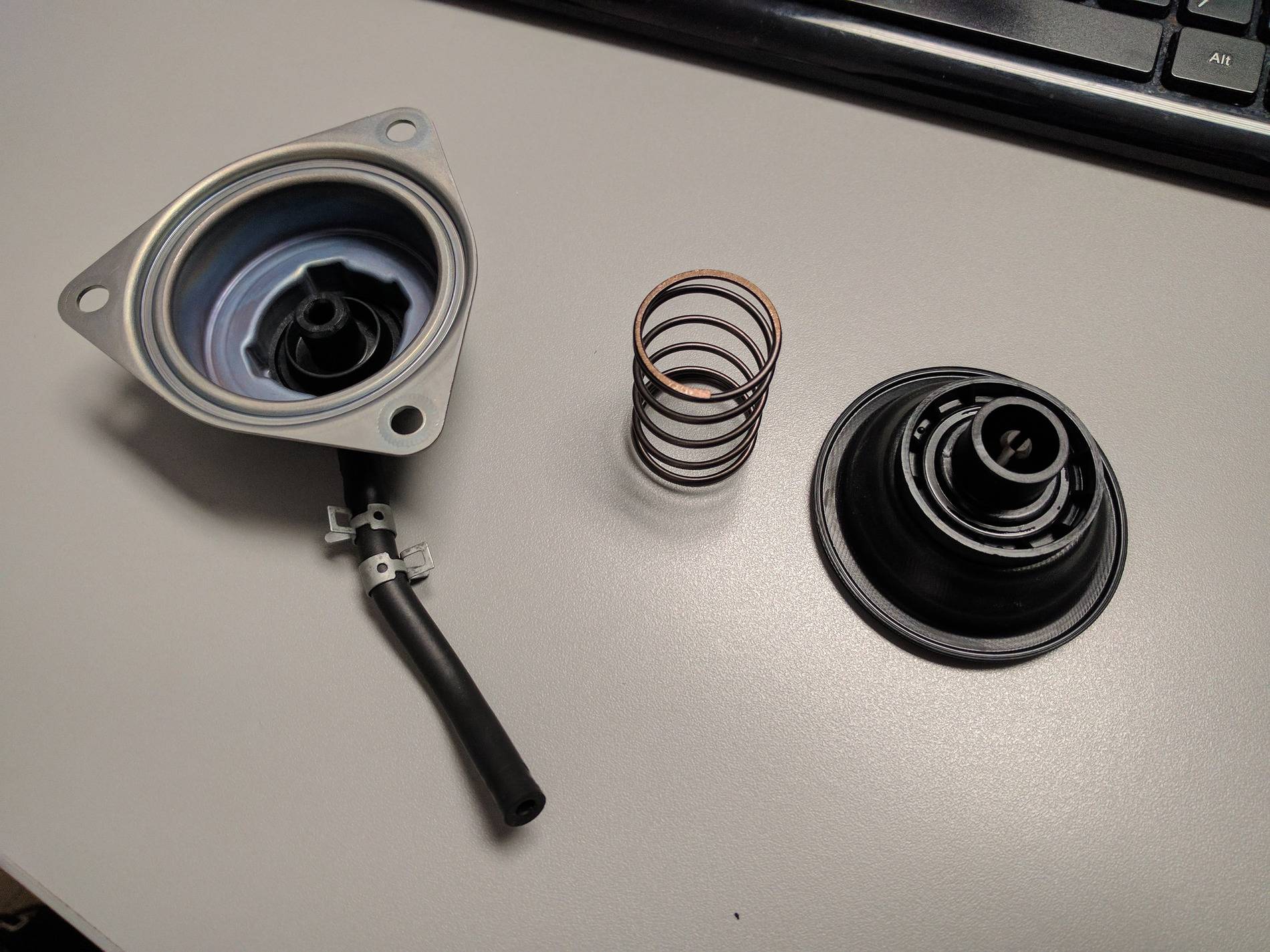

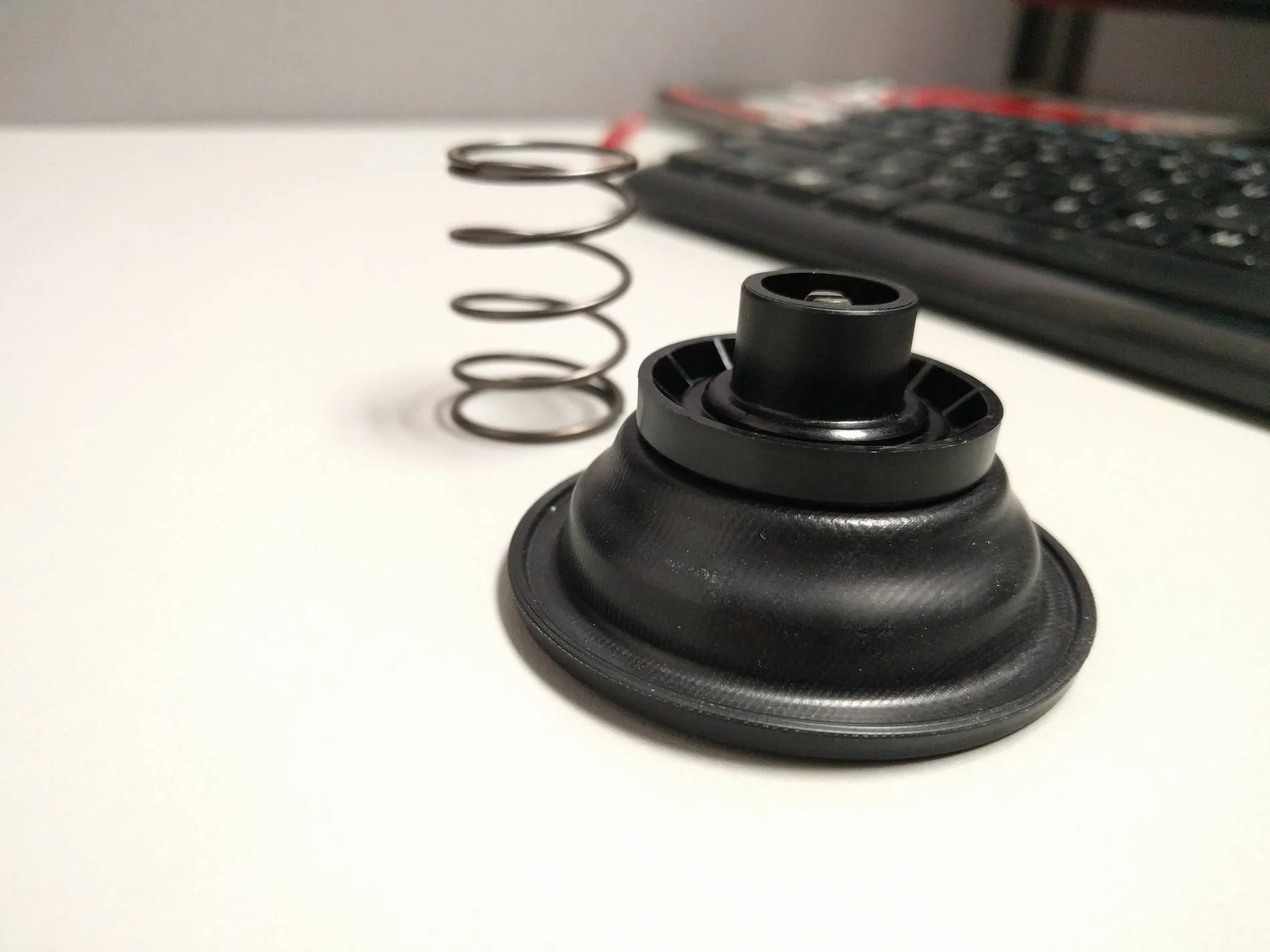

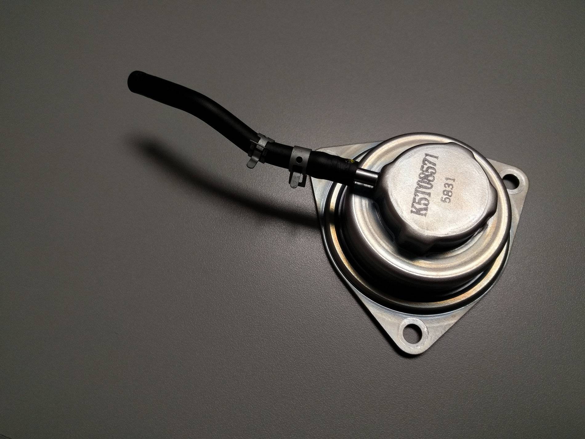

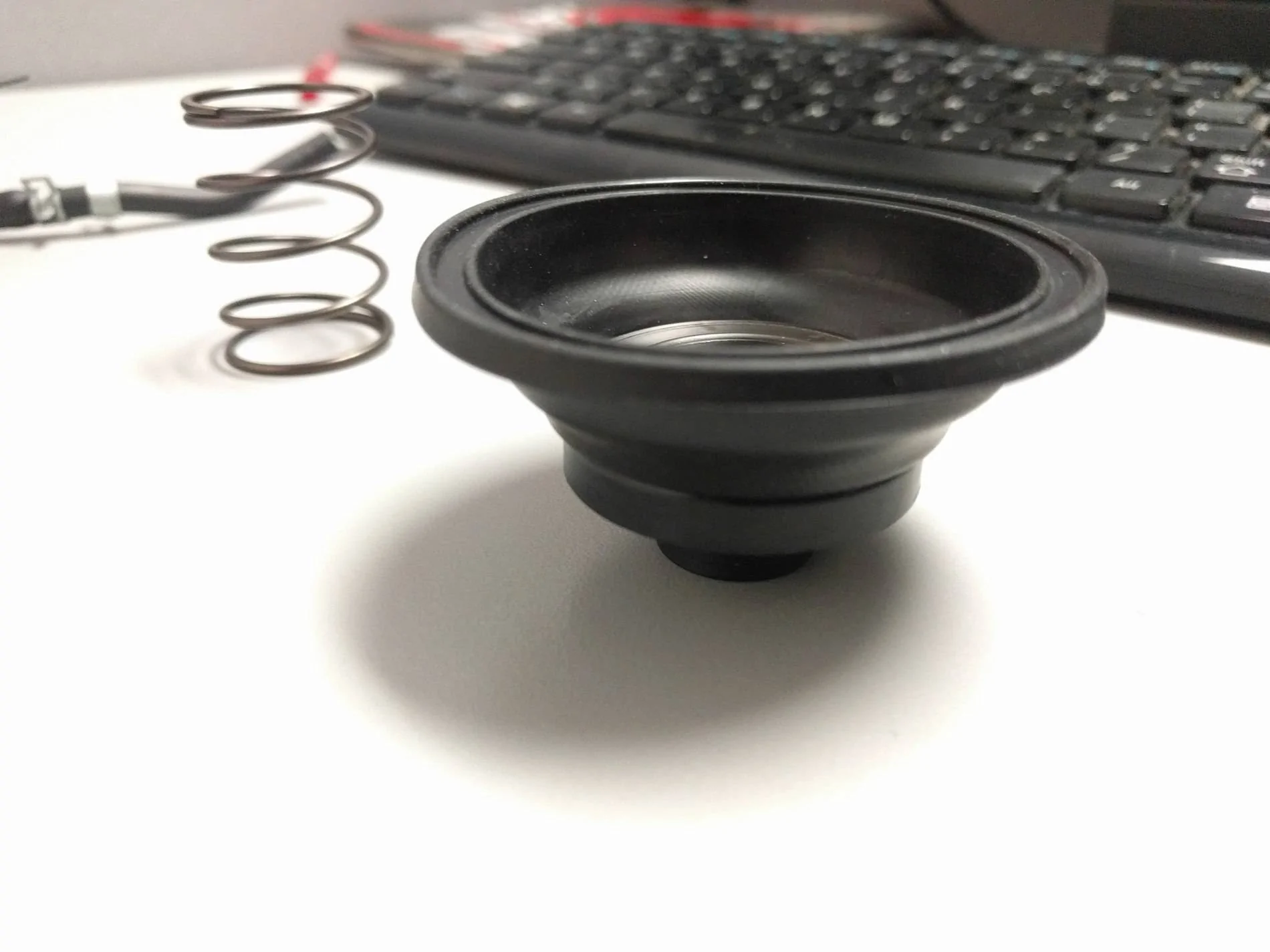

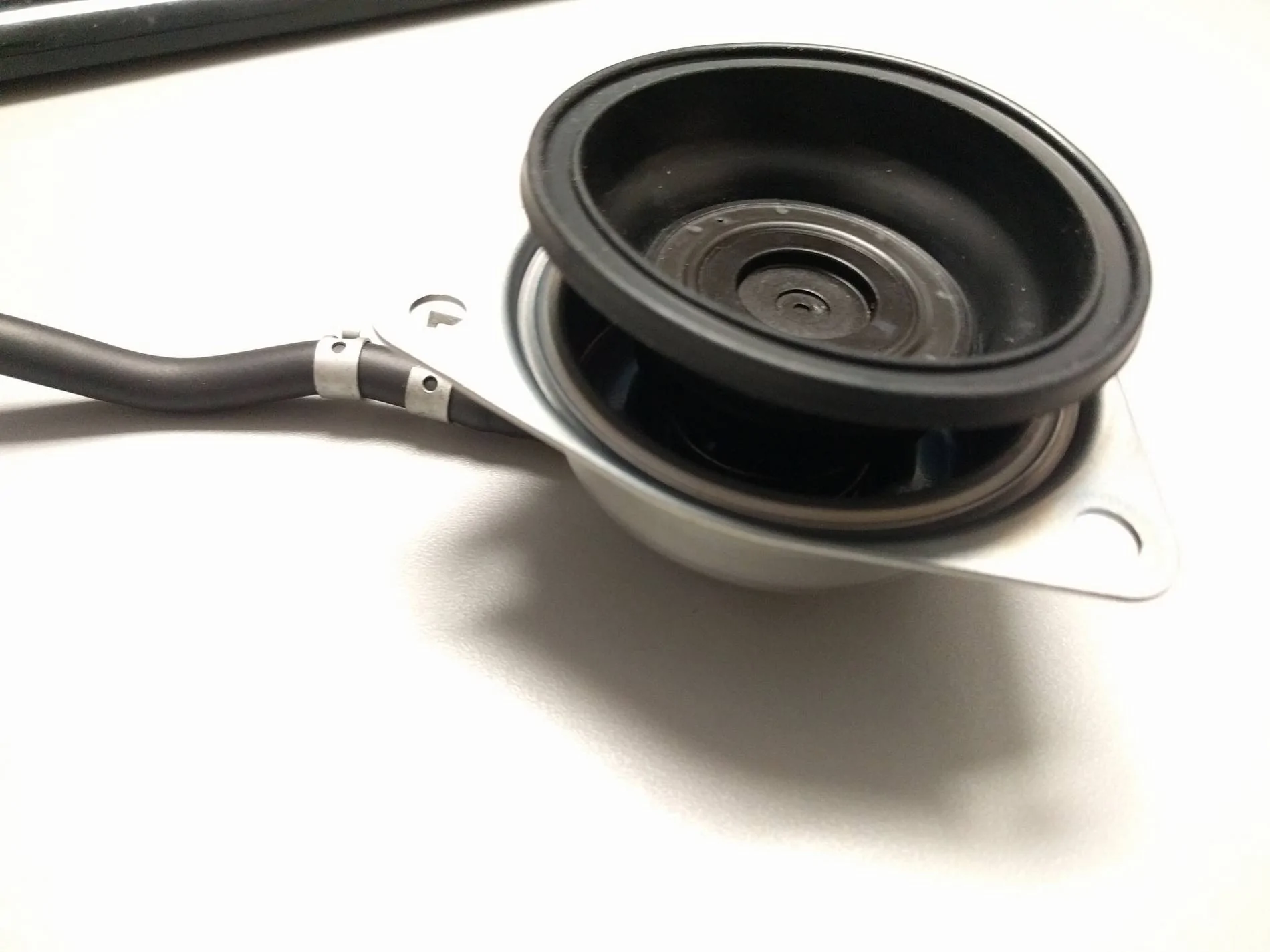

Just wanted to show you guys how weak and flimsy the stock BPV is. Made from rubber and plastic. Sure the exterior is metal, but get a look at the inside!

If I had to guess that rubber diaphragm was most likely designed to expand and retain a certain amount of pressure inside of the system, once the threshold was exceeded (probably pushing that spring past a mechanical limit) it would vent air back into the intake (releasing pressure and protecting the turbo turbine).
It wouldn't make sense to make that plastic tip out of titanium or carbon fiber, a spring's a spring (I mean unless it's made out of chinesium and didn't like, spring back after being compressed), and I can't imagine another material besides a rubber compound that would perform the same function. So please do make sure we understand what the function of each part is before dismissing it as simply being cheap and useless. Too often do we see aftermarket shops making parts with materials that are considered "better" on paper but end up being too brittle or more ductile than the OEM component it replaces, causing a premature or more catastrophic failure.
