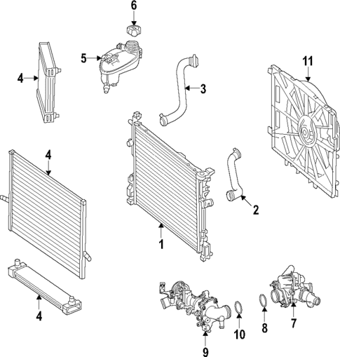

Increasing the capacity is just a band aide solution. It judt needs more heat exchangers imo. The CLA 45 has 3 times the coolant capacity because it has three radiators to our one.
11th Gen Honda Civic Any aftermarket bumpers with more airflow? 1718764994708-bi
https://www.mboemparts.com/v-2014-m...c--2-0l-l4-gas/cooling-system--cooling-system
Correct, I have one. Increasing fluid capacity by double and increasing rad size would undoubtedly help the R.
