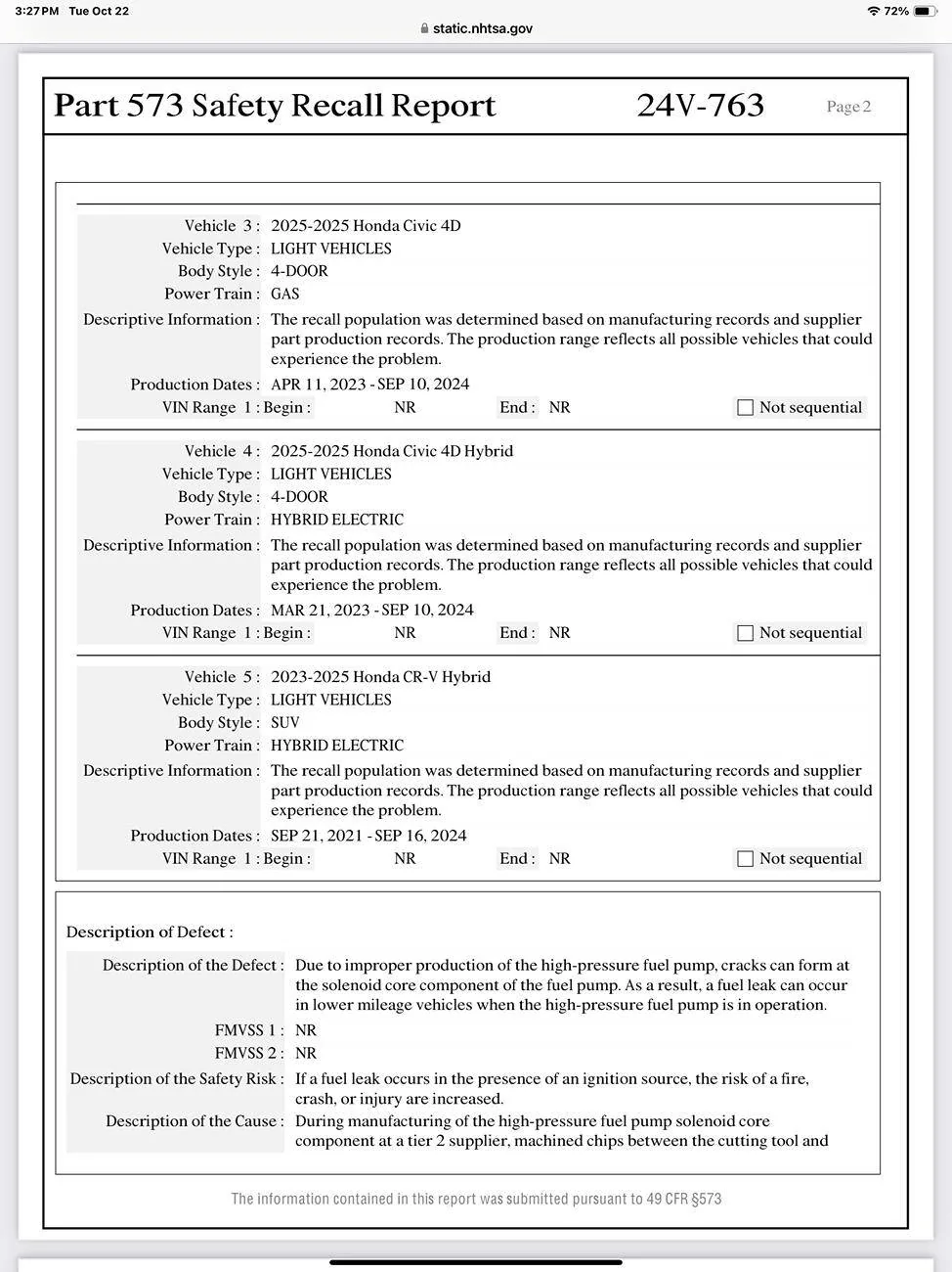

23-24 Accord
25 Civic Hybrid
23-25 CRV Hybrid
Its mostly for Hybrid models.
It says Civic sedan and sedan hybrid. Sounds like all ‘25’s to me.
