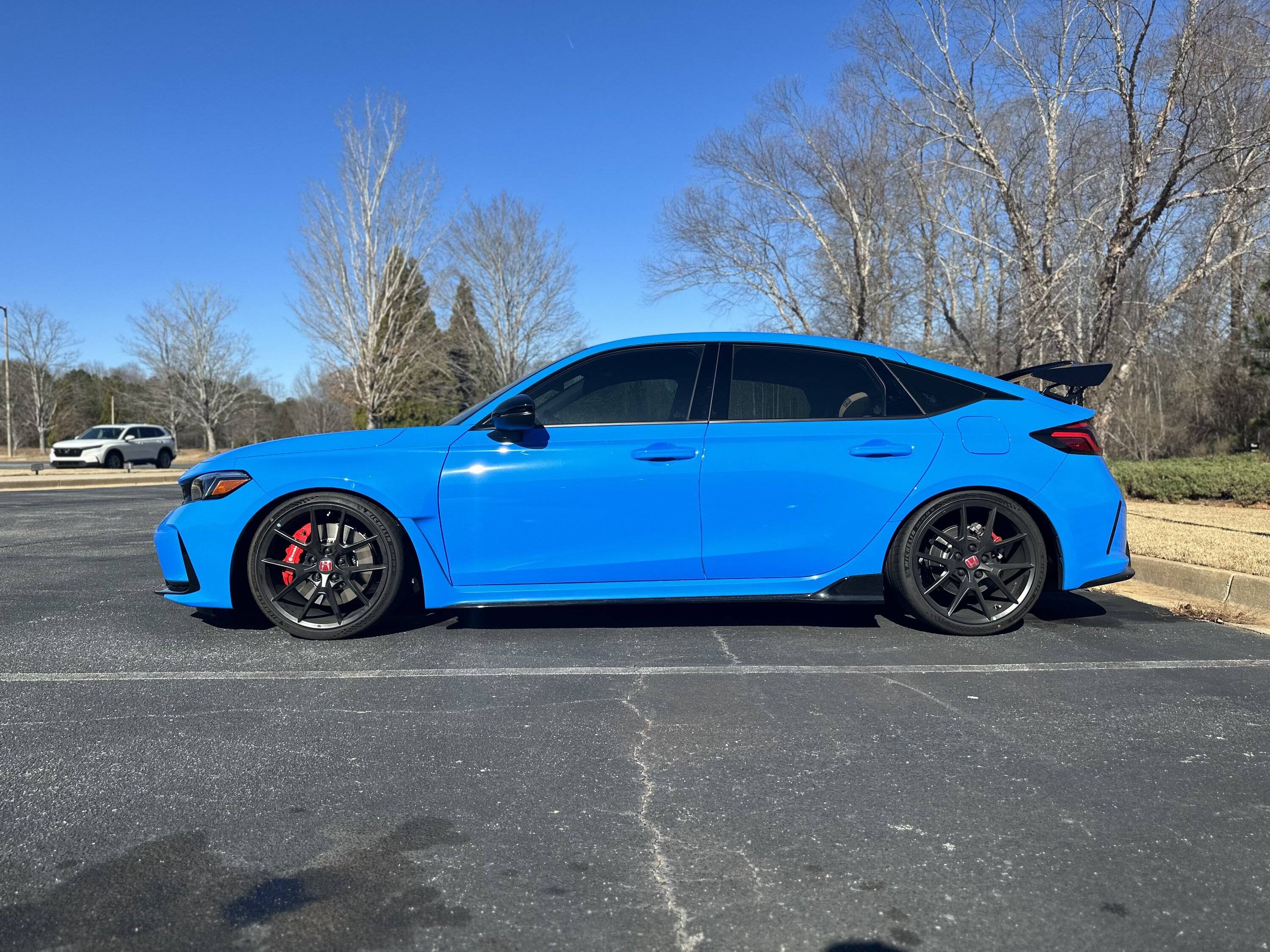

SimplyClean
SimplyClean
Jan 25, 2022
81
193
Atlanta
2023 Boost Blue Civic Type R #647
still have to advertise my Eibach Sportline on Craigslist ... then probably going with Swift or Spoon ...
EDIT: maybe even keep stock for a while, but the only thing is I'll have take off the 20mm spacers, it actually make the fender / wheel gap looks bigger when tires are flush with the fenders/quarters. I think without the spacers the fenders/quarters will cast a shadow, and thus gap will not look as prominent ... or is it just me not know what the F I'm talking about :crazy:
11th Gen Honda Civic Aftermarket Springs Thread ACE269E3-7DD6-48CF-A335-911B5B64A594
Swift springs and no spacers.
