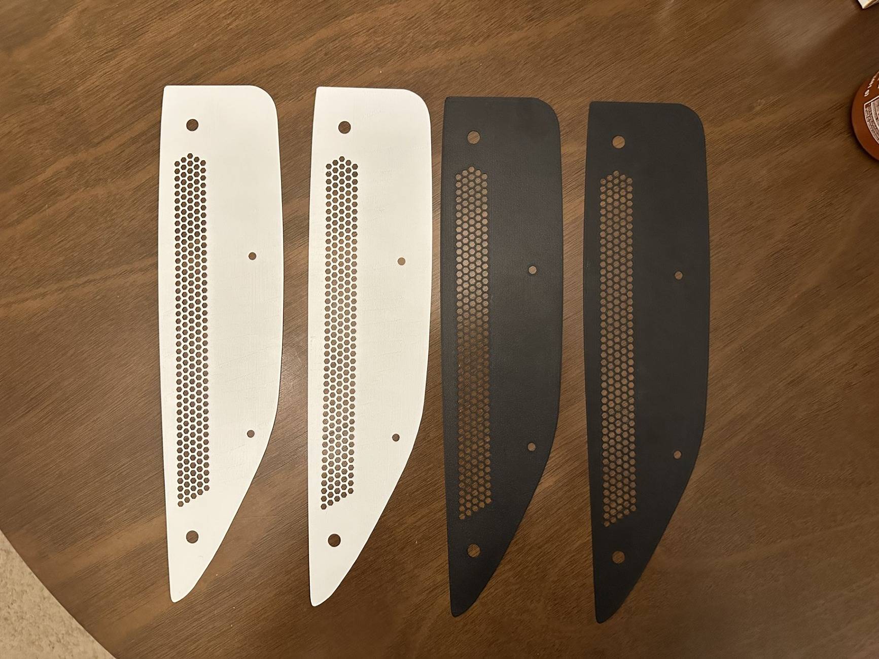

Don't want to pay $70+ for a part that is meant to take damage, so decided to make my own. After many revisions and tests, finally installed my 3D printed ones on my FL5. I'd like to share some thoughts on how to get the best print.

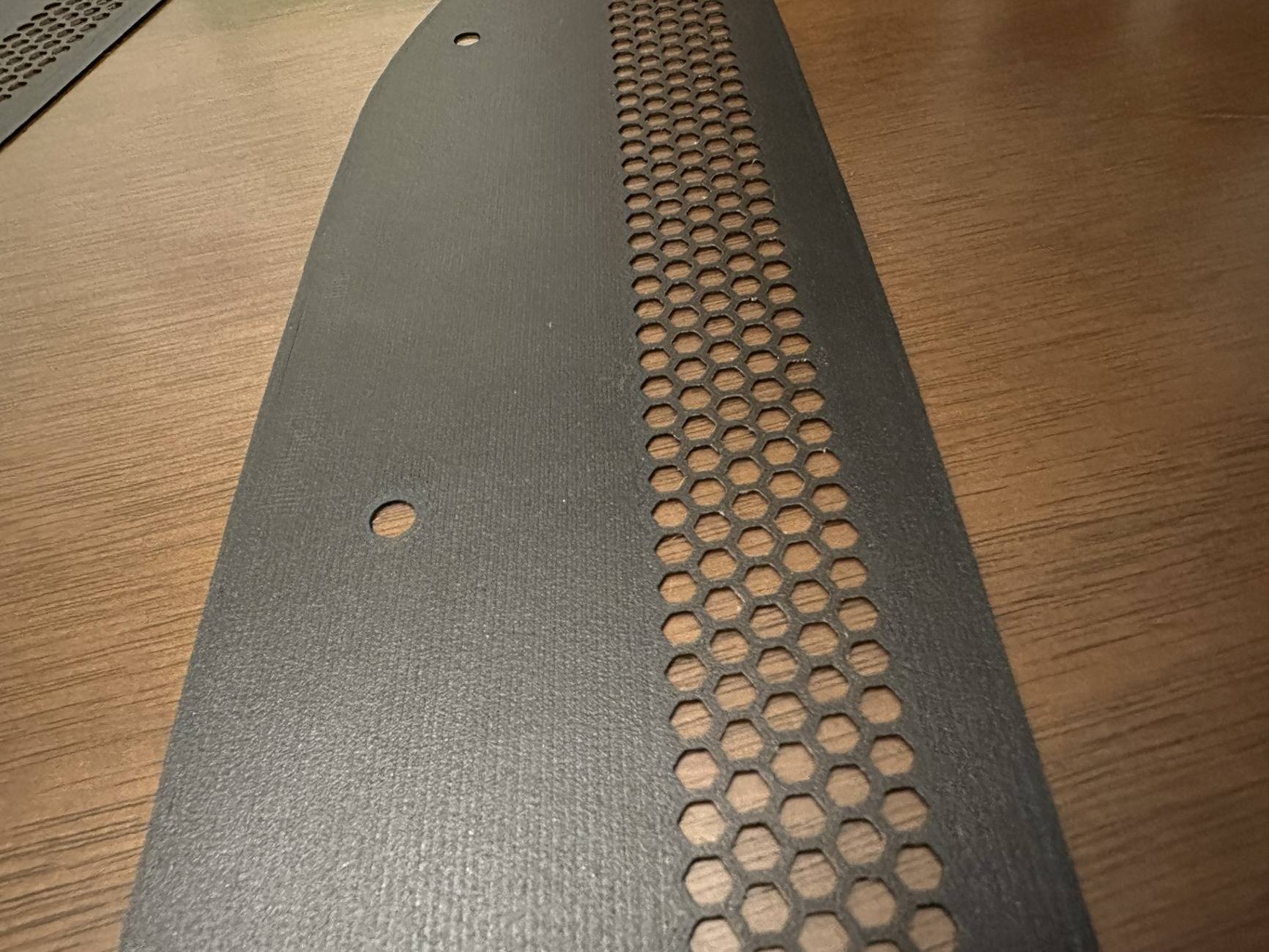

First of all, I used a paper and pencil to trace the outline of the finder vent, scanned it, then modeled it in Solidworks. I used hexagonal grids with 83% air flow area.
11th Gen Honda Civic 3D printed fender rock guard installed on FL5 fender_guard
Printed out on my 3D printer with build-area of 300mm x 300mm. 4 mm nozzle size - first layer thickness of 5 mm. Since it's not really a "3D" print but rather a large area 2D sheet, you want to slow the print speed of the first layer down to ensure good adhesion to he build plate and between lines - I used 20 mm/s and 0.1 mm height for the first layer. The print turns out to be pretty good, both in strength and cosmetically.
Material used is PETG, for weather and environment resistance. Do not use PLA, it won't survive outdoor use (I've tried it).

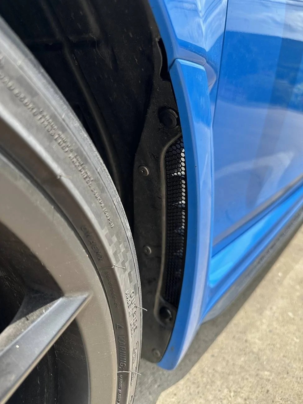

Picture of the installed rock guard:
