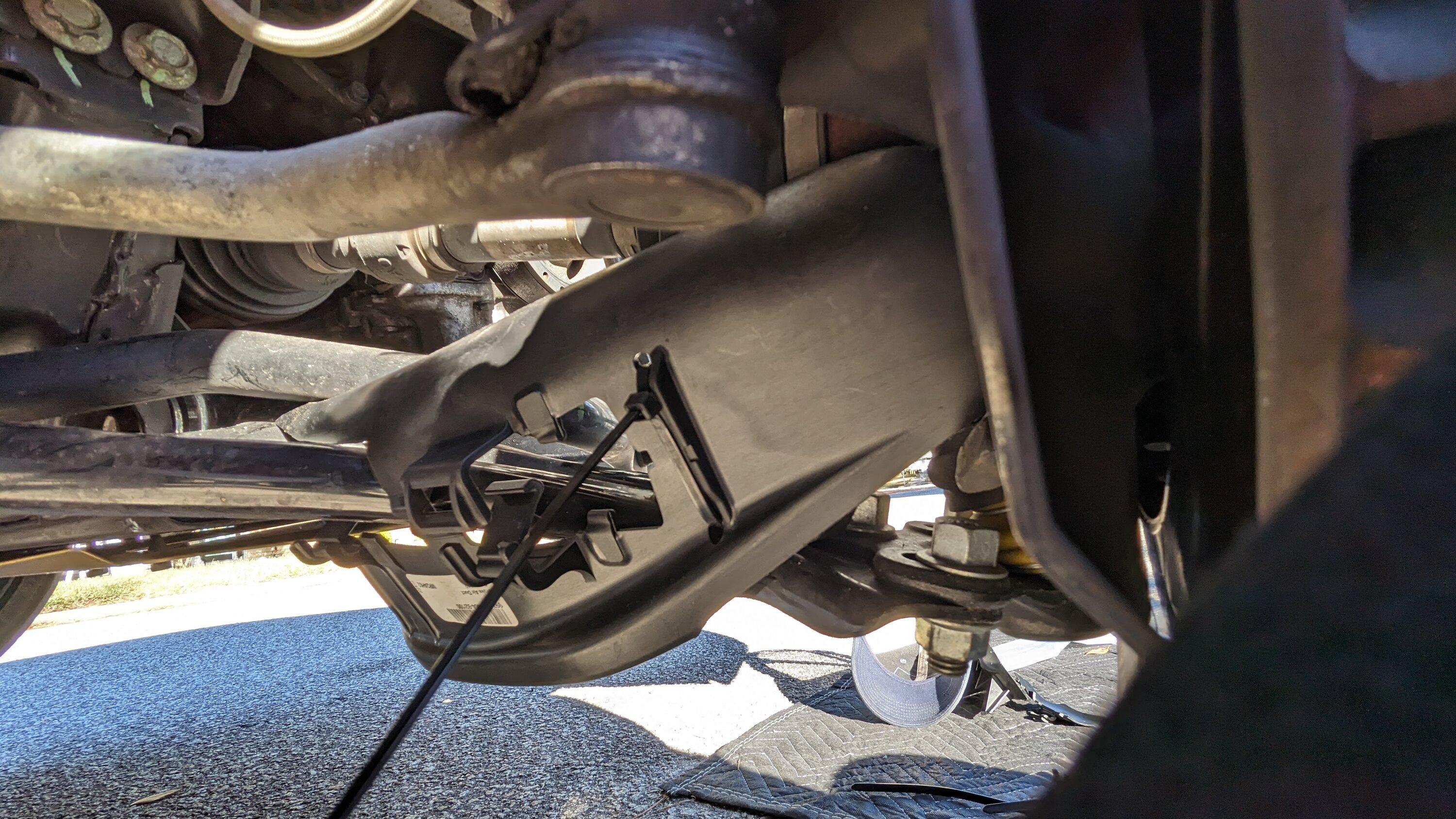

Tried out the rs3 on my 10th gen si because of this thread. Thanks for the inspiration!
11th Gen Honda Civic $300 Small Brake Kit, Audi RS3 Brake Ducts and ARP Wheel Studs PXL_20231218_185014774
I didn't want to trim that much and didn't care for it aiming at the rotor
Tried gt3 ducts and got what's hopefully a better fit. They're aimed at the hubs at least ?
11th Gen Honda Civic $300 Small Brake Kit, Audi RS3 Brake Ducts and ARP Wheel Studs PXL_20231218_193815157
11th Gen Honda Civic $300 Small Brake Kit, Audi RS3 Brake Ducts and ARP Wheel Studs PXL_20231218_193733746
Hopefully they work
