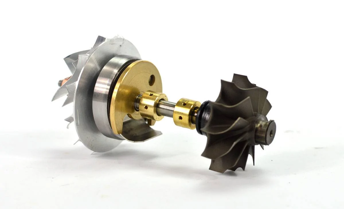

You guys put out a lot of teaser shots in your part 1 and 2 .. if people are paying attention they can see what your new turbo might be using for turbine and compressor wheels. ;) Looks like you have stuffed TD03 parts into this design and going with a larger Exhaust Turbine wheel but using 11 blades to keep the spool time somewhat reasonable:hmm:
Now this is purely a guess but if I was a betting man I would have a stab at saying your compressor wheel is in the 41mm +~-Inducer and 51mm +~- Exducer and your Turbine wheel is in the 40mm Exducer +~- and 35mm Inducer +~- range....:coffee:
Now if your pricing will be comparable to a Upgraded TD025 then you guys might have a nice upgrade on your hands that should sell very well:thumbsup: Looking forward to see more on this turbo on the 13th of April:hmm:
Pretty good man. There are some teasers and you are in the ballpark, but we will def be releasing more info as we come along.
