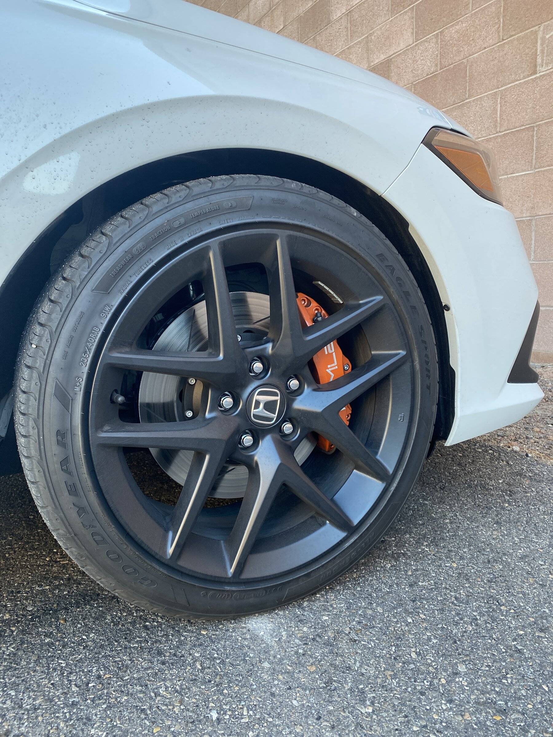

How about brake upgrades, the Si is itching for some brake upgrades - anything from a BBK to even some pads ?
I agree with @zeroptzero brakes for sure.
Oh you guys beat me to one of my first post. ?
a taste of what is to come.

Did you have to use spacers behind the oem wheels to fit the BBK?
If so, what MM?
Thx
Yes, currently on 25mm with studs in the spacer. If you switch to extended studs you can get away with like 10mm or less. I have new wheels going on this weekend so will take more pics and update then as well.
