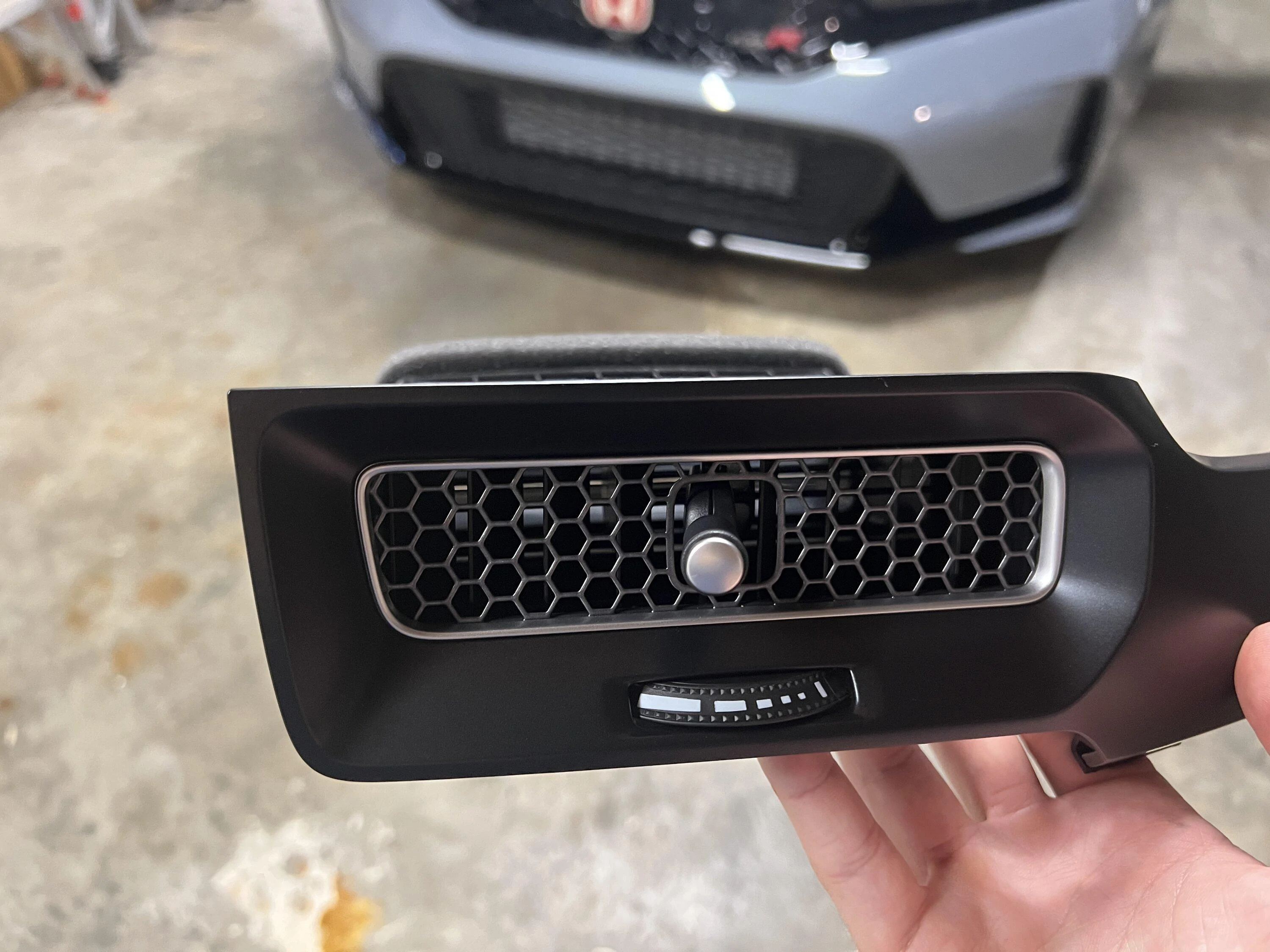

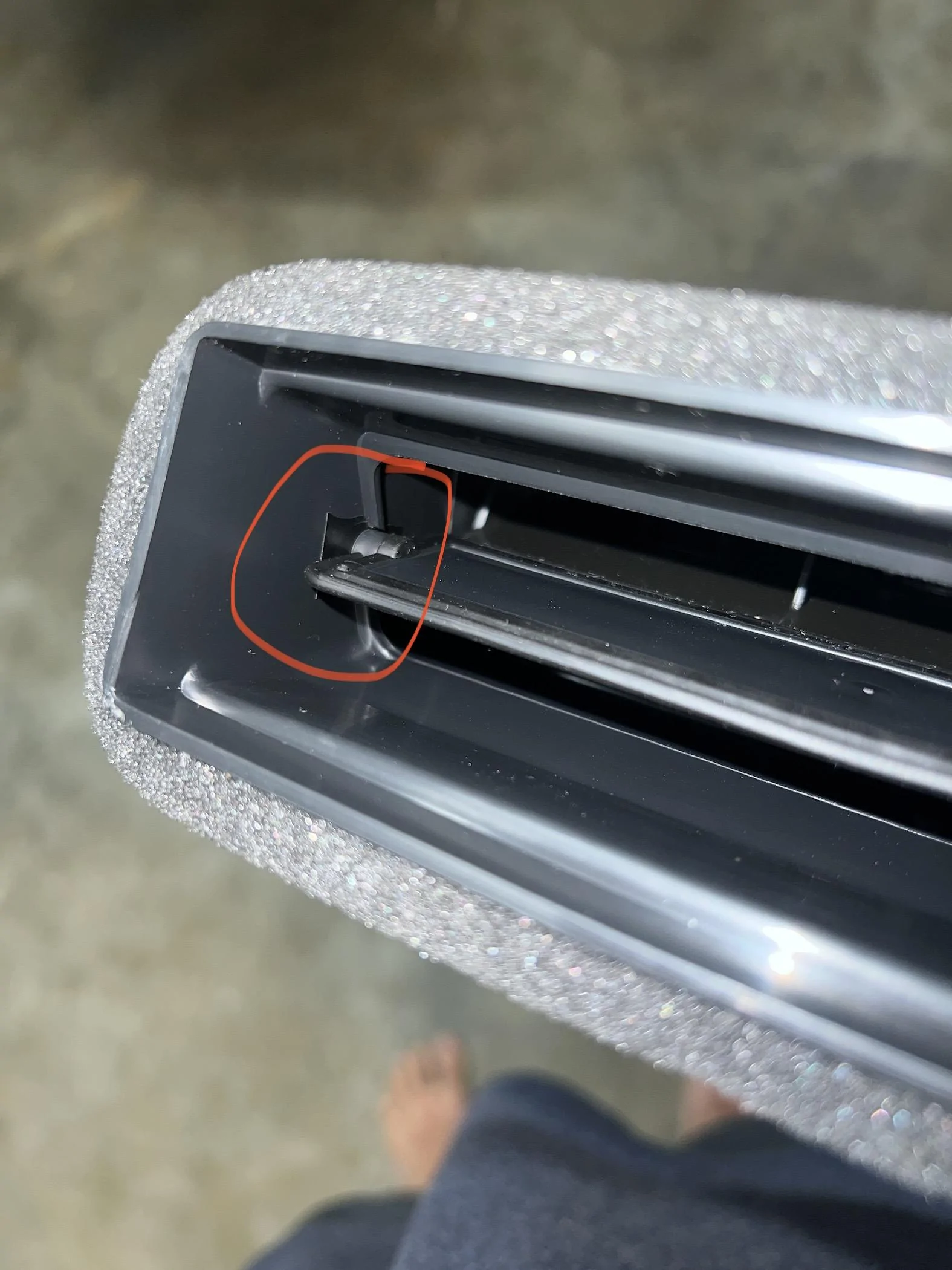

I realize this is an older post, but ive had a rattle on the driver side air vent since I bought my car in May. Sometimes closing the vent will fix it and sometimes it doesnt.
I finally got around to ripping apart the interior, and I think I may have located and fixed the rattle. It is coming from the little flapper that opens and closes the airflow, and where it slots into the side of the housing of the duct. Its a loose plastic on plastic fitting and I think its where the rattle is coming from.
I removed the "flapper", put a piece of electrical tape inside the duct over the hole, and then reinstalled the flapper and it punched through the tape, essentially putting a layer of tape inside the hole which should sit between the two pieces of plastic and stop the rattle.
If that doesnt make any sense hopefully the pictures make it clear..

Thanks for posting this! I just did this while I had the driver's side vent out and the flapper is now solid.

Thanks for posting this. Is it easy to remove the vent?
