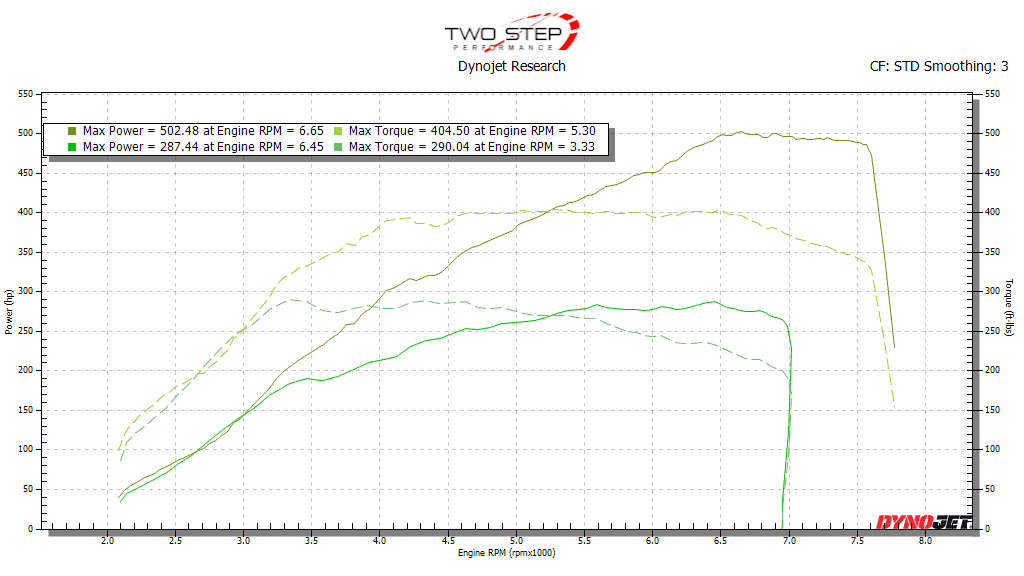

I will begin with a dyno plot that shows our testing of our unmodified FL5, vs how the car is today:
11th Gen Honda Civic TSP FL5 - 502whp and counting [2023 Honda Civic Type R Tuned & Modified] 7437d588-c72d-4df4-be0c-bee223a485d8
This represents the stock car using the factory tune with 93 octane compared to our FL5 with an @RV6 R660 Turbocharger and E30 custom calibration by @drobimw

Ok besides what you listed that dont make hp...what were the three things that gave you the most power gains? Turbo,(air),tune, and what the security screws on the spoiler?lololololol
Two Step Performance
Apr 24, 2018
45
918
1,326
twostepperformance.com
2023 Type R
The turbocharger is the biggest power adder by far. The downpipe and intercooler are important supporting mods. With those in place with solid custom tune you are going to easily make 420+ whp on 93, maybe more depending on the fuel system. From there you can use the Hondata fuel system to add more capacity to the system and then begin using an ethanol blend. With E30 we were able to take it past 500whp.

Can the Hondata fuel system support full E85 ? I'm lazy and don't got time to be blending ethanol at the gas station ?
Apr 24, 2018
45
918
1,326
2023 Type R
Our limiting factor at 502whp was fuel system capacity. I am sure the system can handle E85 but it is likely going to limit your gains elsewhere.

This is my first turbo car. When you upgrade the turbo for the big power gains, I assume the tradeoff is that it takes longer to spool so you miss a lot of that low/mid range in exchange for much more pull at full boost? Is that correct?
One of the things I really enjoy about the CTR is the low end torque and ability to put you back in your seat and explode out of corners. Is this something you won't get with a bigger turbo?
ne_typer
Feb 10, 2023
63
61
Massachusetts
BB FL5
This appears to make as much torque as the stock motor everywhere, which is why it's so cool.
Nearly identical spool time too. That torque in the midrange all the way til 7000rpm must feel real nice.

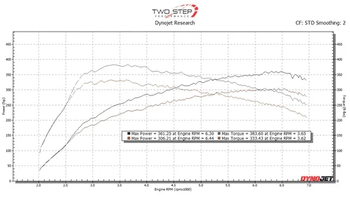

This is a great point but I will share something here... keep in mind this is an unmodified FL5 vs where it is today.
If you modify the car with the stock turbo, such as using our TSP Stage 1 Tune for the FL5, there is a large spike of low end / mid range torque available. However, we much prefer the extra horsepower up top.
11th Gen Honda Civic TSP FL5 - 502whp and counting [2023 Honda Civic Type R Tuned & Modified] 1687986341639
This chart shows a basic bolt on car (downpipe, exhaust, drop in air filter) with the factory tune vs our TSP Stage 1 Tune.
