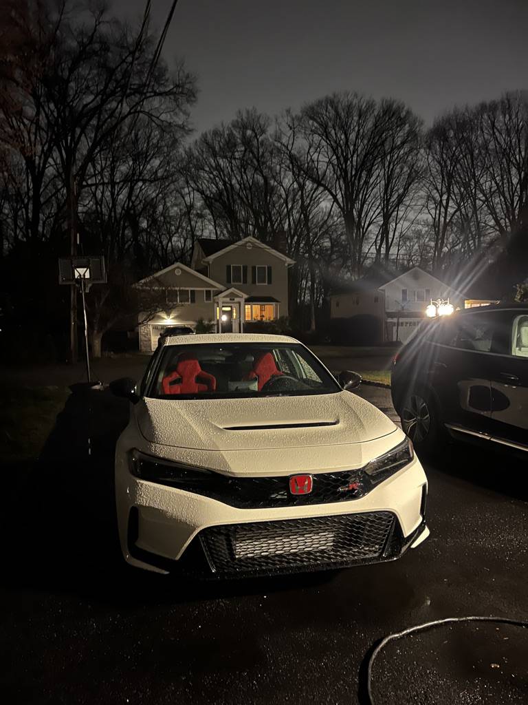

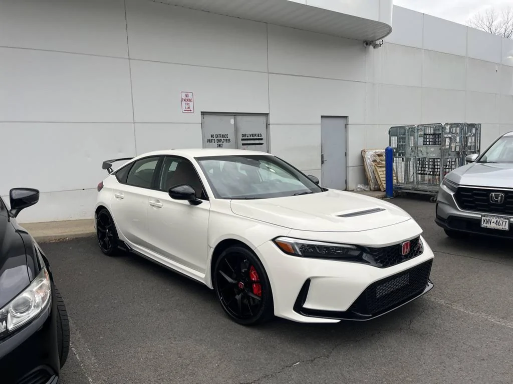

Picked up a brand new '25 Type R on 3/28/25 Friday.
I've owned a GPW '06 S2000 for about 17 years so far and I've finally bought my hero this year.
For now, I'll be applying PPF by myself (7 years of experience) and share photos of my car in this page.
Thx for stopping by.

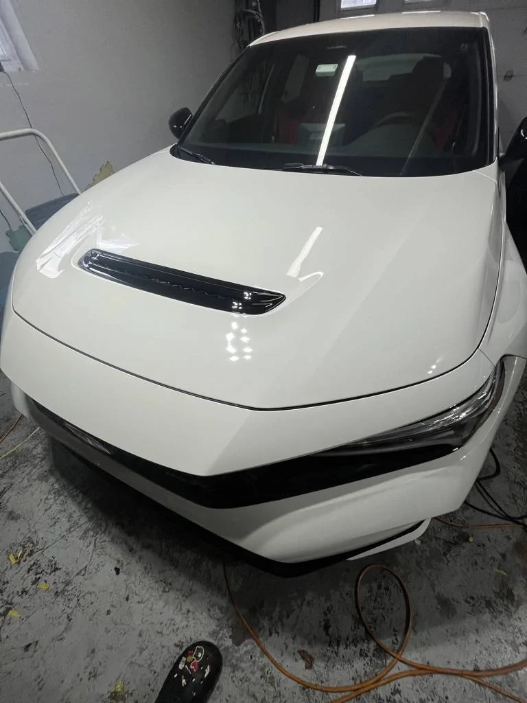

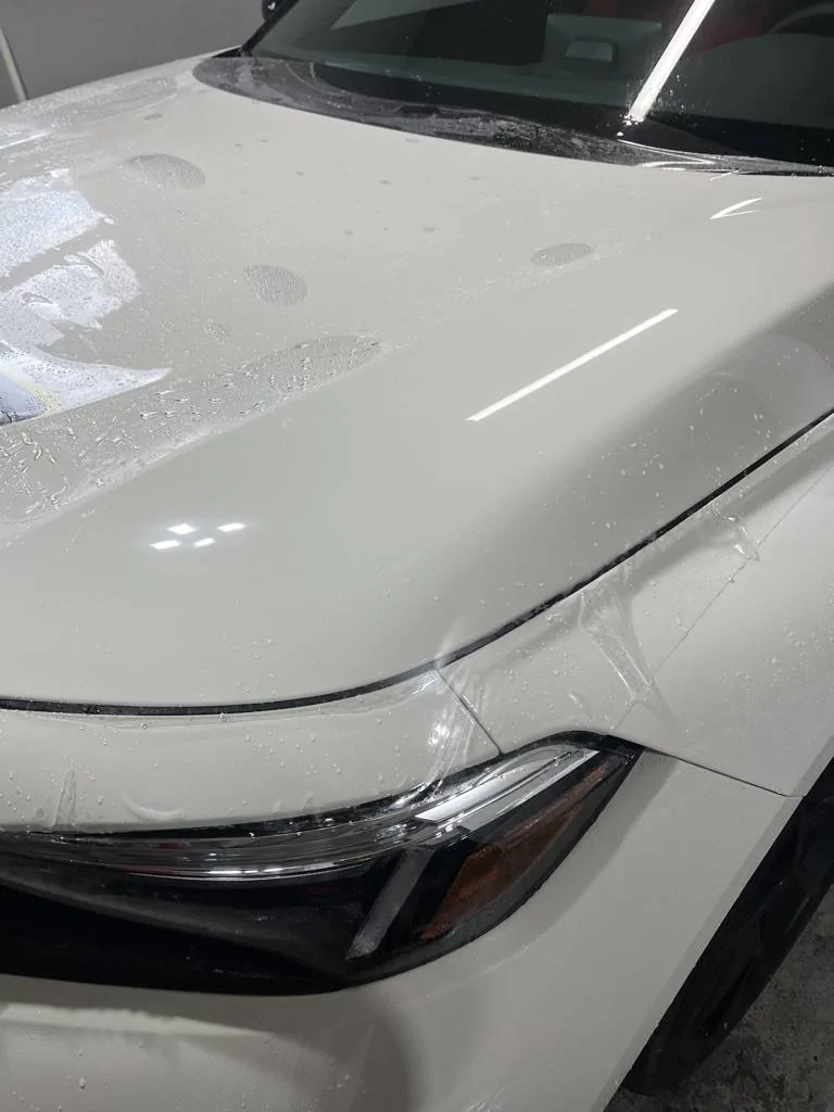

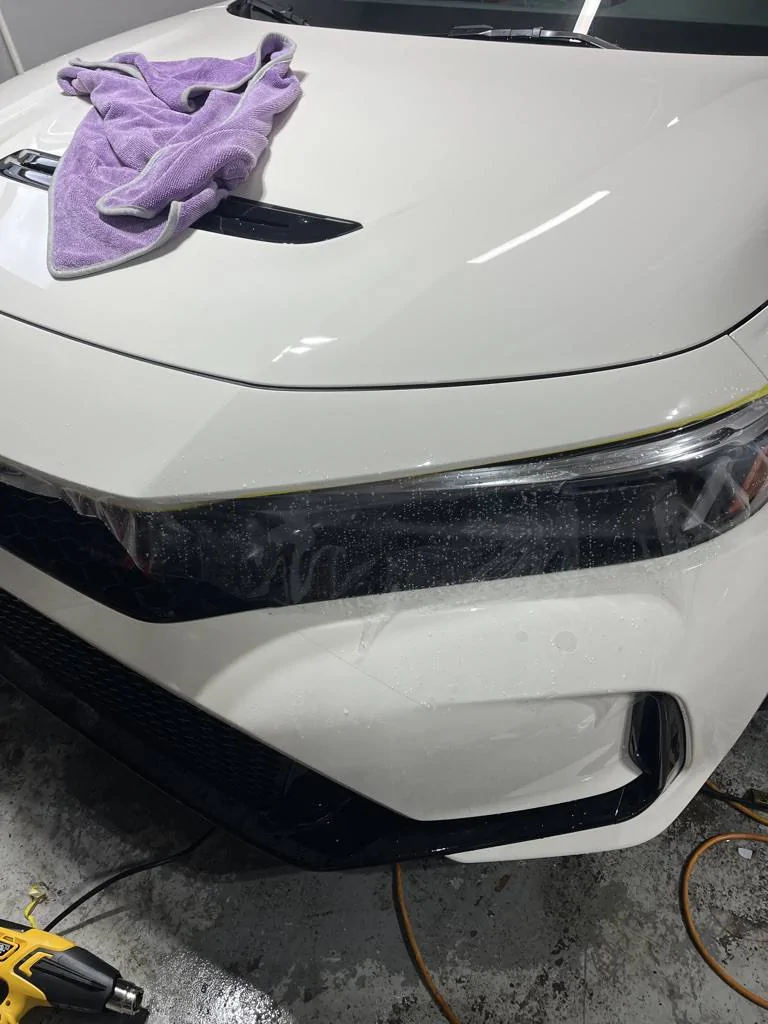

Now on to applying PPF on the Hood and the nose clip:
11th Gen Honda Civic Tommy's Type R Photos and Journal in Ridgewood NJ 256B61EE-6DE2-48F1-9875-E6DCA655A76B_1_105_c
11th Gen Honda Civic Tommy's Type R Photos and Journal in Ridgewood NJ FD739E9C-C109-47D3-B3D6-039EFA26C29E_1_105_c
11th Gen Honda Civic Tommy's Type R Photos and Journal in Ridgewood NJ 2E802678-8F6F-46BC-9854-C4D8D67FD847_1_105_c
all done!
11th Gen Honda Civic Tommy's Type R Photos and Journal in Ridgewood NJ 2CF353D0-76C9-4449-9D5F-534291C44324_1_105_c

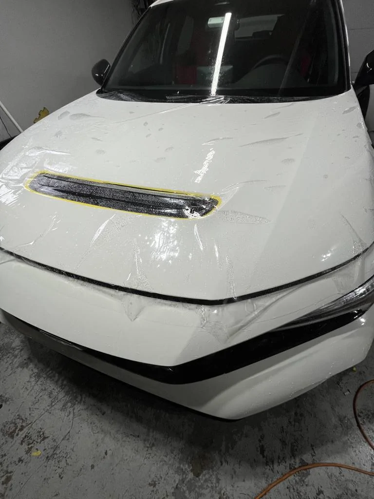

Why did you tape around the hood vent, when applying the PPF? I'm not an installer...just really curious how the installation process works.
No other shops do this because it takes longer labor hours. I've never seen any shops do this around North NJ, or any shops around the world for that matter.
I came up with the taping method on my own while practicing PPF work on my own cars, trying to come up with the safest way to not to damage my cars.
This taping method prevents any smallest chance of cutting the paint while cutting the PPF around the edges. Shops tell you they are pros and "will never cut the paint without any masking". If shops insist they won't go this extra mile, think twice about using them.
Also to add, most shops use pre-cut PPF which is very safe way to have PPF done. But some areas like Hood, or Roof, or certain car's bumpers just can not be done by pre-cut which then will require bulk cut where they have to cut the edges on top of the paint.
