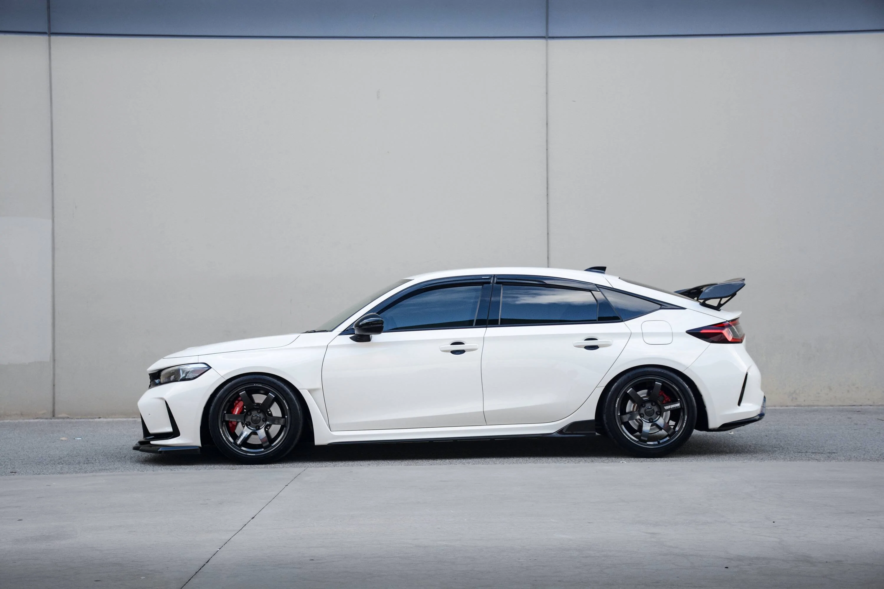

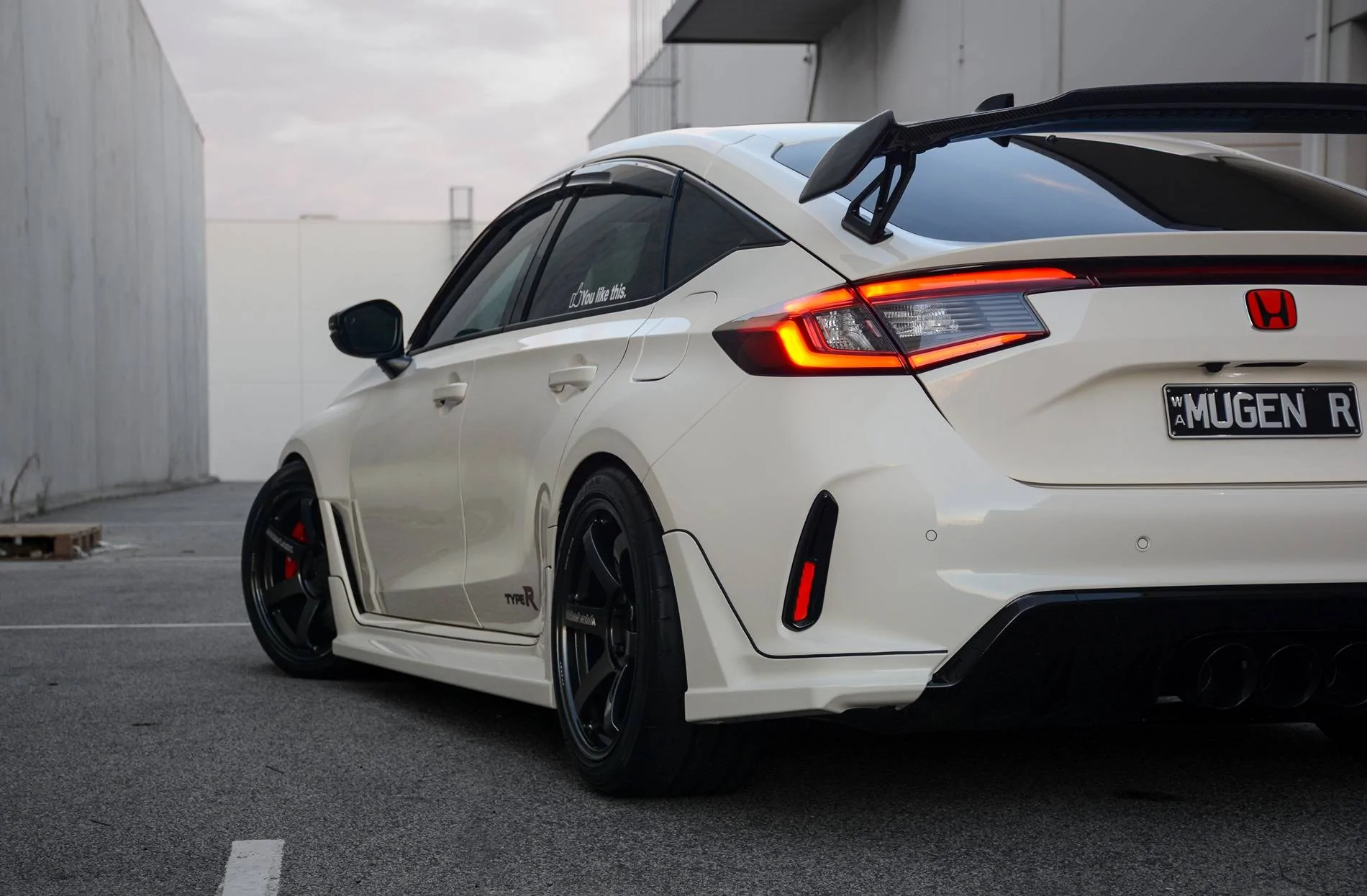

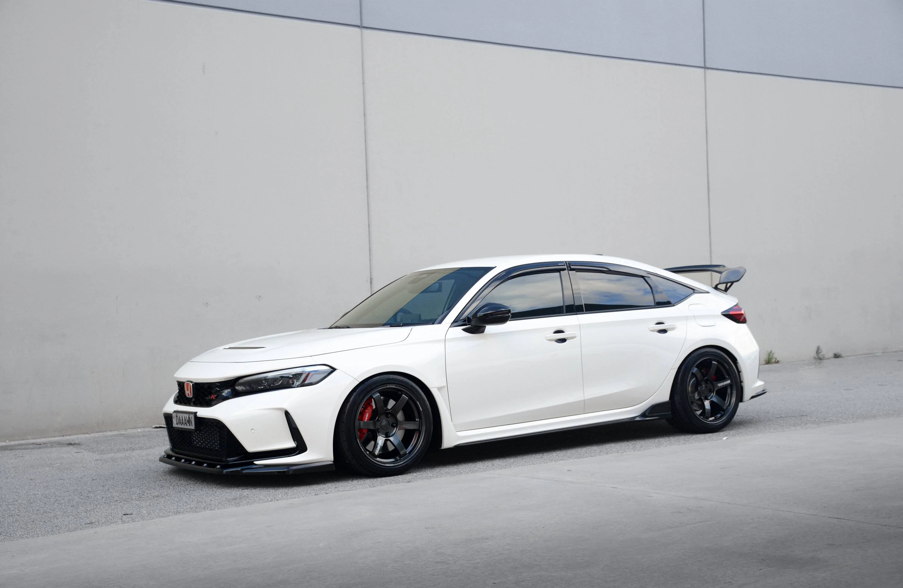

After waiting for 7 months, my wheels has finally arrived and now installed on my car.
Suspension:
Eibach Sportline
Front strut guide pins removed
No rub!!!!
Tires:
Yokohama Advan Apex V601. 275/35/18
Wheels:
Rays TE37 Saga S-Plus Diamond Dark Gunmetal color
18x10 +40

I swear, just when I decide on a spring (spoon); then I see pictures like this and think maybe 1.2 inches isn’t too much lol. Doesn’t look like there is any tucking at all! Looks amazing. What’s front camber at?

Looks amazing ?

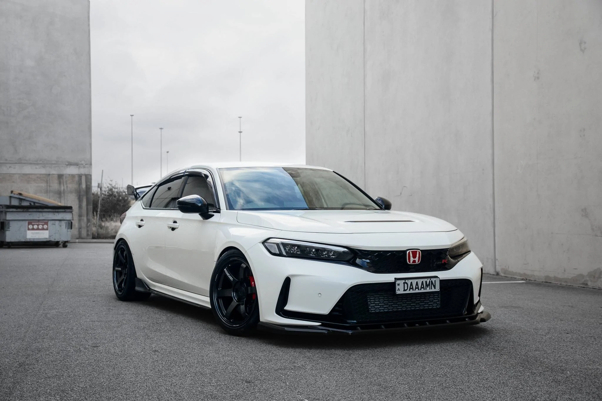

You wont regret your decision. The concavity of the wheels alone is a no brainer.
Here is my current set up looks like.
