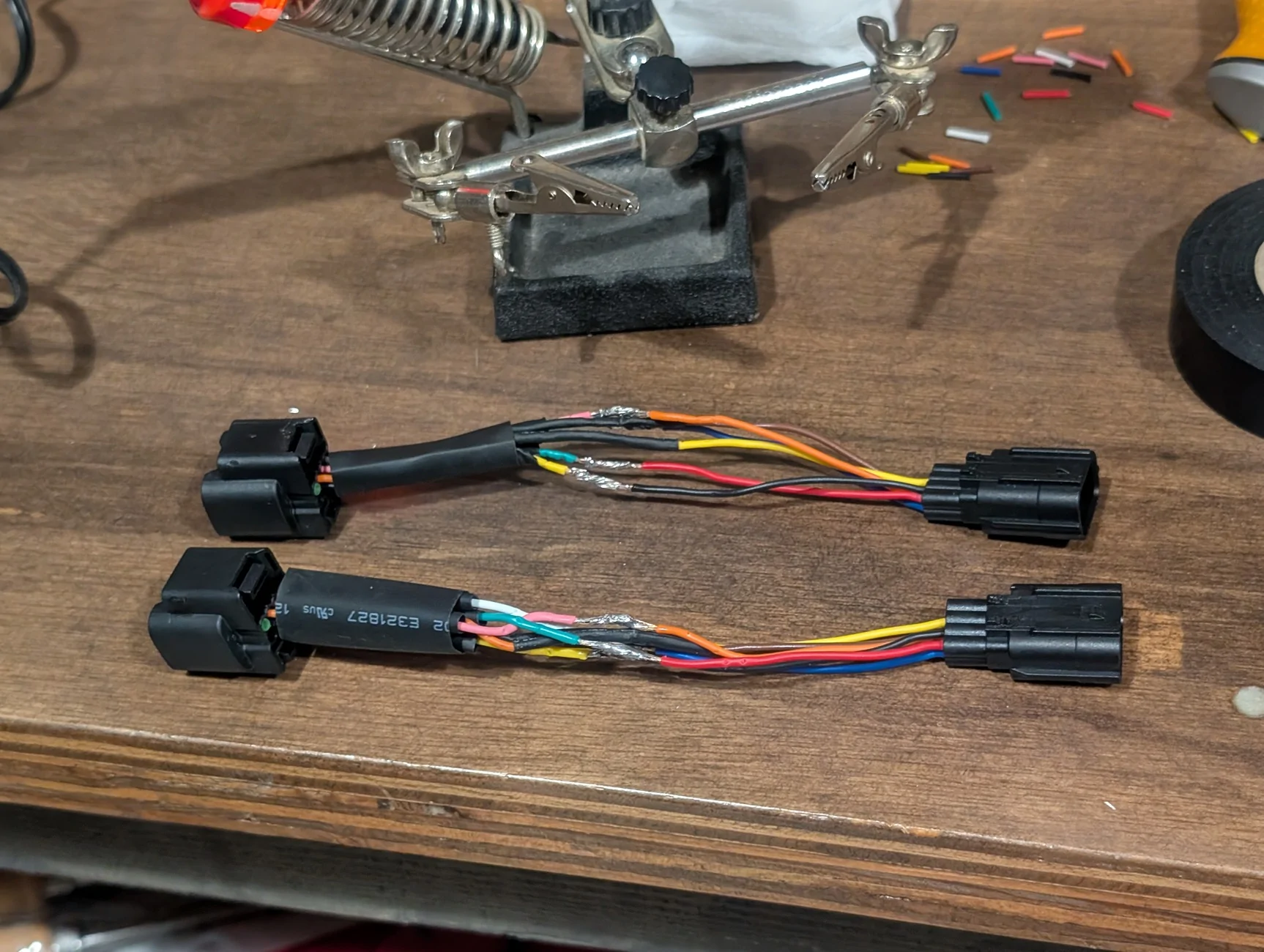

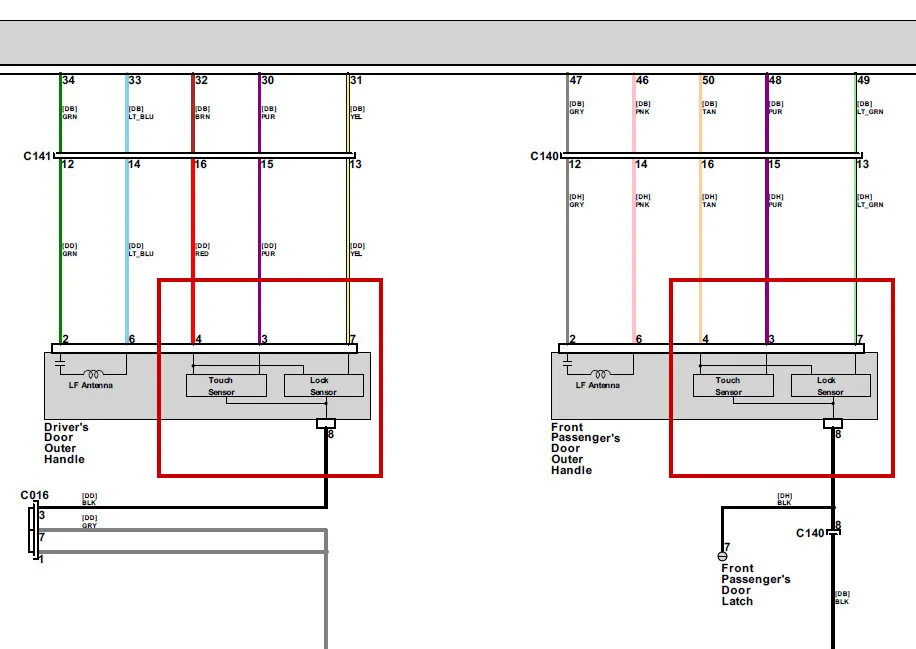

So the main gist of the install is that you'll be tapping the sensor wires from the front handles and running an extension to the rear handles. I opted to splice in the extension using a custom-made splitter so that it's removeable, without any permanent changes to the original wiring harnesses. Here's the wiring diagram of the front handles with the wires you're tapping inside the red box. Don't tap the other two wires, or it'll cause an error with the whole system and you'll lose passive entry entirely until you undo it.

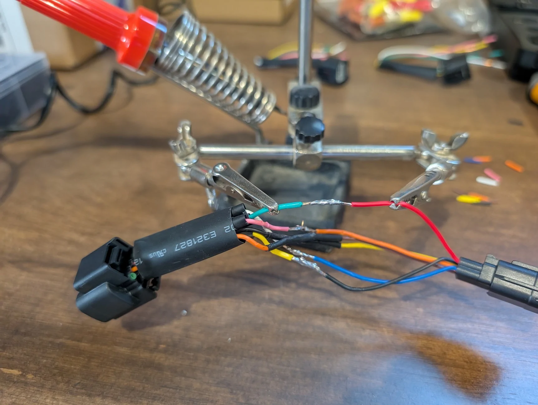

You'll need to wire up one male and one female connector to become a splicer in the front like so:
Don't pay too close attention to the wire colors you see in my example. The connectors I bought were pre-wired, and I got what I got (and I didn't throw a fit). Just make sure you're connecting the correct pin to the correct pin. Keep in mind that as you go from male to female, the order reverses (i.e. 1234-5678 becomes 8765-4321) because it's mirrored. Note above that I have two sets covered up, and the other four sets have exposed solder. I did this so I could tap my new wire after I fished lines through the doors and trim. I didn't know how much length I'd need, so I opted to solder the final bit in the door later. The second female connector will be on the end of the fished-through wires, connecting to the new handle in the rear.

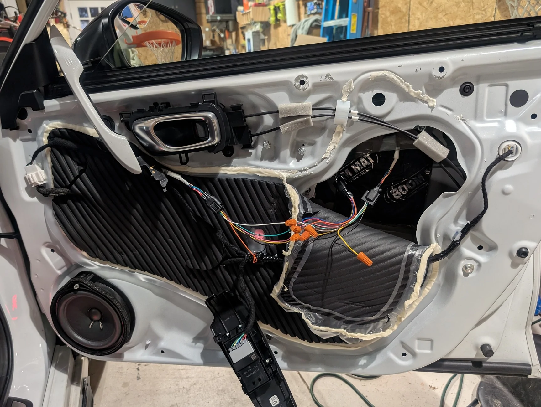

Fishing the wires:
This was the hardest part. It took some time to find the easiest path with the fewest modifications and keep the wires protected and looking like a factory-level installation. A picture is only worth 1000 words, so here's a video!
Swapping the door handle is pretty simple, just unclip and slide back. Installation is the reverse. See clip...
After all that, start connecting wires and wrap it all up. I took a bunch more pictures, so let me know if you want to see how something was done.

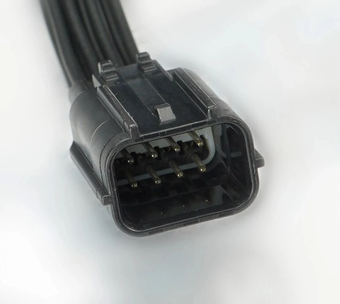

- Two F42B8 Male Connectors with pigtailed wires

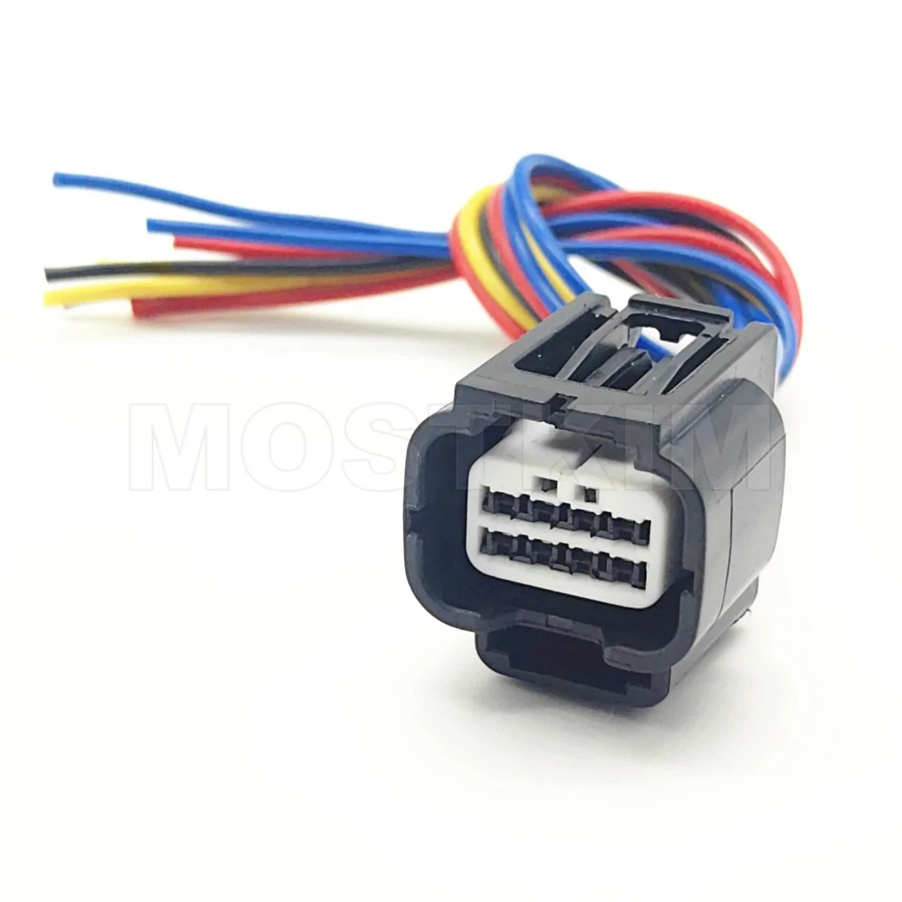

- Four F42A8 Female Connectors with pigtailed wires
