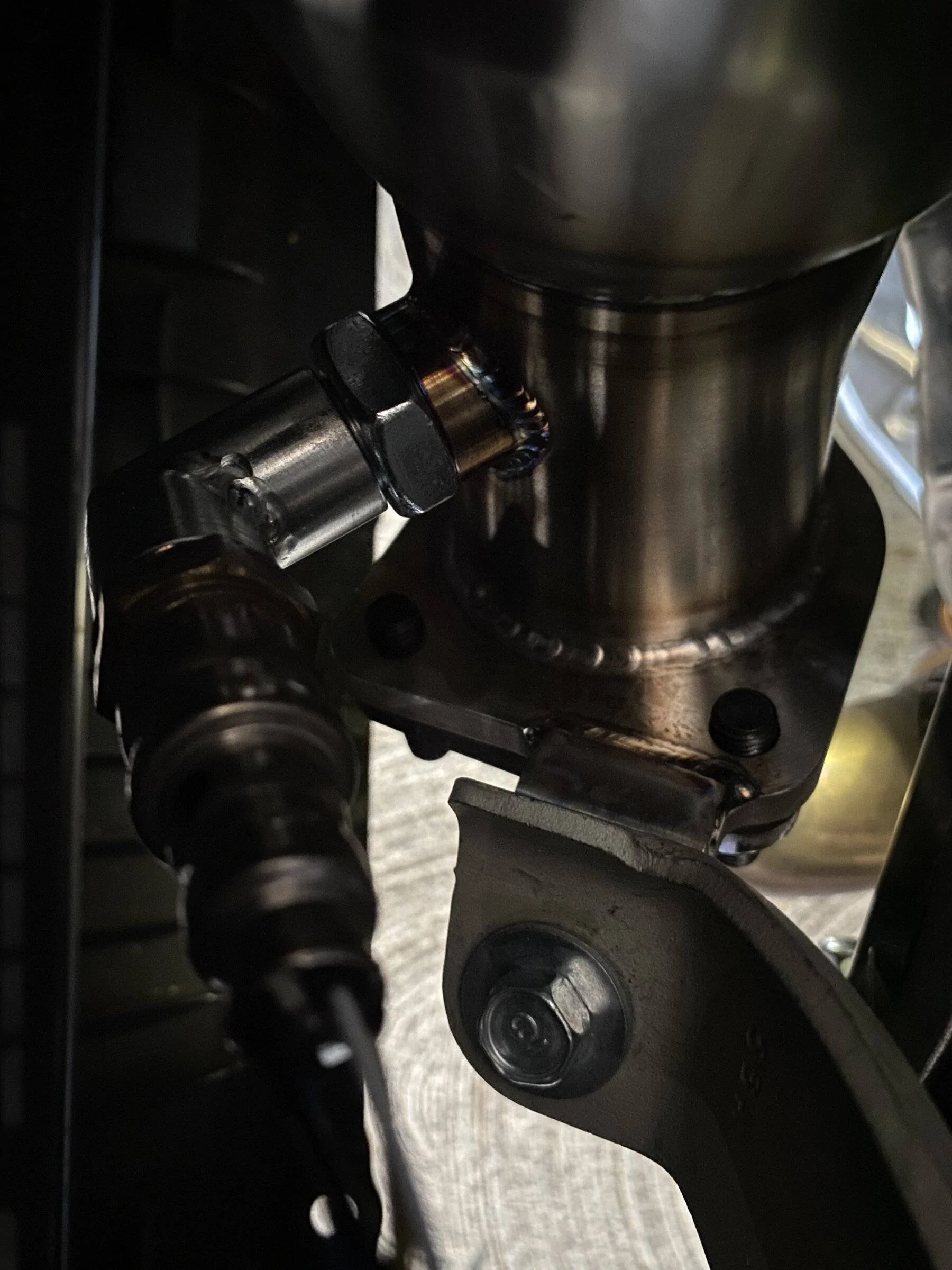

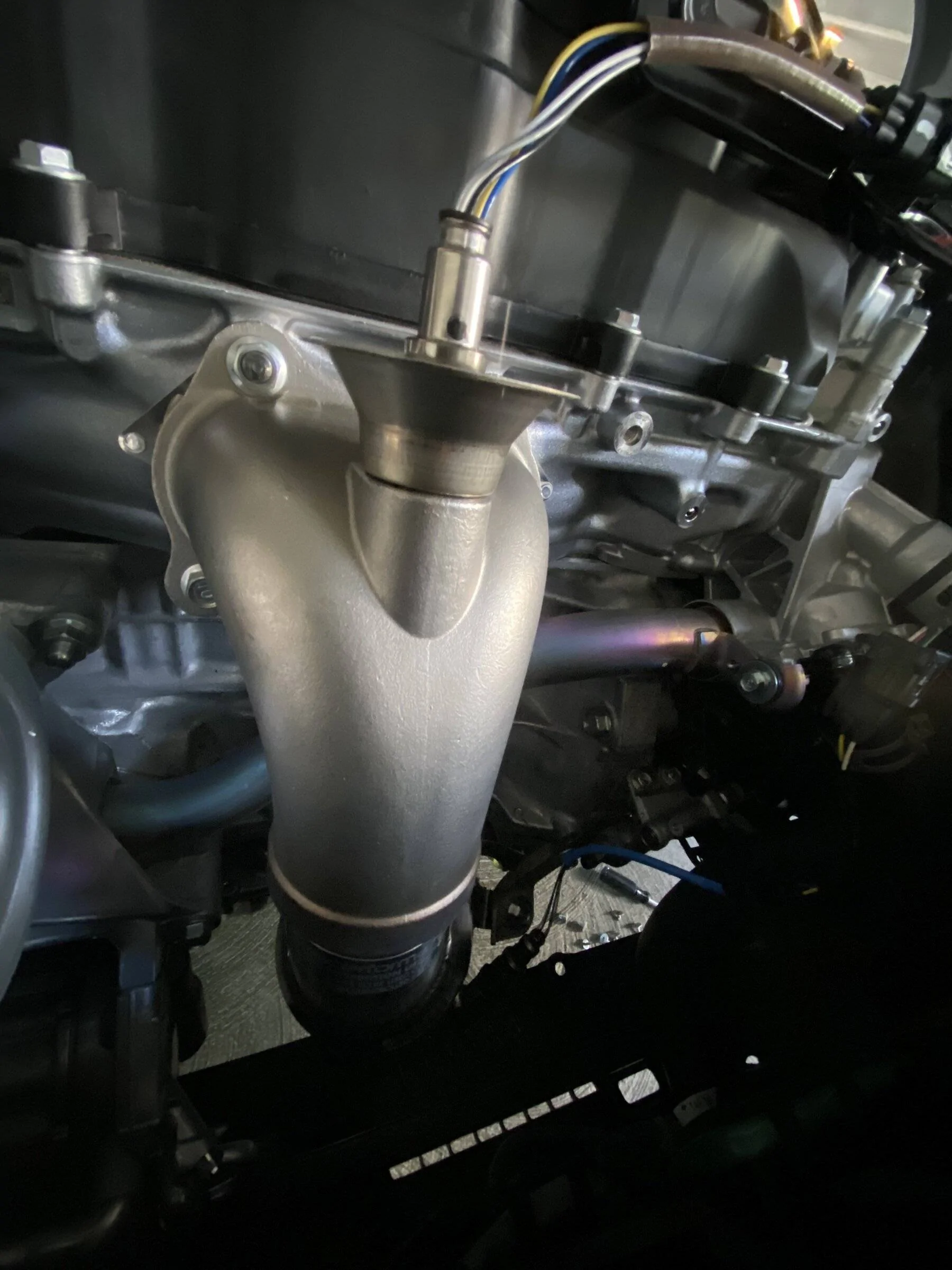

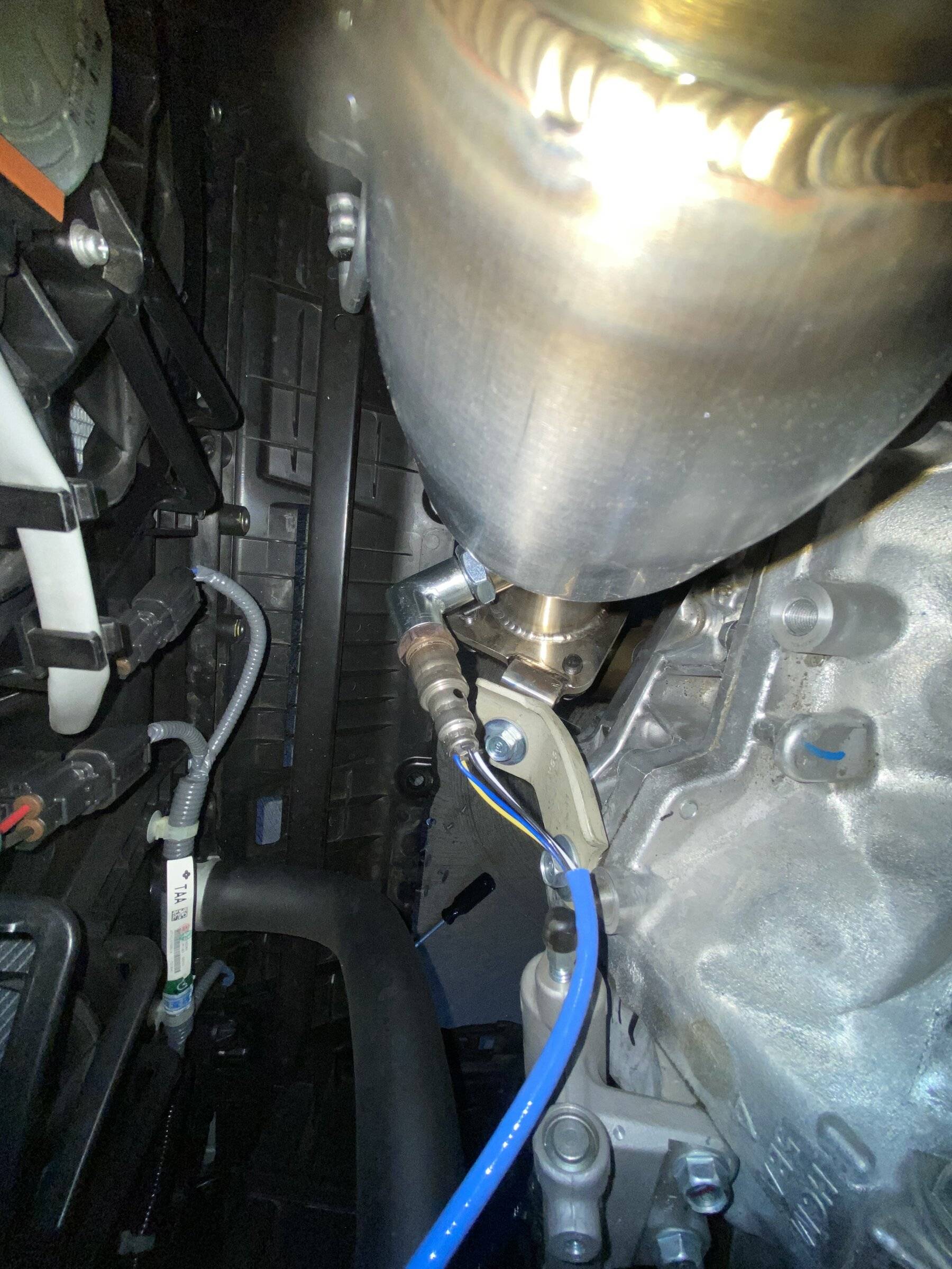

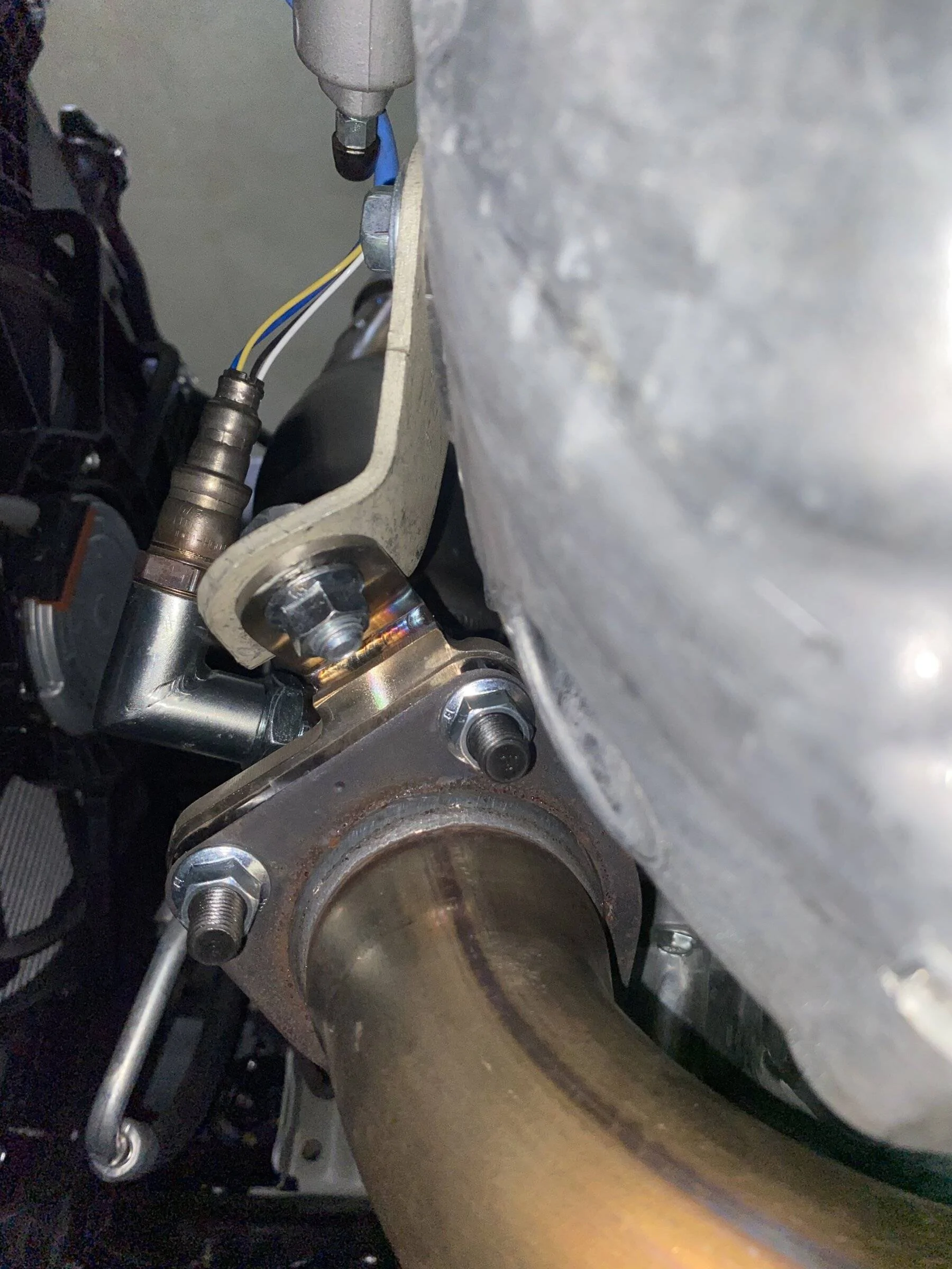

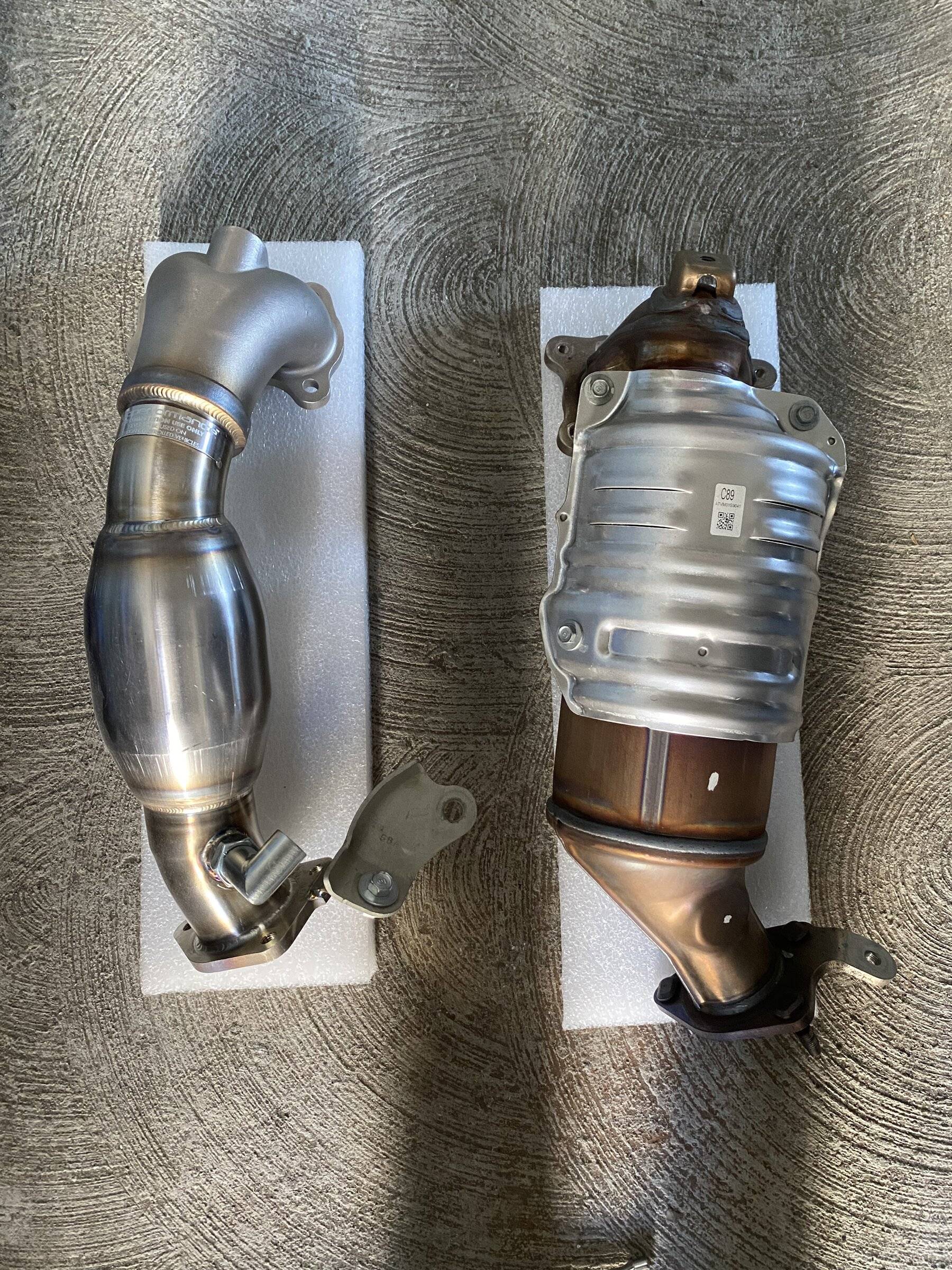

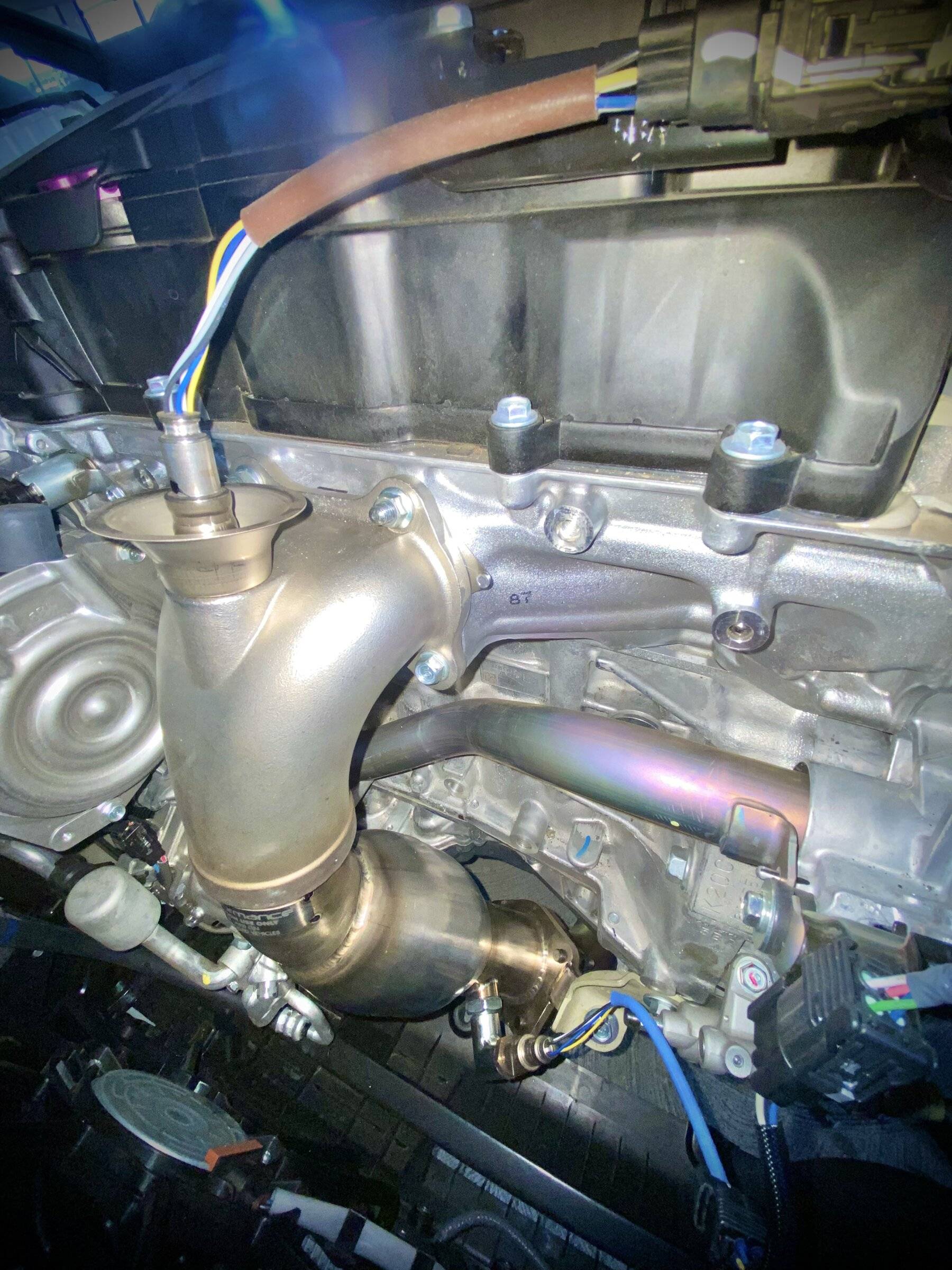

K20C2 guys, chiming in to confirm fitment for @RV6 downpipe. Install was a breeze, plenty of room to work with in the engine bay. Installation time was around an hour and I was taking my time. I won’t go into detail on the install as there are a million 10th gen how to’s for this and the 11th is essentially the same. I will say a breaker bar will make your life easier. Also be sure to NOT to over torque the 2 nuts and bolts at the exhaust port on the head, stripping those will make you hate life (I know from working on Bseries engines in the past ?). Also, do NOT initially tighten the support bracket on the lower portion of the downpipe. Leave it loosely hand tightened, line everything up and then you can cinch everything down at the end. There’s a few Youtube installs that neglected to do this and didn’t end up using the support bracket, note that not using the bracket is not recommended by RV6 and you’ll get a nice reminder about that from the label RV6 attaches to the downpipe.
Onto fitment. Zero issues, bolted right up perfect fit. Plenty of clearance after the downpipe is mounted, you shouldn’t have anything close to rubbing on it to cause any rattling issues or unwanted noises. The only noise you should hear after installation is a welcomed sportier exhaust note.
