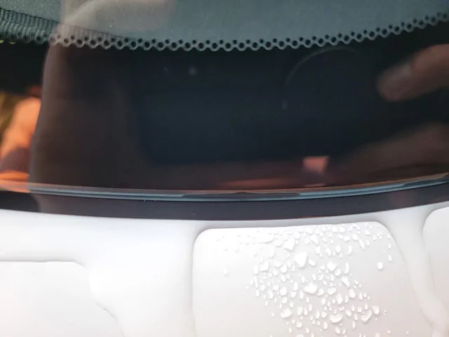

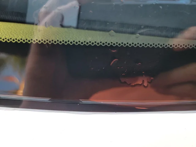

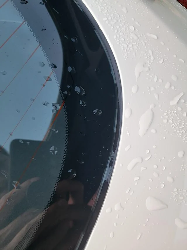

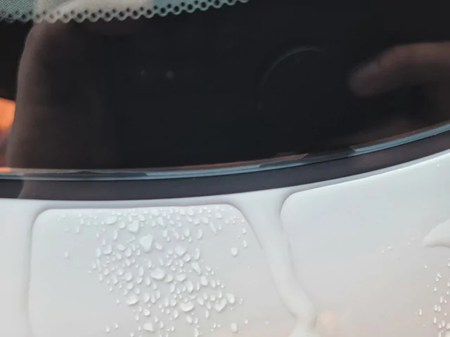

I just bought this car and it's already leaking water into the rear hatch window. I took some pics and wanted to share this with everyone that may have the same issue as mine.

Youtube channel "NAUS" had a leaky hatch. He shows where water was entering under the hinge attachments. I noticed my car looked the same as his (pop-rivet not flush), so I caulked around the hinge brackets with DAP Dynaflex 230 clear.
I live in the desert, so no rain yet to test my fix. Good luck!

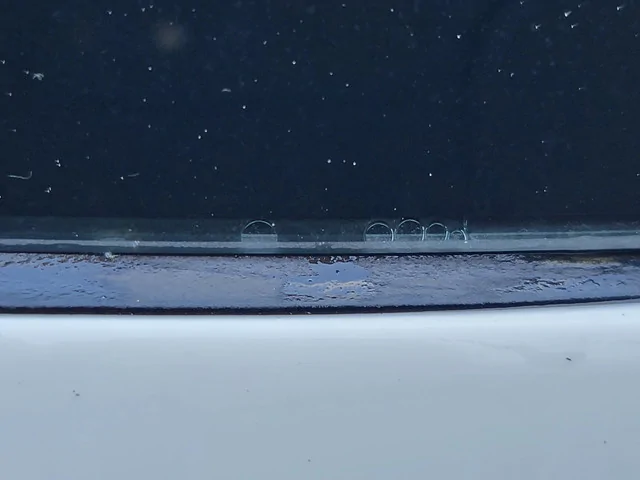

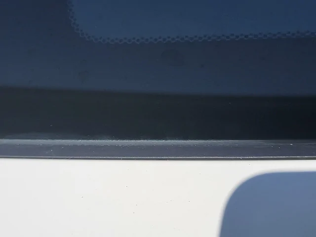

There's a slight gap on the bottom it isn't fully seated. Was told by a dealer that's normal. The rear glass was replaced and these are the results.
