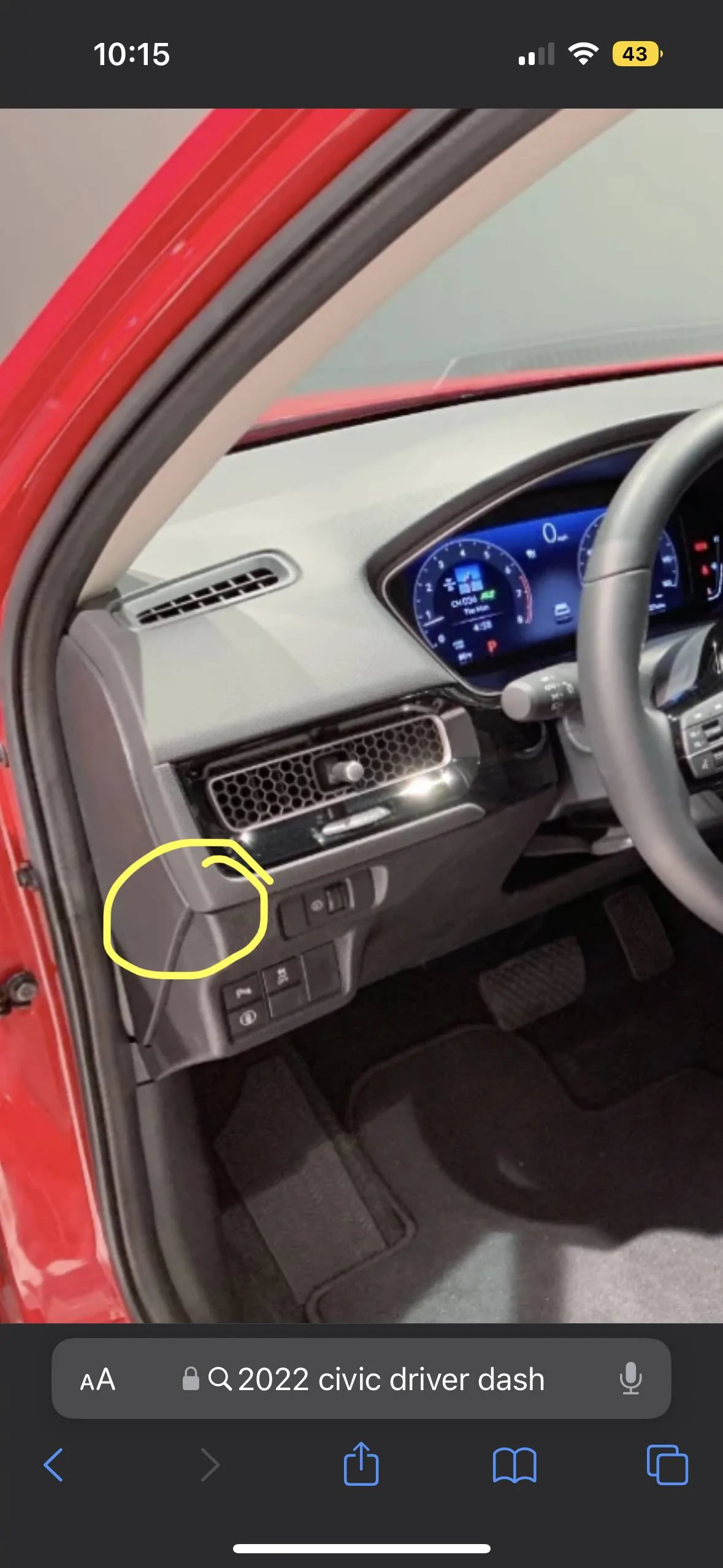

i had similar rattle in the trim of the dash, it goes away if you put a piece of cloth or felt to kill vibrations
Where exactly would you say the dash rattle was? Mine comes and goes from time to time but happens more when it's cold. Feels like it's to the lower left of the steering wheel kick panel. When I apply a bit of pressure there it stops.

So my rattle came from the left seam of the dash where the door closes. Theres 2 plastic pieces that join there and whenever it rattled id hold it with my finger and it would stop.

Thanks CTRgo. I'll have to push there and see if that's where my rattle is next time it acts up!
