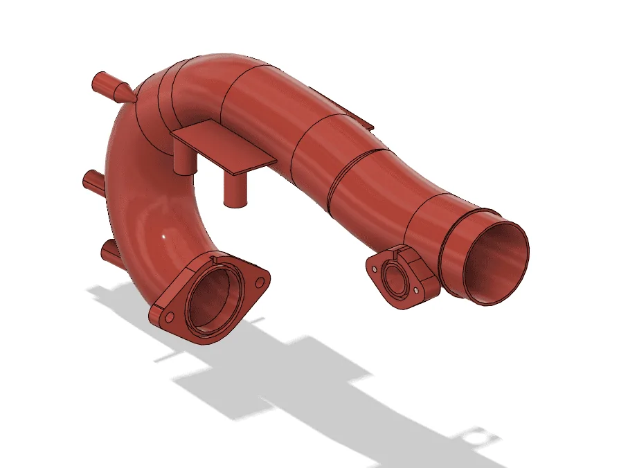

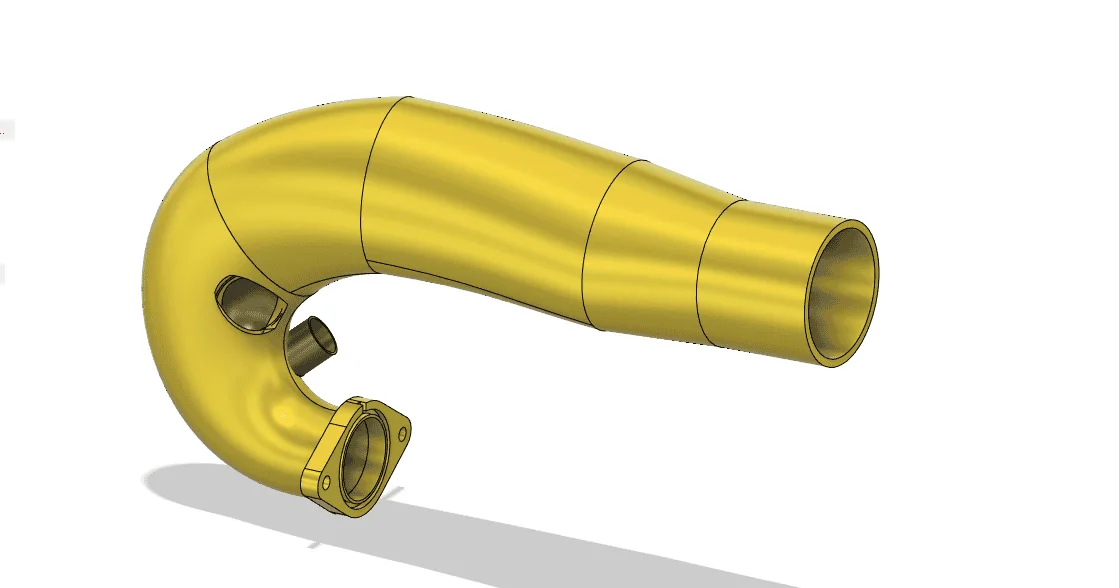

After understanding the 11th Gen OEM TIP design we went to the drawing board to sketch up some ideas of what a larger aftermarket turbo inlet pipe will look like on this car. We started with some basic architecture and got an overall shape and preliminary design. You can see that below. We wanted to get an idea of just how big we could make it.

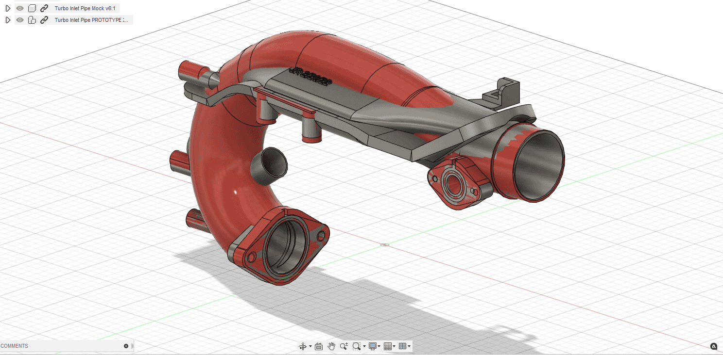

AFTER THAT, WE STARTED TO DIAL IN THE DESIGN WITH FEATURES. IF YOU RECALL IN OUR PART 1 BLOG THERE IS AN EVAP NOZZLE THAT IS ON THE FRONT OF THE OEM INLET PIPE FOR EMISSIONS-RELATED PURPOSES. WE WANT TO MAKE SURE THAT WE KEEP THAT SO WE DON’T THROW ANY CEL’S ON THE CAR. THERE ARE SOME PICK-UP POINTS ON THE BACK OF THE INLET PIPE THAT VARIOUS LINES AND HOSES SECURE TO, WE WANT TO KEEP THOSE TOO. YOU CAN SEE AN IDEA OF THAT BELOW. THERE IS A SIMPLE OVERLAY OF A 27WON CONCEPT OVER OUR OEM MOCK-UP. YOU CAN CLEARLY SEE HOW MUCH BIGGER IT IS.
