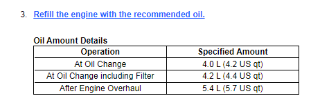

For the 2.0L, you'll fill 4.4 US quarts:
11th Gen Honda Civic Oil Change Service Docs for 2022 Civic 1.5L and 2.0L 1641582147133

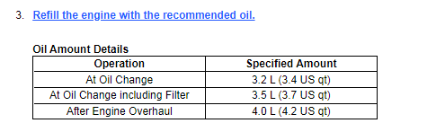

For the 1.5L, you'll fill 3.7 US quarts.
11th Gen Honda Civic Oil Change Service Docs for 2022 Civic 1.5L and 2.0L 1641582303297

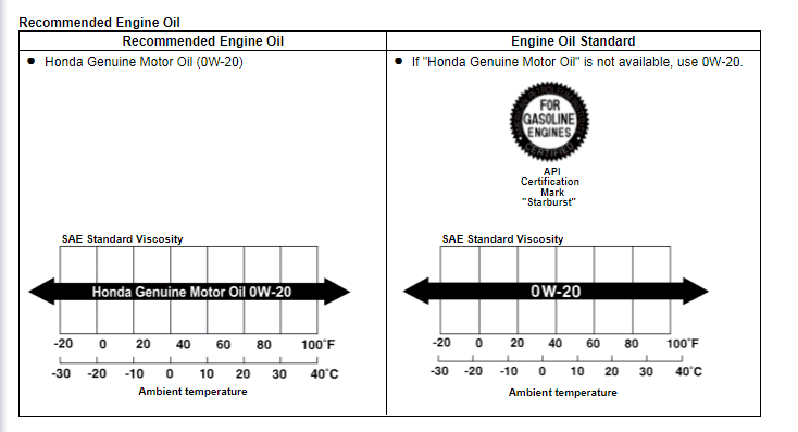

Honda says 0W-20 for both 2.0L and 1.5L
11th Gen Honda Civic Oil Change Service Docs for 2022 Civic 1.5L and 2.0L 1641582216961
