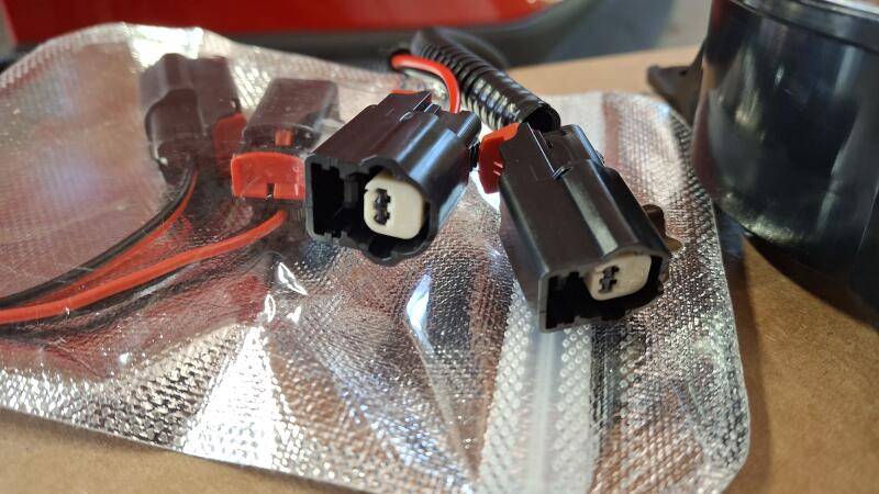

If you decide to make your own harness or try to find one on eBay/Amazon to use, look for a harness with these connectors:
Again, they are L1B.

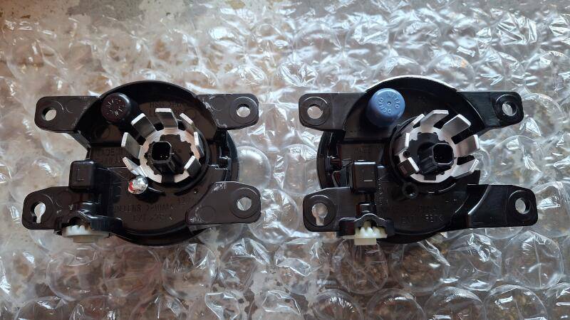

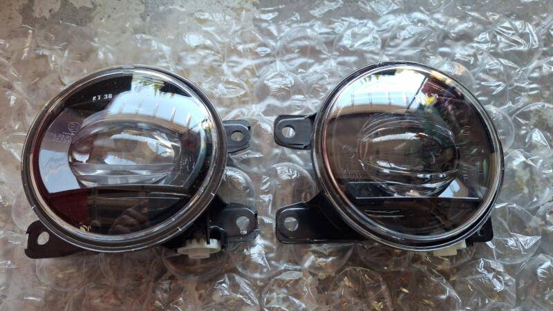

And some comparison pictures of the eBay kit I bought (left) vs OEM (right):
Visually, very accurate, but side-by-side the differences stand out. As well as the "Made in ____" vs "Made in USA" of course.
But the OEM beam is MILES better:
eBay on top, OEM below
