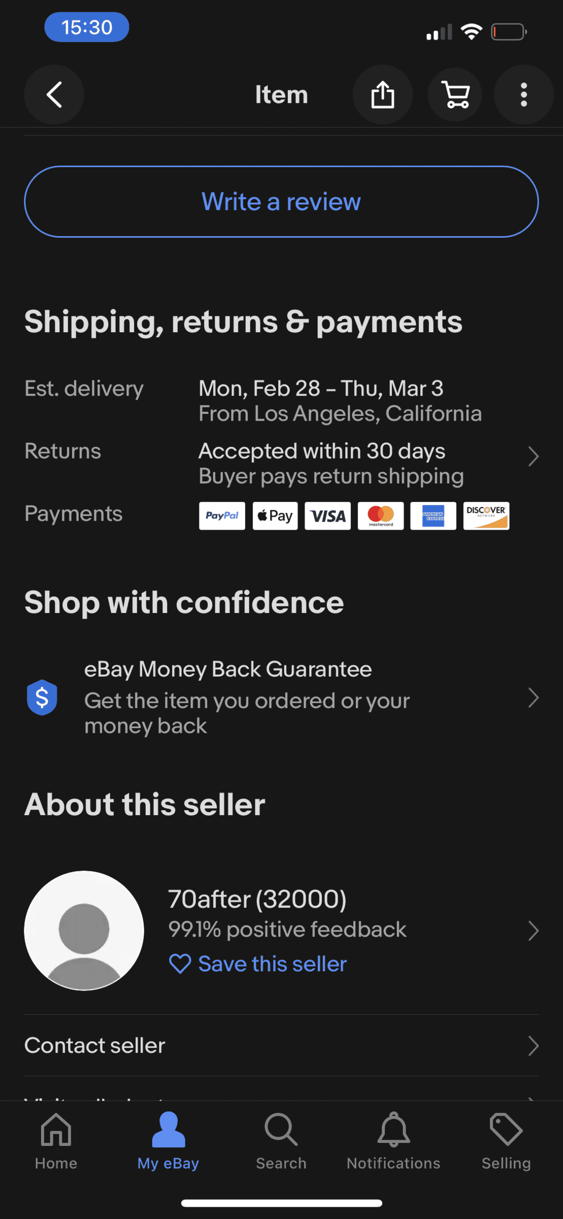

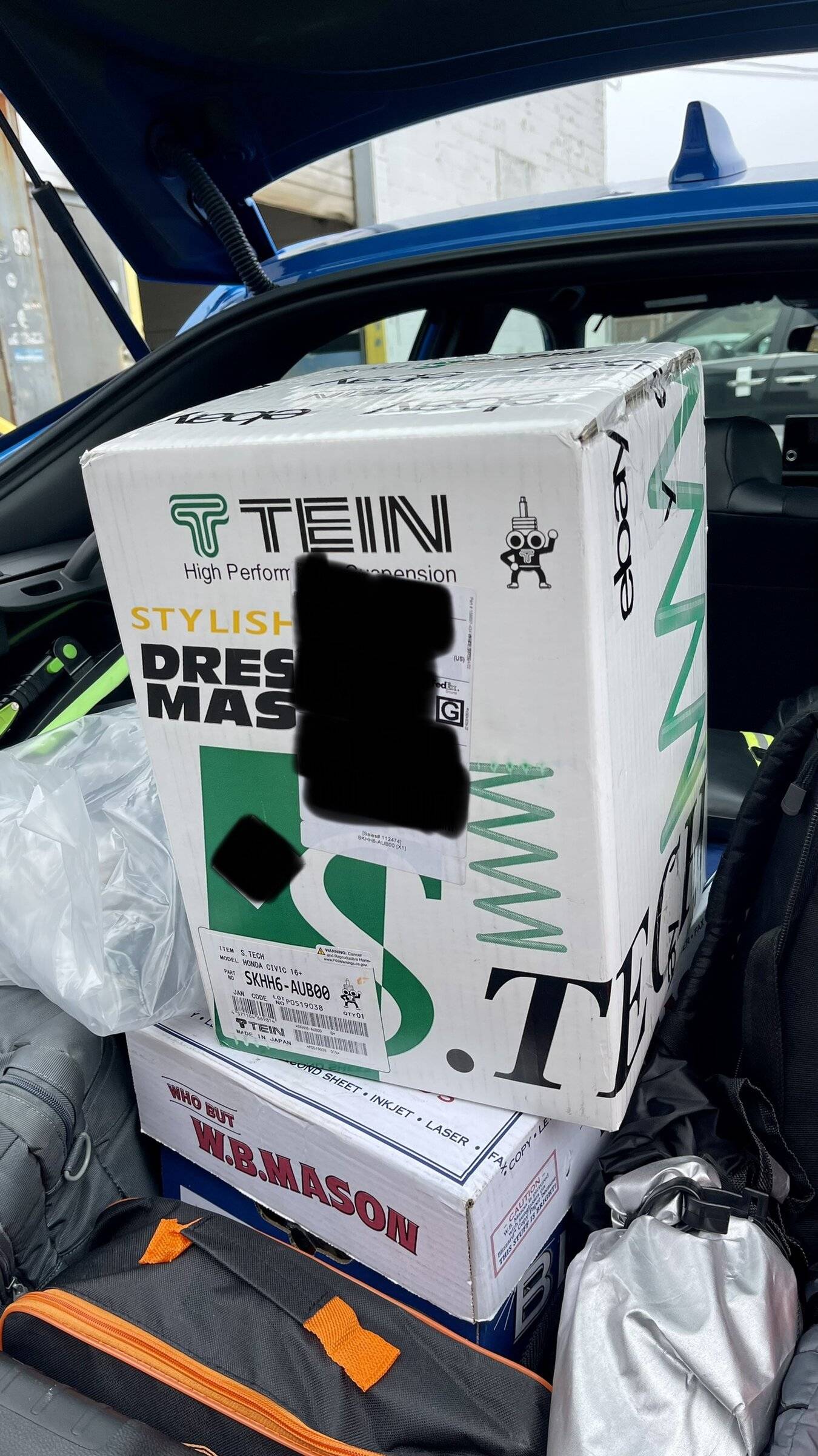

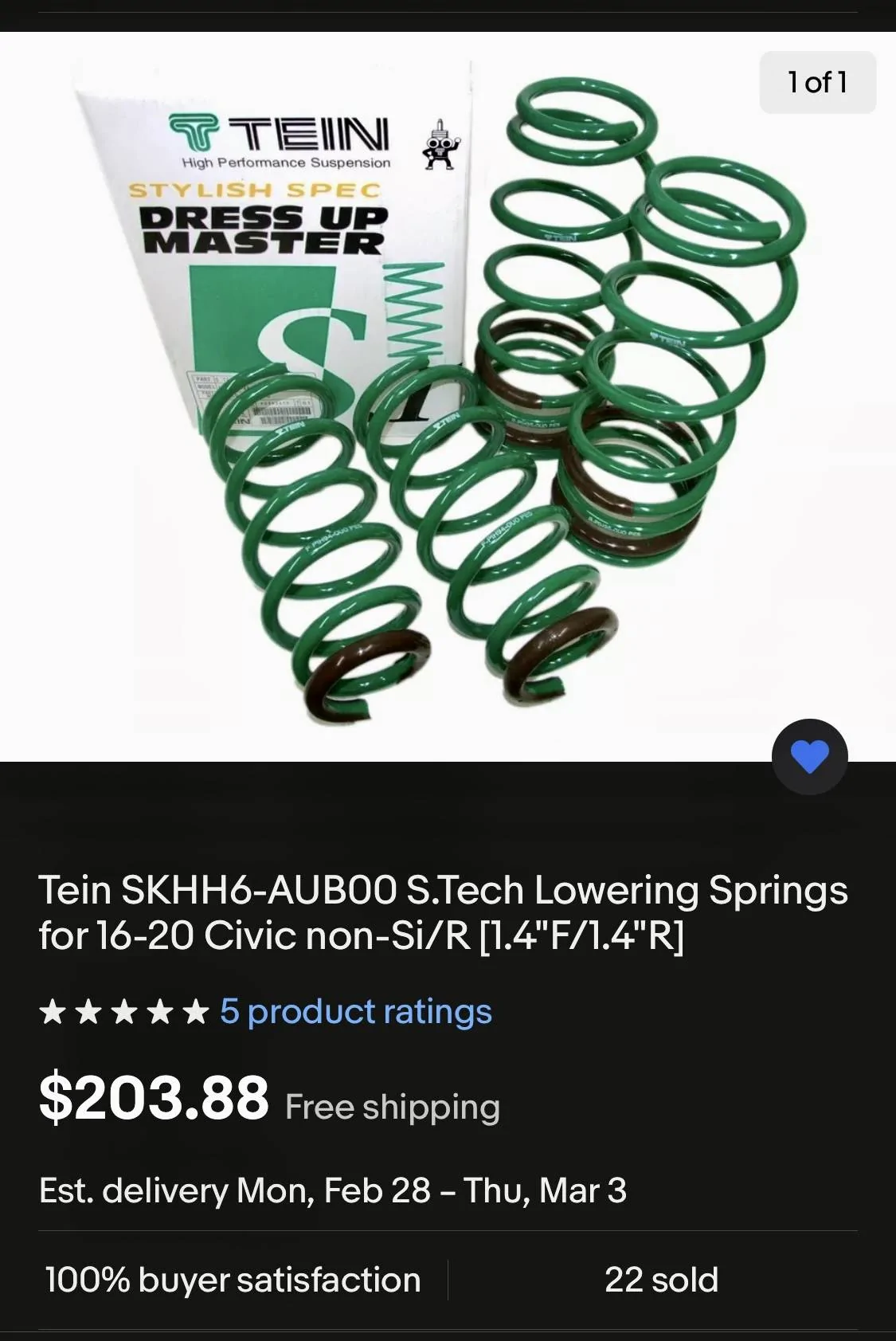

I just pulled the trigger on the Tein S-Tech springs from eBay which happened to be the cheapest price I was able to find. Came to $221.46 after tax, and free shipping. I try to avoid eBay as much anymore bc it’s flooded with nonsense, but I felt confident here. Can’t argue with THAT much positive feedback DAFUQ??!!????
Pics below:
but anyway, so I’m gonna install these probably end of March, early April, once the 60° weather is more steady by me. Hoping the oem shocks hold up nice for awhile until I can order the Enduro Pro Plus OE shocks from Tein also. Hopefully by summer I’ll get those and the BBK from 27WON, then summer wheels & tires, etc etc. who knows…

Are we for sure the 10th gen springs fit on the 11th gen?
sgtmorph
sgtmorph
Feb 3, 2016
50
661
355
Long Island, New York
Yes! Here’s why. I’ll try to keep this brief. After much research by many here, we are able to confirm that the suspension crossover goes like this.
10th gen hatch had 52mm front strut mounts.
10th gen Si had 53.8mm
10th gen non-Si (sedan & coupe) had 50.5mm
Now we look at the 11th gen so far.
We‘ve confirmed the 11th gen sedan & hatch are 50.5mm and the 11th Si is 53.8mm
So essentially Honda got rid of the 52mm struts on the old hatch and made it more simple (likely for manufacturing costs).
So 10th Si matches 11th Si
10th non-Si matches 11th non-Si (both sedan and hatch).
10th gen hatch discontinued.

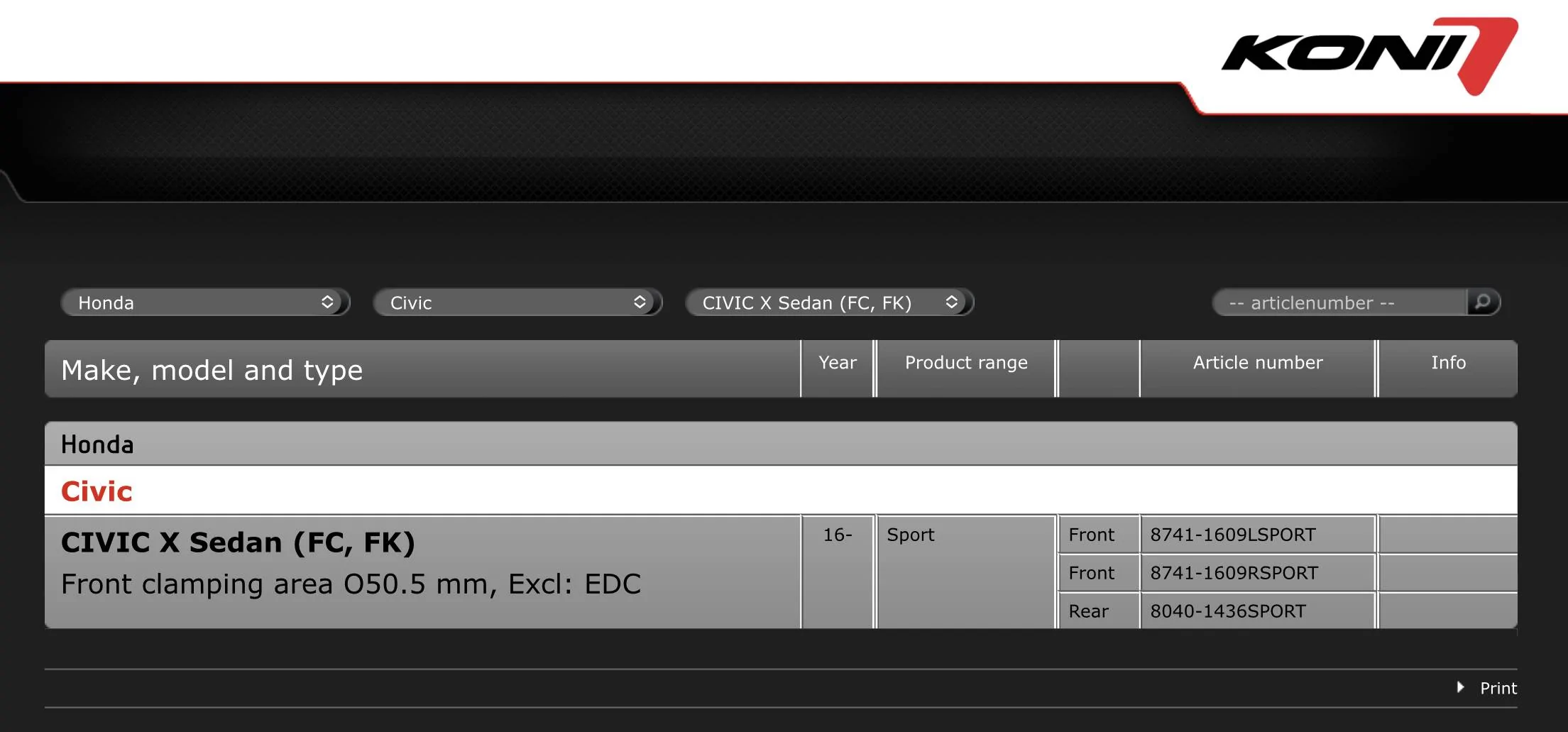

Bumping this bc of excitement ??
Just saw the post on civicX that Koni shocks are almost ready! AND I decided to randomly check their website and sure enough. It’s been updated with part numbers! And confirms 50.5mm ?
Cant wait ??
