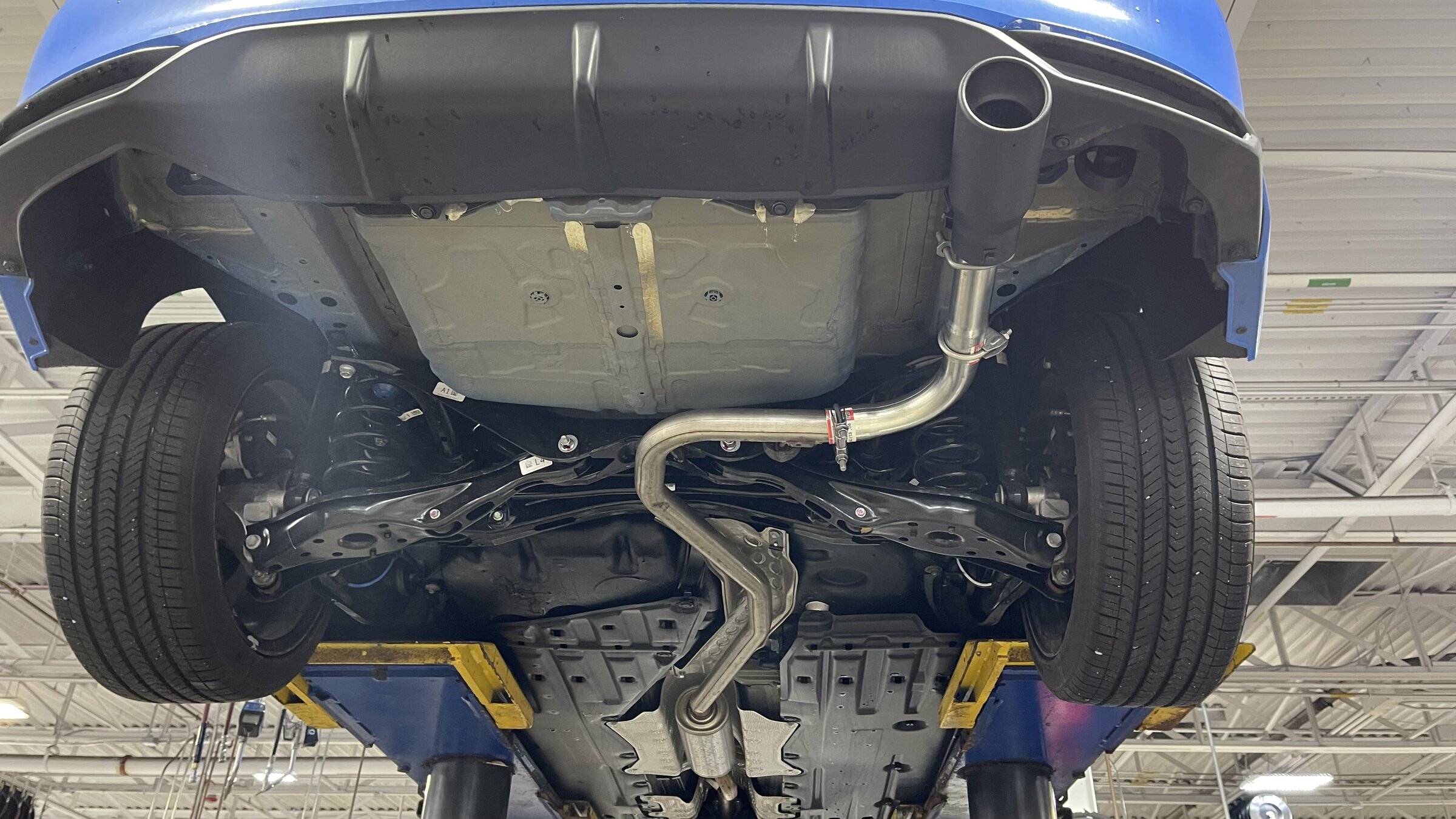

Some may like, some may not, but I’m loving it! ?? It was my day off so I stopped at my local parts store, got some pieces, and got to cutting! This was extremely easy and bolt-on.
I only had to drill one hole for the rubber hanger. Cost me about $40 bucks in parts, and about 2 hours of my own labor. Overall, I’m very happy with the sound and looks!

Yes Yes…..I do plan on going back under to put lock washers on everything lol. Slipped my mind until literally now and seeing these pics ??

wow that looks so clean, better than aftermarket at such low cost, as long as you like the sound. How does it sound like ?

Thx for the compliment! I was going for clean, simple, cheap!
I like it tbh…not loud, or annoying. But WOT sounds glorious ????

Not loud or annoying are good characteristics to have IMO, lol.
