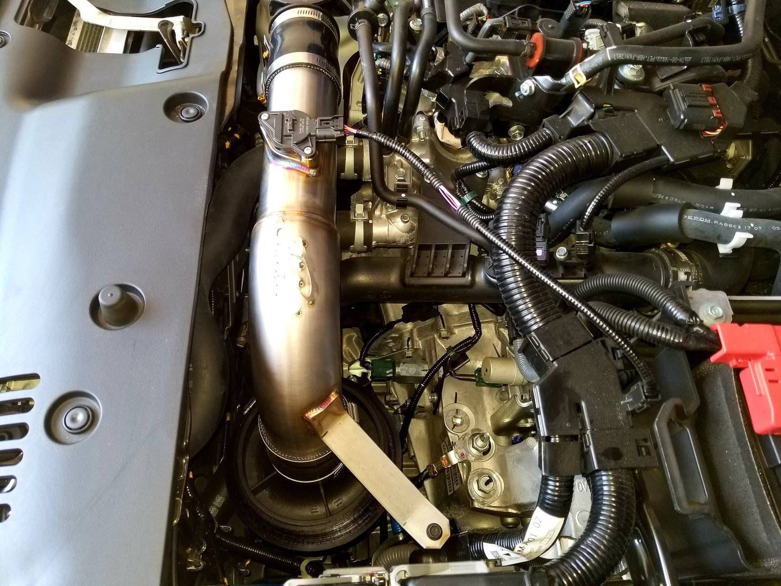

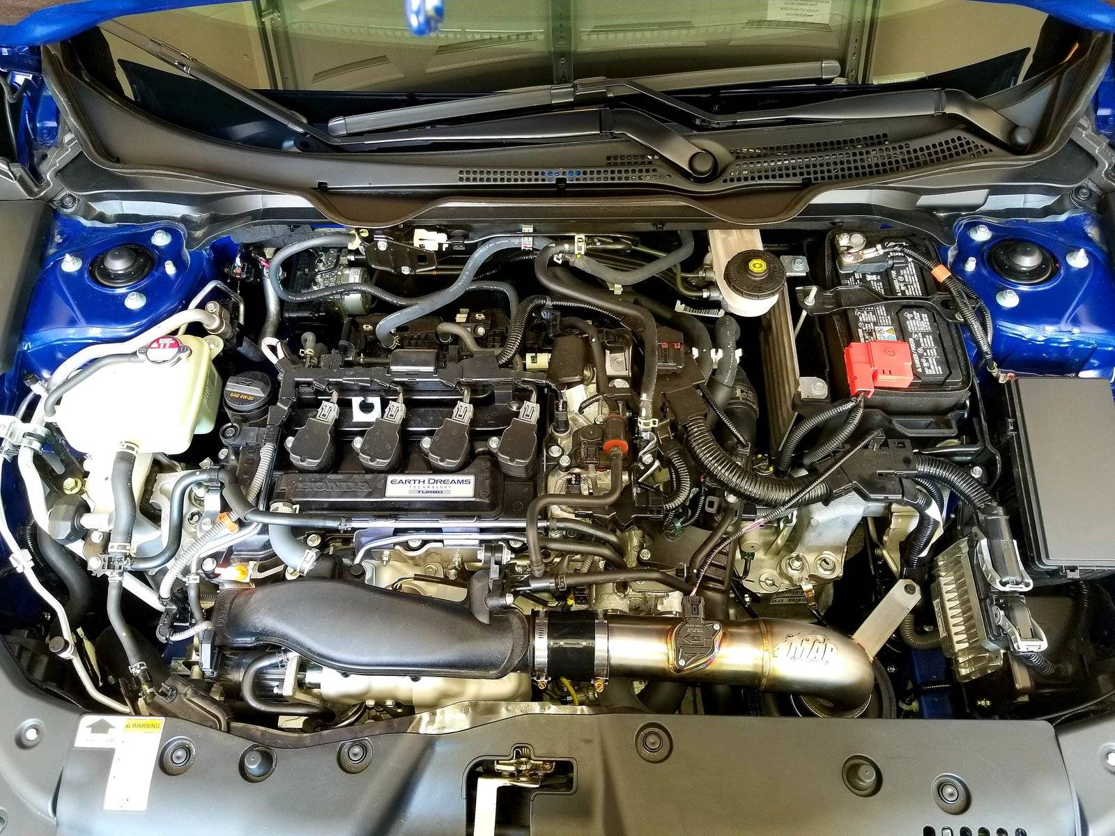

We first started with the intake. As always, we wanted to continue with our traditional way of fabricating. Made in house in our facility located in Cottage Grove, Minnesota, using a CNC cut MAF housing, US made 304 stainless steel, and welded by some talented, sexy fabricators. We opted for a clever press method in which we were able to expand the tube to the correct internal diameter of the factory MAF housing design. This eliminates the need for a bulky, pricier billet piece coupled with silicone connectors to form a single, hydraulically efficient design.
11th Gen Honda Civic MAPerformance Project SI Build Thread Extravaganza! DSC_8484
11th Gen Honda Civic MAPerformance Project SI Build Thread Extravaganza! DSC_8486
11th Gen Honda Civic MAPerformance Project SI Build Thread Extravaganza! 20180701_140954-
11th Gen Honda Civic MAPerformance Project SI Build Thread Extravaganza! 20180701_141007-

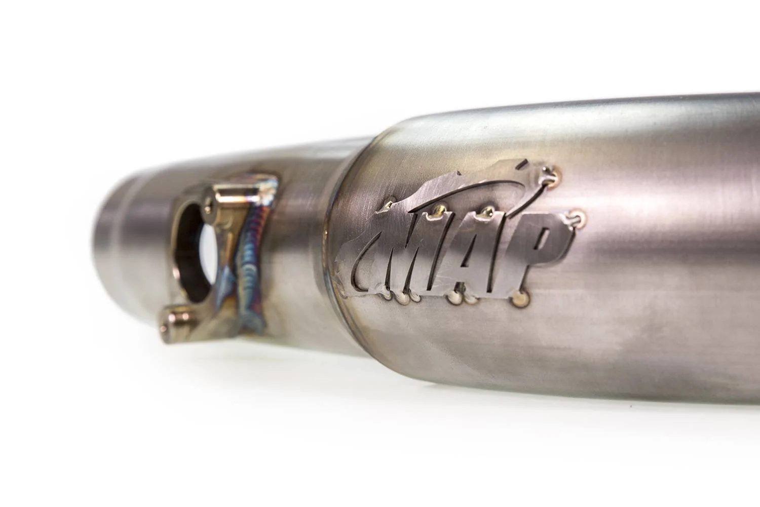

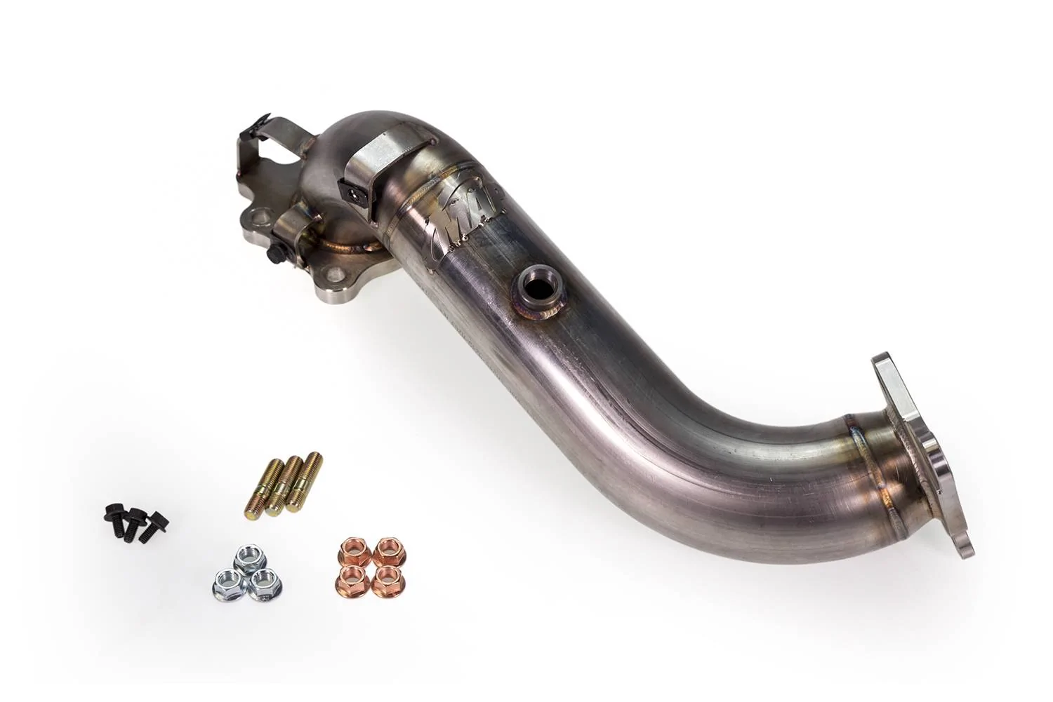

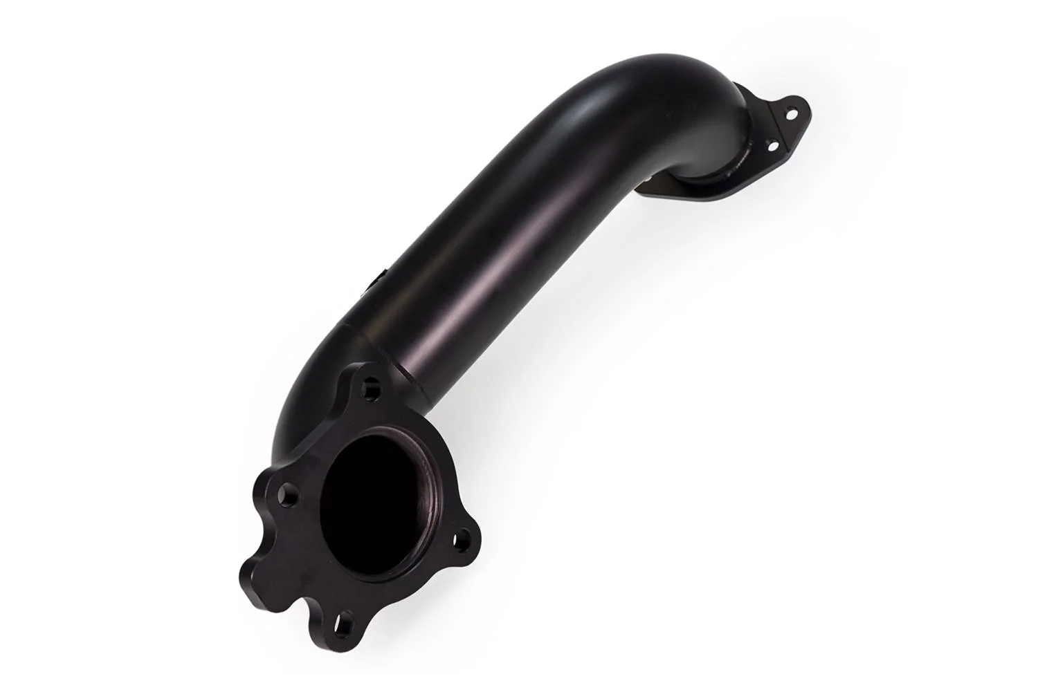

With the intake ready and installed, we can now begin working on the down pipe. We wanted our downpipe to be able to work with the stock heat shield, and still have room for the optional GESI cat. As with the intake, our downpipe is hand made from 3" 304 stainless steel, using CNC flanges, and a one piece mandrel bent tube. This also allows us to provide a lifetime warranty with all of our fabricated components. We are also going to include new turbo to downpipe studs just in case one were to break off. We found it was easier to simply replace them before installing the downpipe. These will be available in raw stainless, or ceramic coated.
11th Gen Honda Civic MAPerformance Project SI Build Thread Extravaganza! DSC_8479
11th Gen Honda Civic MAPerformance Project SI Build Thread Extravaganza! DSC_8467

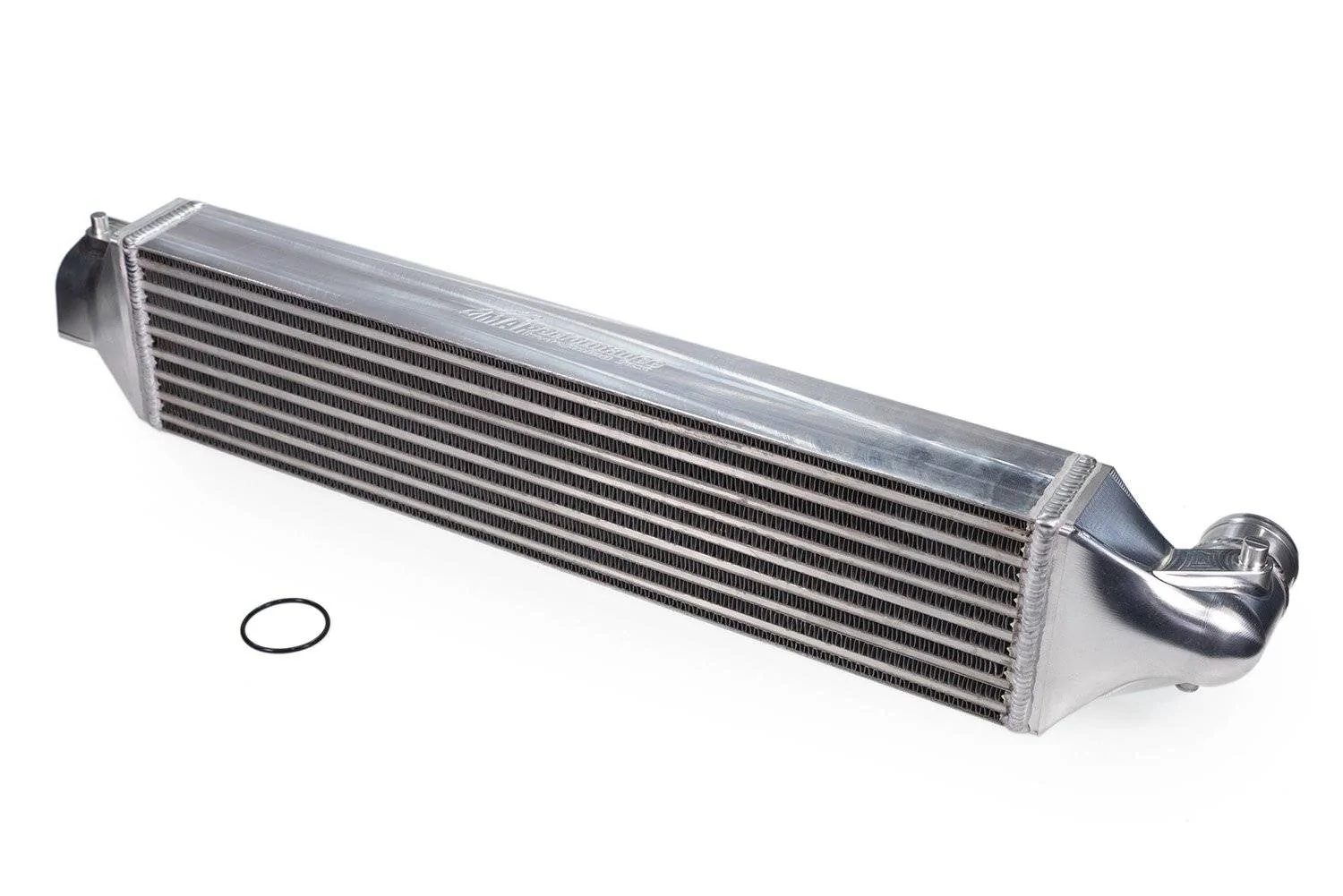

Obviously, it's been a few months since we last posted up about our Civic progress. There is a lot of ground to cover, as we have done a lot of development both towards the end of racing our car AND with the intent of either developing or improving products for the platform. To keep the continuity of this thread on track, I will try to keep updates in line with anything we did to our car prepare it for the 2019 race season.
When this build thread left off, we had extracted some pretty impressive results with the addition of our downpipe, and intake, netting 30.77 peak HP and a whopping 71.82 peak torque. Obviously, we had to replace the clutch well before stage 2 was even completed and this is where we sat almost a year ago... namely, a fun, enjoyable daily cruiser with all of the amenities of a modern car, but more of the torque and HP we would expect from a modern turbocharged car with obviously sporty heritage.
It was around that time when we decided we wanted to get the car to the track and try our hand at drag racing this car. Our next series of concerns revolved around air flow... we knew we needed more turbo and we knew we needed the charge air to be cooler more efficiently so we started with the intercooler.
Design objectives were as follows:
  • Core size and fitment appropriate for a wide range of turbo sizes to accommodate a lot of CFM variation
  • Our own billet end take design
  • Completely compatible with stock/OEM piping connection locations
  • Excellent performance and durability
As we are not strangers to building intercoolers, we actually have custom intercooler cores produced for us, to our specification. This particularly intercooler core was selected for size and performance capability as we had previously used and tested it on another platform with great success. The core is not so big is to promote unnecessary pressure drop but it can support an estimated 450WHP.
11th Gen Honda Civic MAPerformance Project SI Build Thread Extravaganza! DSC_7504

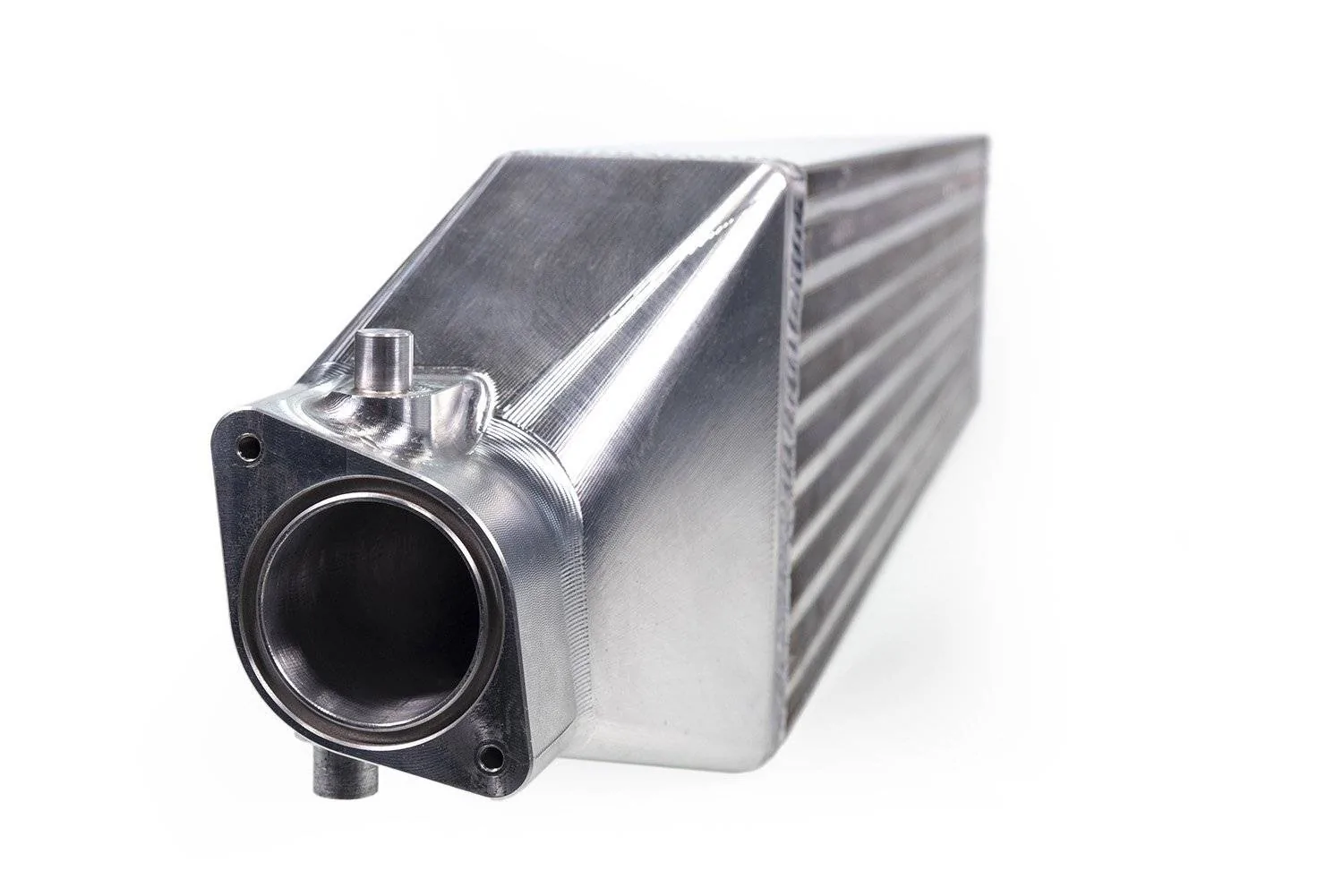

Next, we took to designing the end tanks. Our end tanks are actually designed and machined in house here at our facility in Cottage Grove, MN. These end tanks are machined from billet aluminum and carefully tig welded by our master fabricators before being polished and packaged for delivery.
11th Gen Honda Civic MAPerformance Project SI Build Thread Extravaganza! DSC_7505
11th Gen Honda Civic MAPerformance Project SI Build Thread Extravaganza! DSC_7506
This particular intercooler design is the same intercooler that powered our Honda during our 2018 drag racing season. Please feel free to comment... ask questions or let me know if you have any feedback! These will be ready to ship very shortly but please, keep checking back for more updates as we have a lot of new parts and information to share!

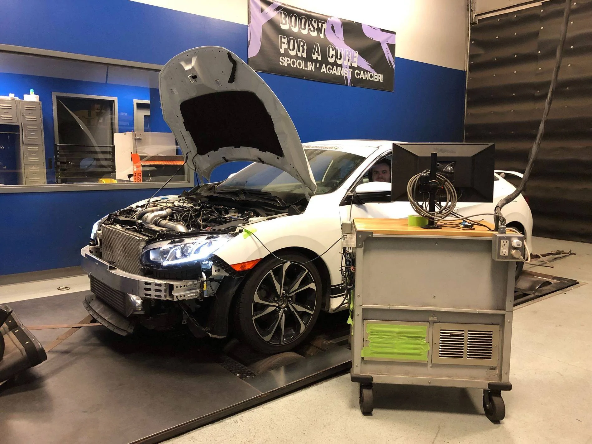

I have some exciting updates for you as we continue our world record ET and horsepower chase. While we haven’t made it to the track, yet, I am excited to announce that we have beat and currently hold the world record for the highest horsepower 10th gen 1.5t powered Honda Civic. Our car holds this record on the stock bottom end, tuned on the stock ECU and is running fuel available at our local gas station. Stay tuned for a demonstration and the final numbers… but before we give away all the secrets, let’s get you caught up on how we got where we are right now.
11th Gen Honda Civic MAPerformance Project SI Build Thread Extravaganza! Image_from_iOS_18

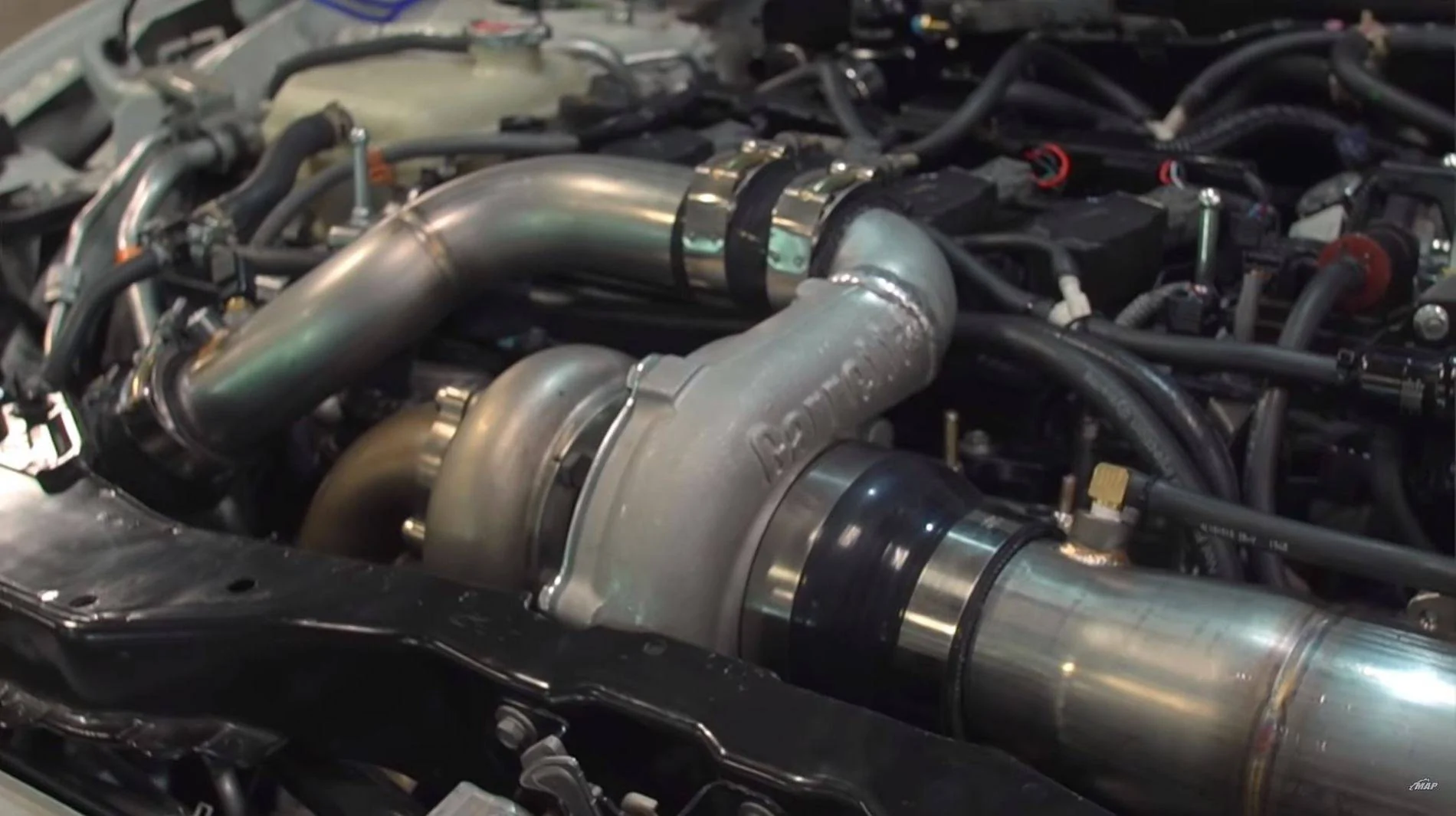

When we left you, last time, we were putting the finishing touches of the turbo kit together, installing and setting up the suspension and brakes and making accommodations for the Belak wheels and tires.
11th Gen Honda Civic MAPerformance Project SI Build Thread Extravaganza! turbo_kit
Over the last couple of weeks, we have been hustling hard, to put the finishing touches on our prototype turbo kit. Currently, our car is set up with a Garrett Gen2 GTX3071R which we intend to use to really push the power expectations of the platform as high as we can with the amount of room this engine bay has to offer and as you can probably tell, we have everything really show horned under the hood, utilizing every available amount of space we can as efficiently as we can. As we mentioned in our last video, we want to be able to offer a wide variety of turbo sizing options to suit our customer’s needs… this turbo is probably a bit on the large side, in terms of lagginess, but development for this size allows us to easily work back towards the smaller size Garrett turbos to present our customers with a powerful combination of performance and minimal lag.

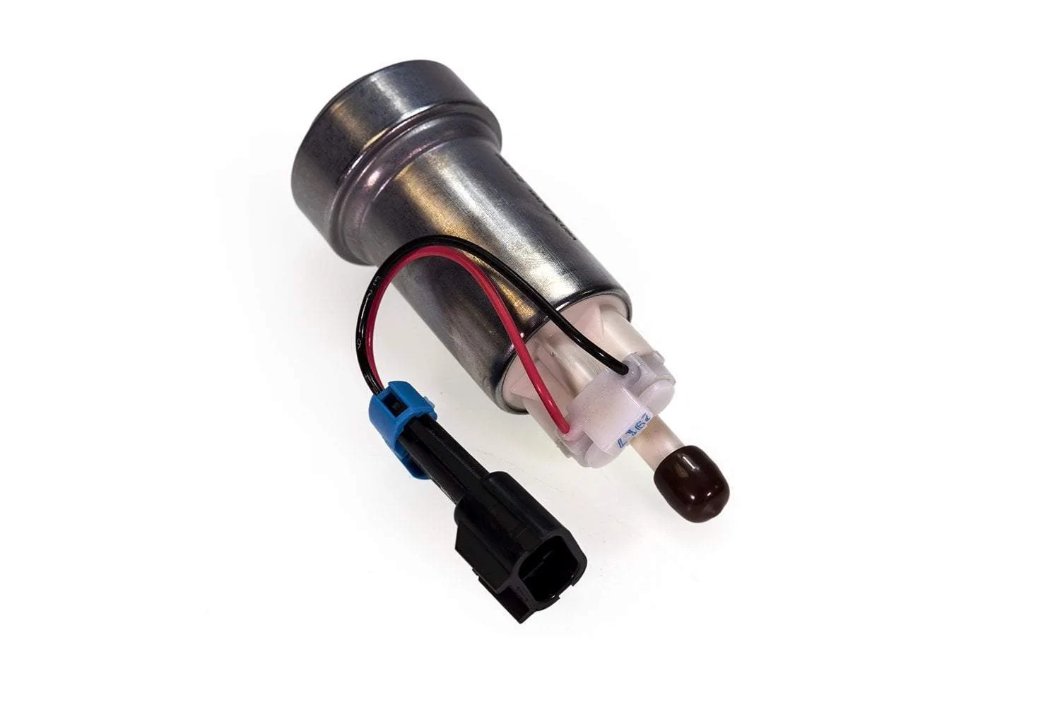

To anyone that asks that question… make sure to give yourself a gold star. Since day one, this platform’s small 1.5 turbo charged engine has been proven as a surprisingly power hungry engine that has been full of surprises, but when it comes to making anything over 400HP to the wheels, the fuel system has proven, even in the most capable of hands, to have been the biggest obstacle to overcome. I’m proud to say, the days of being held back are over and I would like to talk about how we were able to overcome our fueling issues.
11th Gen Honda Civic MAPerformance Project SI Build Thread Extravaganza! walbro_525_36bebd17-23e1-416b-b453-78ac2520f1bd
Step one… add more lift pump. We went to the drawing board to develop a simple to install low pressure fuel pump solution intended to be easy to install for casual enthusiasts with minimal tools. Using a high pressure, high flow Walbro 450 LPH pump, we were able to substantially increase the fuel flow through the fuel system to allow for additional injectors without worry about the direct injectors starving for fuel.

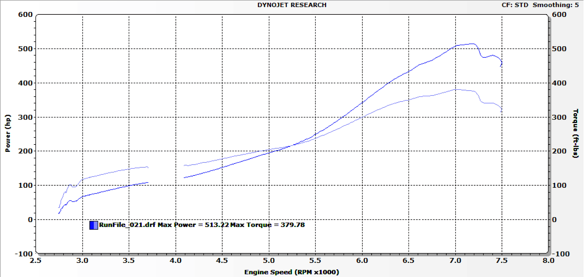

So now that you know a little bit about the car, let’s take a look at what it can do on the dyno...and for everyone that might want to ask… our Dyno is an industry standard Dynojet 424x which is basically two state of the art 224x’s paired together and are capable of measuring 1500 plus all wheel horsepower. The outdoor temperature is 87 degrees with 33% humidity. Let’s see what we are able to get out of this little screamer.
11th Gen Honda Civic MAPerformance Project SI Build Thread Extravaganza! Screen_Shot_2019-05-31_at_8.12.22_PM
There you have it. 513 peak HP to the wheels with 379 ft lbs of torque! WOW… let’s hope that is enough! Once again… this is a stock bottom end vehicle(Meaning stock pistons, stock rods, stock block, stock crank, an unopened stock shortblock), running fuel available from the local gas station(Roughly E60 at the time of this video), running a stock ECU making that power. Now there is a supplemental controller that is required to operate the injectors, to be completely fair, but the stock ECU is really running the majority of the show.
